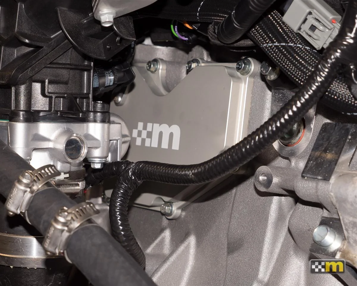

There is a factory air-oil separator as part of the PCV oil breather plate on the engine block, behind the throttle body. There is an add-on for the block breather as well, but its made for the Mustang and is the same thing with different hoses: https://performanceparts.ford.com/part/M-6766-A23

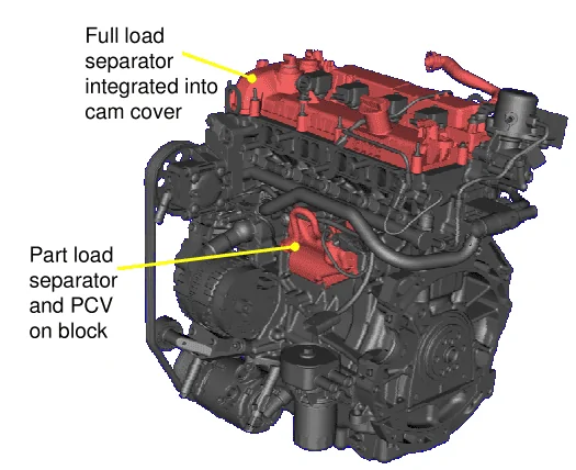

Here is a Ford PCV diagram, note how both have built-in separators. Part-load is likely normal driving (vacuum), while full-load would be hard driving (boost):

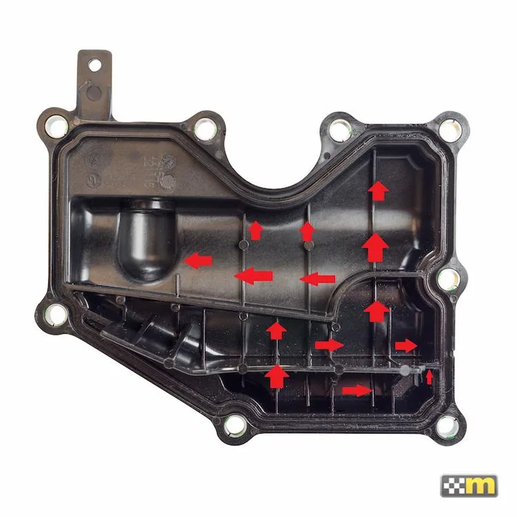

From Monotune:

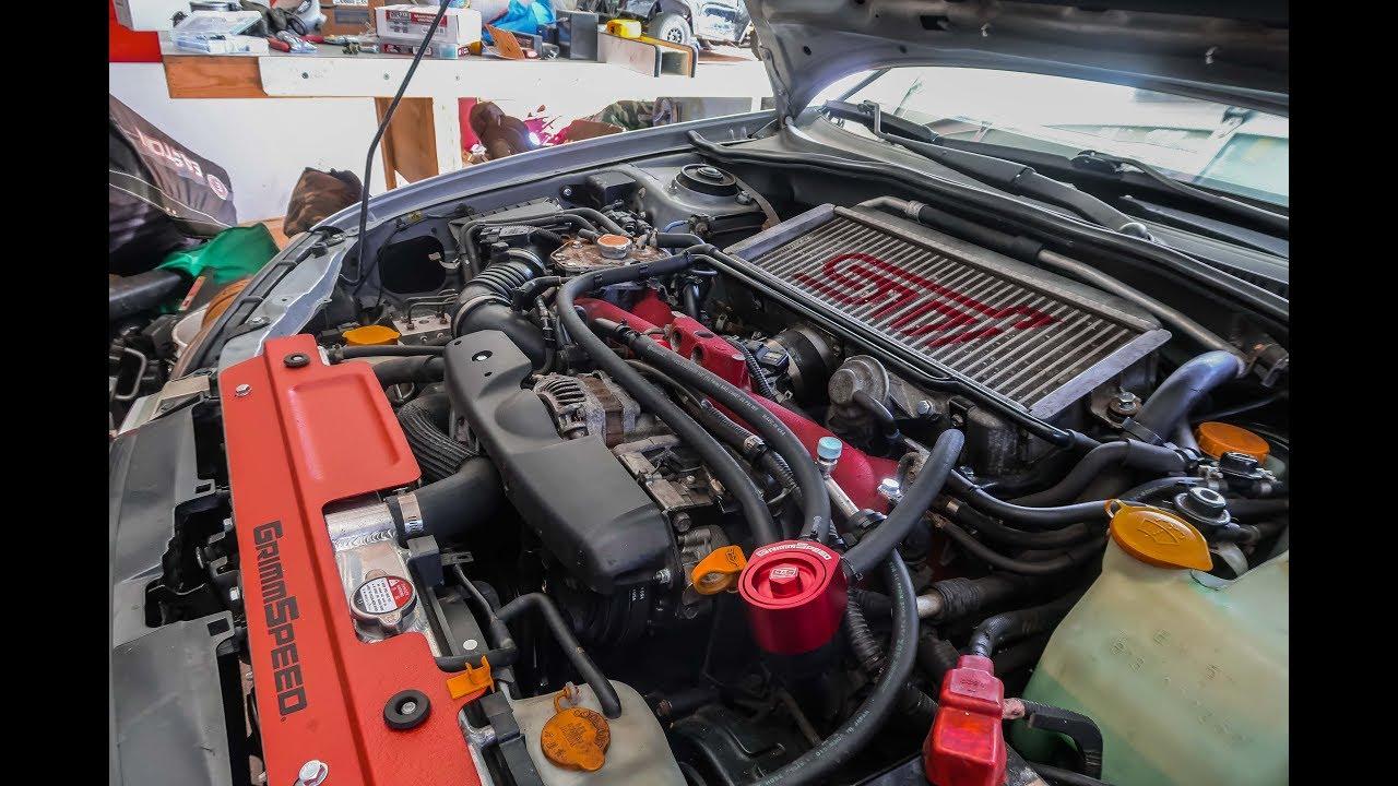

Here is a pic from IAG's website, it sure looks like a catch can...I'd prefer something like a Grimmspeed AOS, which is basically no fuss.
From Monotune:
From Monotune:
