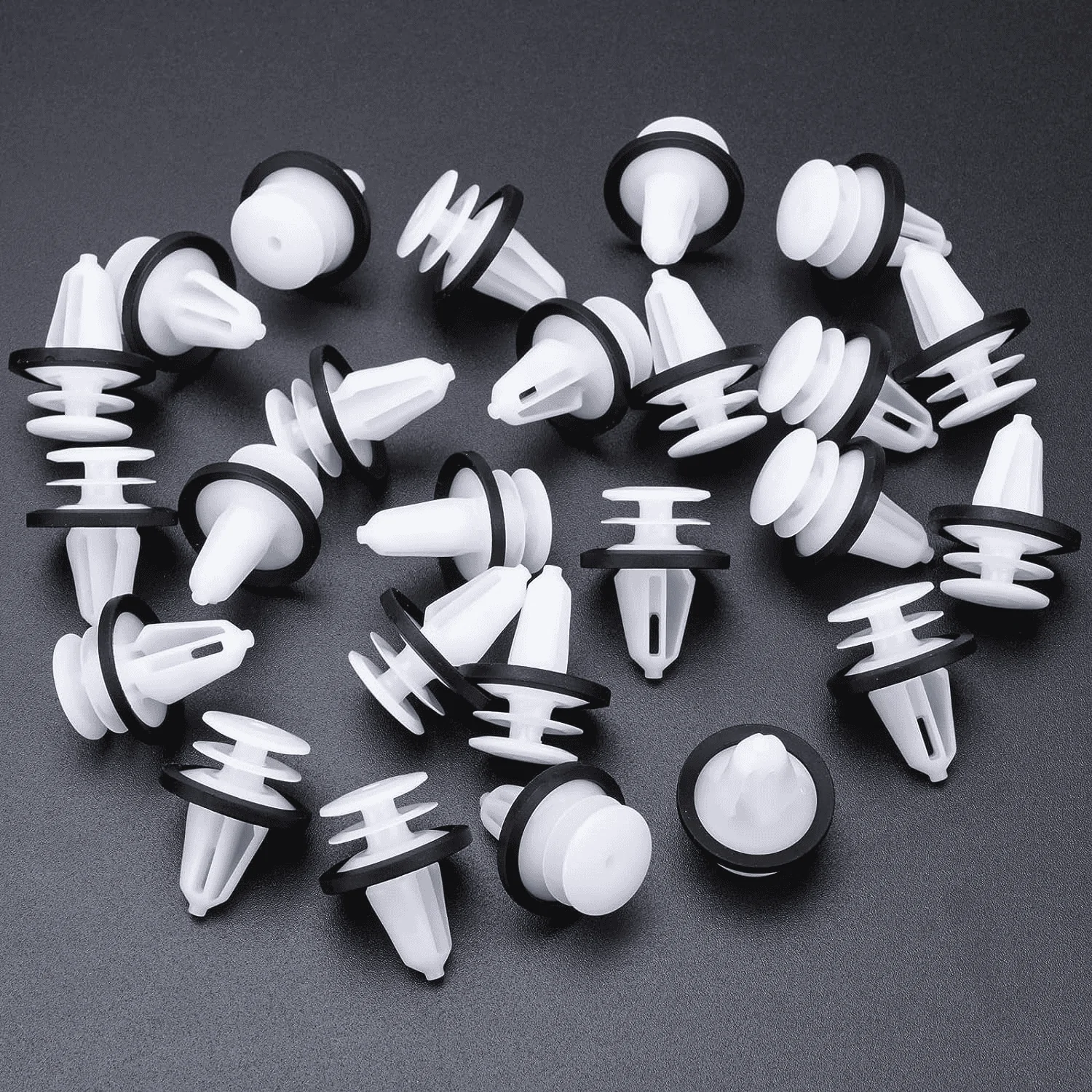

Side question for you since you work at the dealership. Are the tree clips (W722128-s300) available through the parts counter at your dealership? I’m not finding them online. Broke a couple on my Bronco taking out the factory dummy sub box.
Any dealership can order them. They were on backorder last time I looked though.
I was told back ordered till late August.
