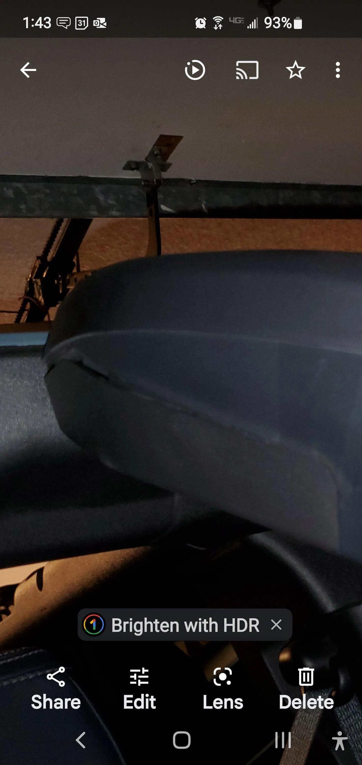

Brought my 23 in for another repair and they checked the subwoofer rattle. Came back with TSB 23-2241 for the rattle. I searched on here and online but don't see it mentioned anywhere so I thought I would pass this along since many have posted about it. Parts are on backorder.
Thanks Ducati1098 for the screen shots.
Anybody else have separation on rear speaker housing? I've got gorilla tape holding my speaker housing together on a first edition bronco with 13k miles on it. 😂

Got to love it when there is such a simple fix to an annoying problem, thanks for posting!
