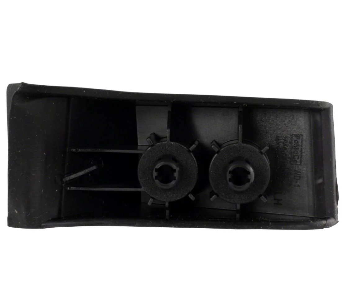

Do you know how those pieces in your top picture are attached. I don't see any screws in them? They also move around AND make a rattle!@!!!!!!!
Ducati1098
9,976
23,178
Midwest
They’re just clipped in. Here’s a picture of the bottom of it. You can see a few small foam seals that should prevent noise, but that may not be adequate, or they may be missing 🤷‍♂️
