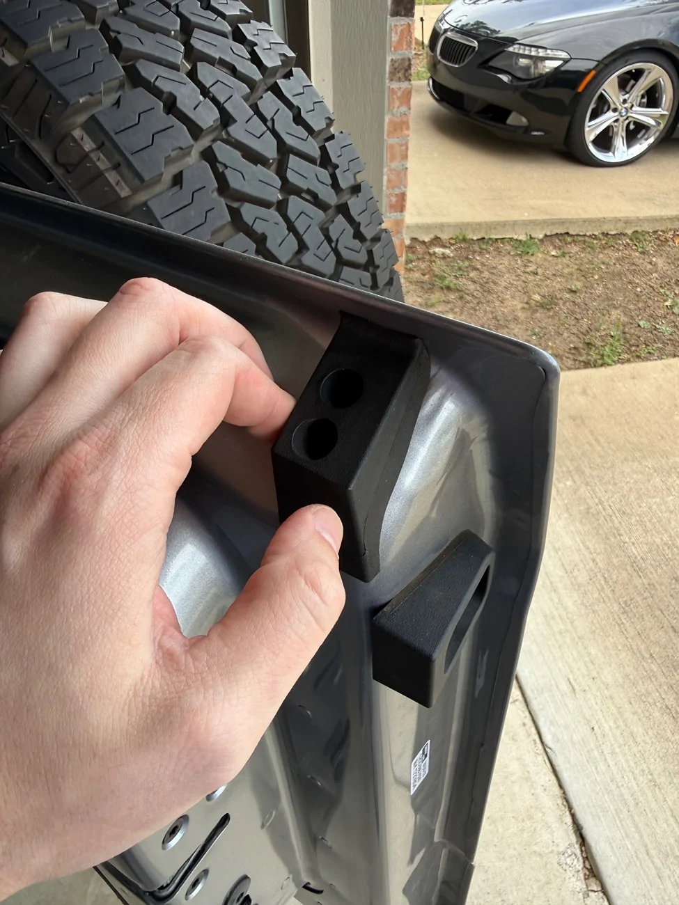

After disassembling the entire rear cargo area piece by piece to isolate the noise, I finally decided to remove the spare and spare tire carrier to see if this TSB could be at play. Wouldn't you know it, the tick/rattle was gone. I ordered the TOR tire carrier reinforcement kit. I'm keeping my fingers crossed that this solves the issue.

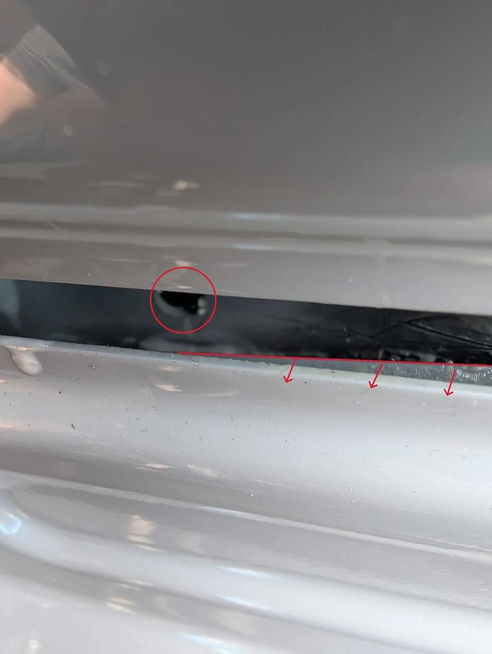

While investigating, I also applied white lithium grease for the second time. I noticed something that looked a bit odd inside the bottom left opening of the tailgate. See the pic below. Does anyone know if this hole is normal? I also can't tell if part of the tailgate/hinge is bent inwards. This would be in the opposite direction of the weight of the spare though...

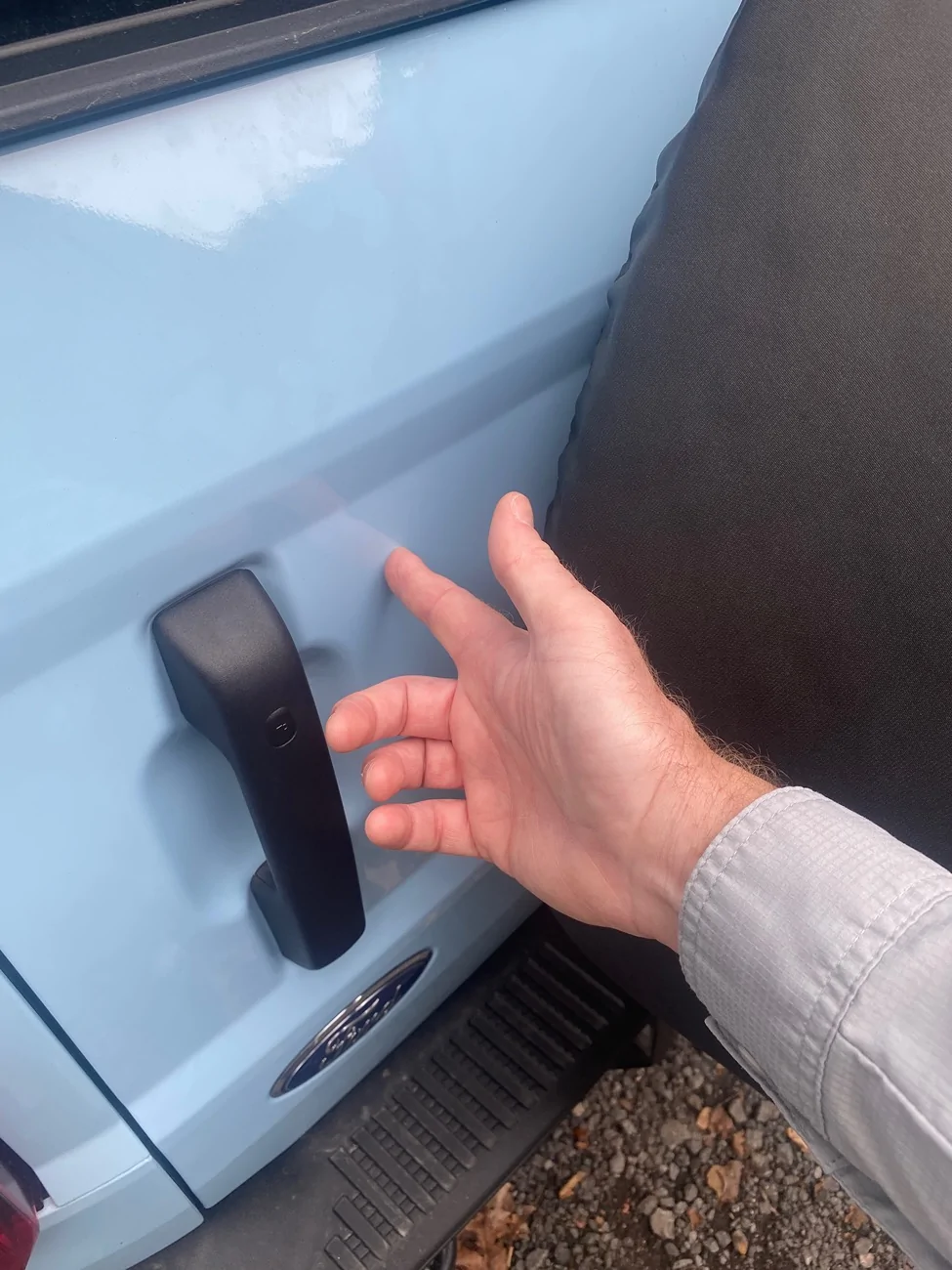

So I have had a tailgate tick develop recently on my ‘25 HE. Originally just on the rough gravel road up to my house. Now every bump on the road. I discovered I could recreate a tick sound by pressing my fingers here on the outside of the tailgate:

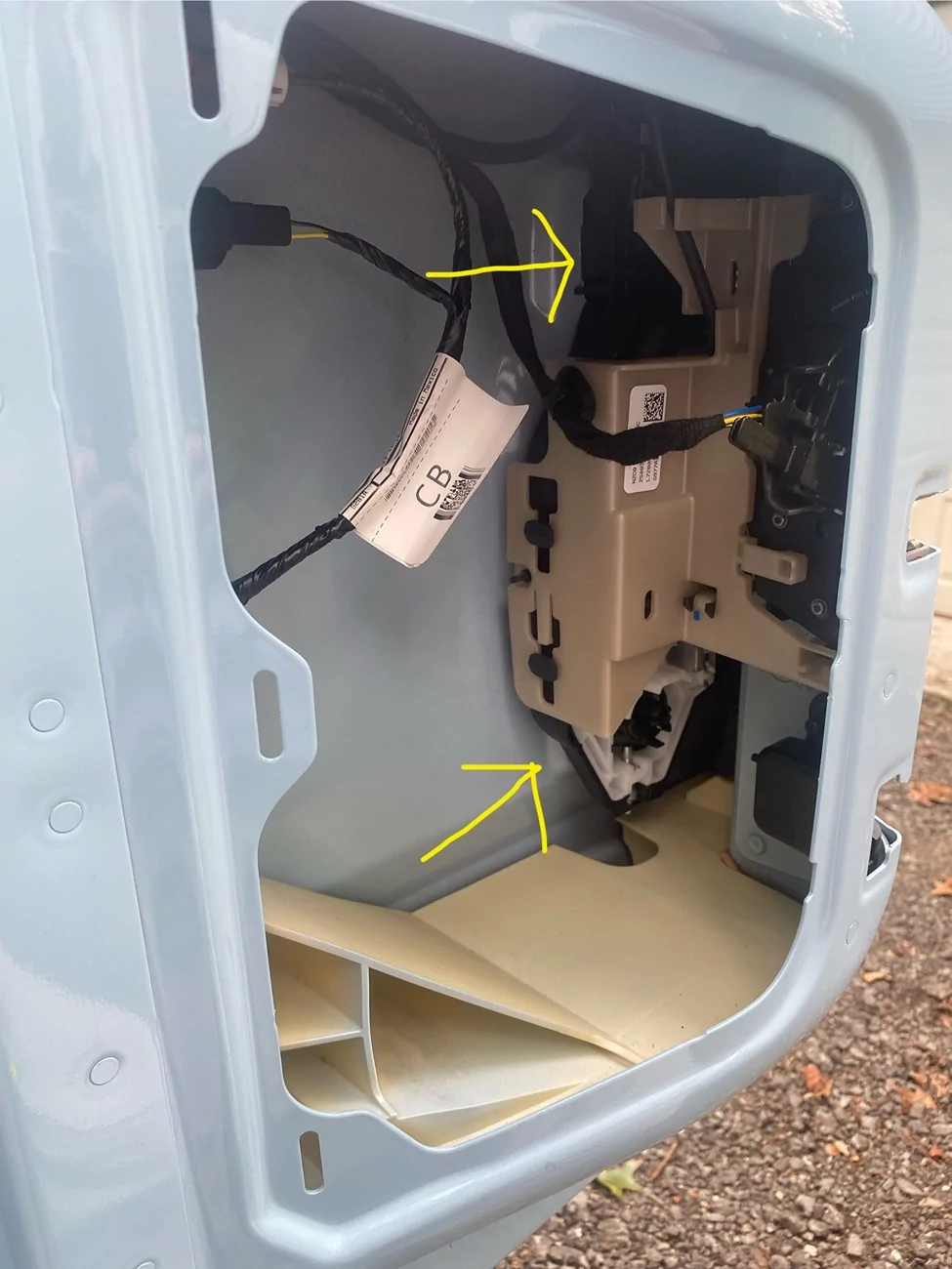

So I popped off the tailgate latch panel and isolated it to the large black plastic piece indicated by the yellow arrows:
Ford Bronco Tailgate Rattle / Tick Issue Fix -- TSB 23-2163 IMG_3382

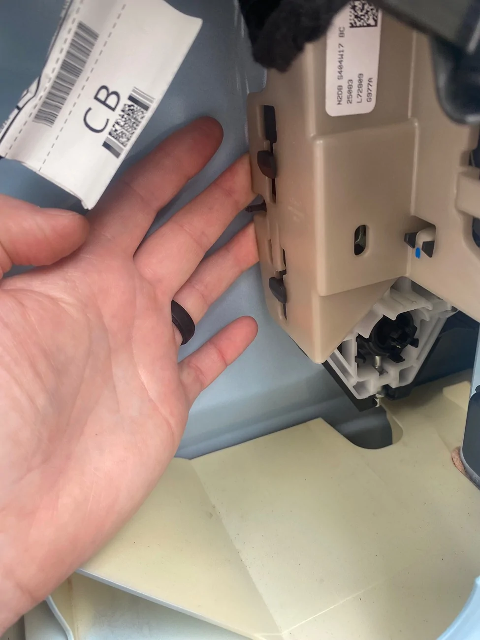

The black piece is clipped to the tan one, and by placing fingers between the tan piece and tailgate metal as a spacer, the piece no longer clicks when the tailgate is pressed from outside.
Ford Bronco Tailgate Rattle / Tick Issue Fix -- TSB 23-2163 IMG_3387
So before I go crazy with white lithium grease, I’m going to try a foam spacer where my fingers are here. Will report back later today.

Welp, shit. That wasn’t it. I wedged some foam pipe insulation in there snugly and the tailgate still clicked/ticked. Back to the drawing board…

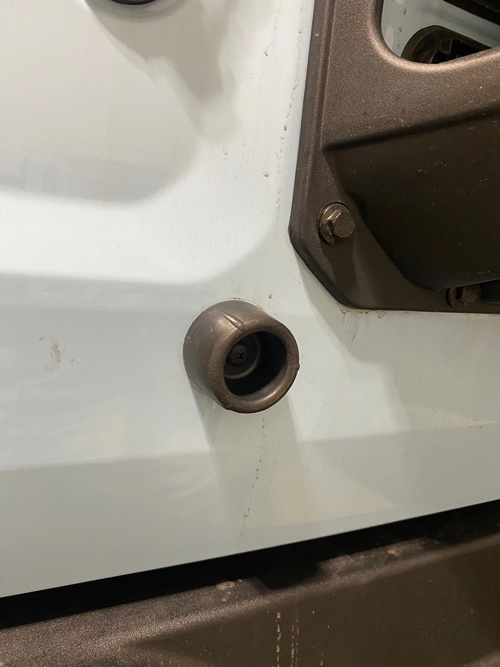

Spare just came off so I can test without the weight. I noticed the lower tire bumpers are held in place with some kinda plastic grommet with a center screw that can’t really be securely tightened. And both bumpers click when I move them, especially the left side. The list of suspects is growing. Will update after test drive without spare…

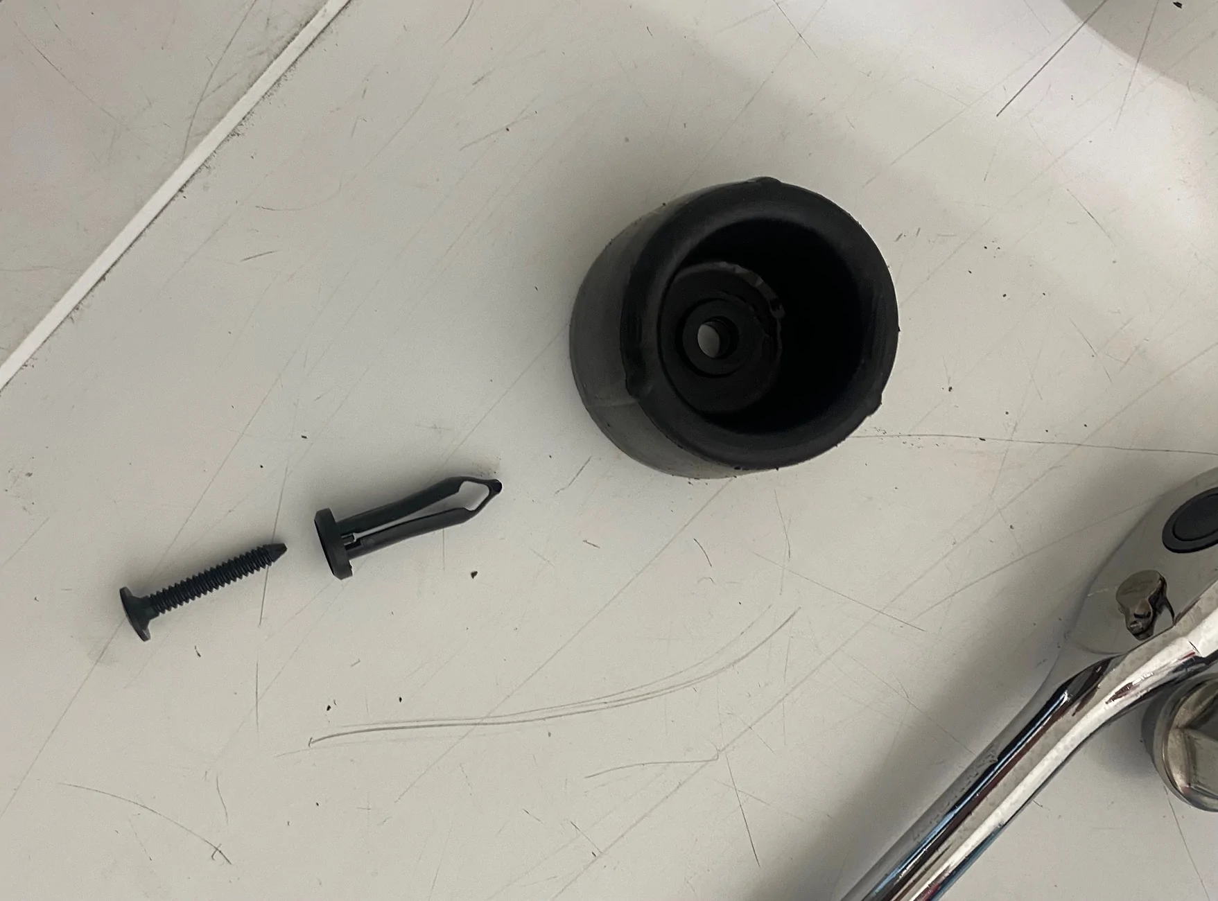

Ford Bronco Tailgate Rattle / Tick Issue Fix -- TSB 23-2163 IMG_3392
Update #2. Removed spare bumpers, cleaned and sprayed inside and back with silicon, reinstalled, remounted spare at 41 ft-lbs. Test drove and the click is back, same as before. Wasted half my day on this with no results.

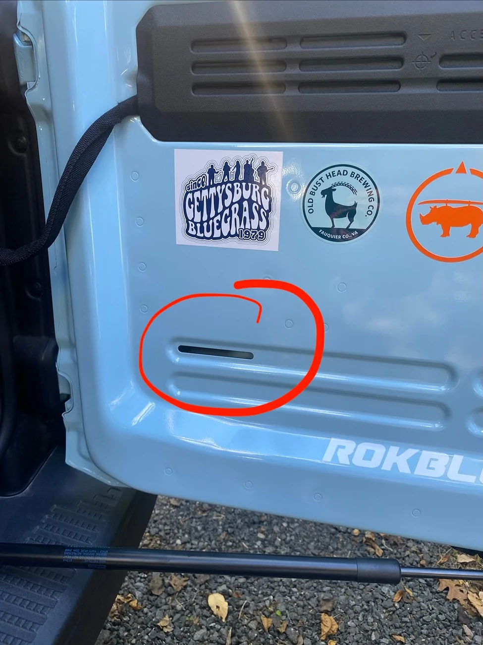

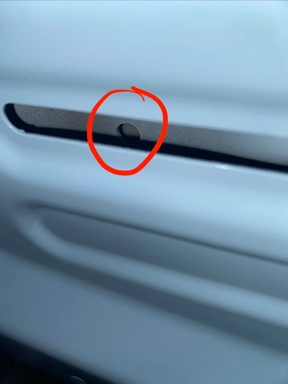

SUCCESS!! My tailgate ticking was at it’s worst this morning and is now silent for the time being.
I had my wife yank down on the spare a few times so I could isolate the tick sound and it’s 100% from the lower hinge area, but not external. So I decided to target just that area inside the tailgate with white lithium WD-40.
I didn’t want to go nuclear because white lithium doesn’t play well with some plastics and I don’t know what all is inside the tailgate that I can’t see. So I stuck the straw through the lower left slot on the inside of the gate and then through the little hole beyond that. I blasted the general area spanning from one hinge bolt to the next, or where I estimated them to be: basically down and left from that hole. Two blasts across there about 1 second each. I pulled the drain plugs out of the bottom of the tailgate and no drainage after 10 minutes, so it’s not drenched in there.
After spraying I drove it down and back up my bumpy gravel road and NOT A PEEP. Blissfully silent for now. If it returns later, I’ll hit it again. Now that I know how and where to handle it, I’m going to be far less annoyed on my upcoming roadtrip.
There is a piece of air filter stuff that’s directly over the vents that are behind the spare tire, and the wire harness that you can see externally running across to the left hand side for the lock/CHMBL/camera.
Other than that - nothing but some internal aluminum cross bracing and the nut plates for the hinges and spare carrier
