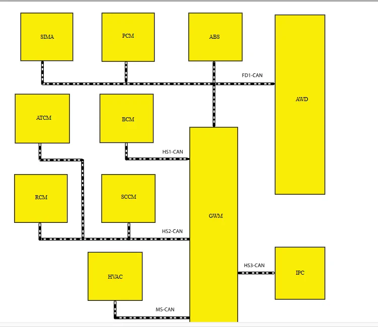

Four-Wheel Drive Systems - System Operation and Component Description
System Diagram
System Operation
Four-Wheel Drive
The 4WD (four wheel drive) systems consists of:
  • Transfer case
  • Driveshafts
  • Front axle
  • Rear axle
  • AWD module
  • ATCM
The transfer case has five modes of operation:
  • 2H - Two-wheel drive high
  • 4A – Four-wheel drive auto
  • 4H - Four-wheel drive high
  • 4L - Four-wheel drive low
  • Neutral – For recreational flat towing
(2H) OPERATION
When the ATCM is in (2H), power is delivered to the rear wheels only. This mode is appropriate for normal on-road driving on dry pavement and provides the best fuel economy. Torque is passed through the transfer case to the rear driveshaft at a 1:1 ratio. In (2H):
  • The ATCM sends a (2H) mode status to the AWD module via the GWM .

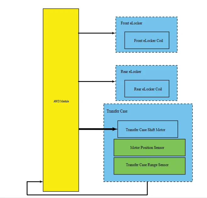

All Terrain Control Module (ATCM)
The ATCM contains the G.O.A.T. modes rotary dial, 2H, 4H, and 4L switches. The ATCM is the logic module for the front and rear ELD , the stabilizer bar disconnect, and all G.O.A.T. mode features.
AWD module
The AWD module is the logic module for the four-wheel drive system. Multiple modules/system inputs are used for the four-wheel drive system to determine the percentage of torque to be transferred to the front wheels.
Transfer Case
A supplementary gearbox attached to the transmission. The transfer case directs power to the front drive axle via the front drive shaft.
Refer to: Transfer Case (307-07D Transfer Case - Advanced 4x4 with 4A Mode, Description and Operation).
