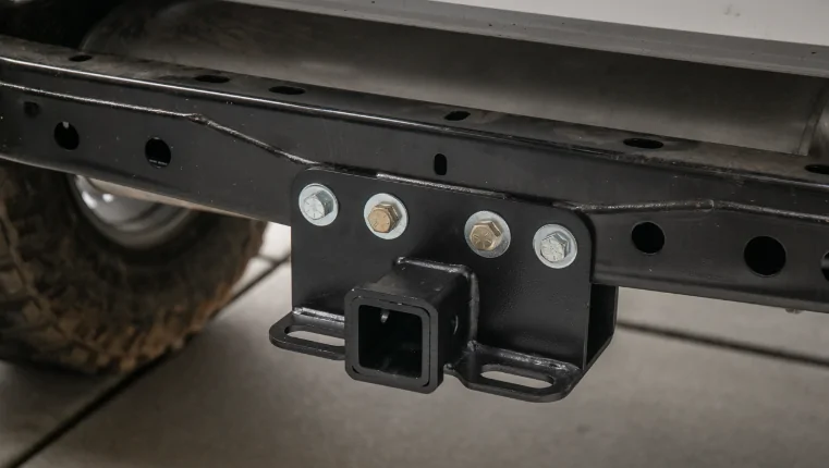

I would never use a Bronco hitch as a recovery point. It mounts to a cross beam that is full of holes. This is the main reason the tow capacity is so low. Hitches on other vehicles mount to the stronger side rails.
