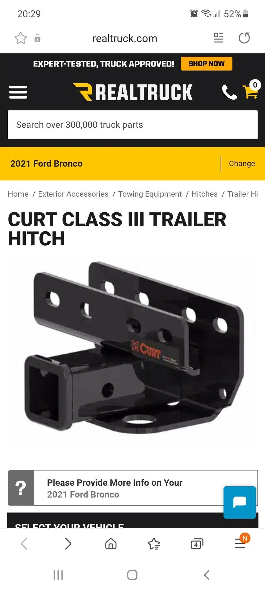

If you go to Curt or Draw-Tite’s websites, neither show a product available so I guess Curt doesn’t have their own website current?
It changes once you select all beds for the bed type.
