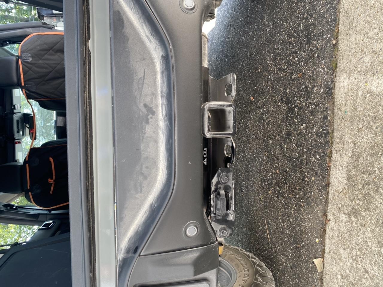

I ordered one. $111 and free shipping not going to be matched by any Ford OEM hitch. I've had Curt hitches on my Outback and 2 minivans. Always been nice and stealthy. Made in USA as opposed to Macedonia (see on pics in post #1). Only thing it looks like you are giving up is the built in bracket to hold the 4/7 pin connectors. If we're not going OEM on those they usually come with little brackets.
My preference is just to leave the connectors on long wires and leave them under the cargo floor by the jack, run them out and close the tailgate on them for my once in a blue moon trailer rental. I mostly need the receiver for the bike rack.
Shipping estimate could arrive as early as 8/26. I'll be back with pics.

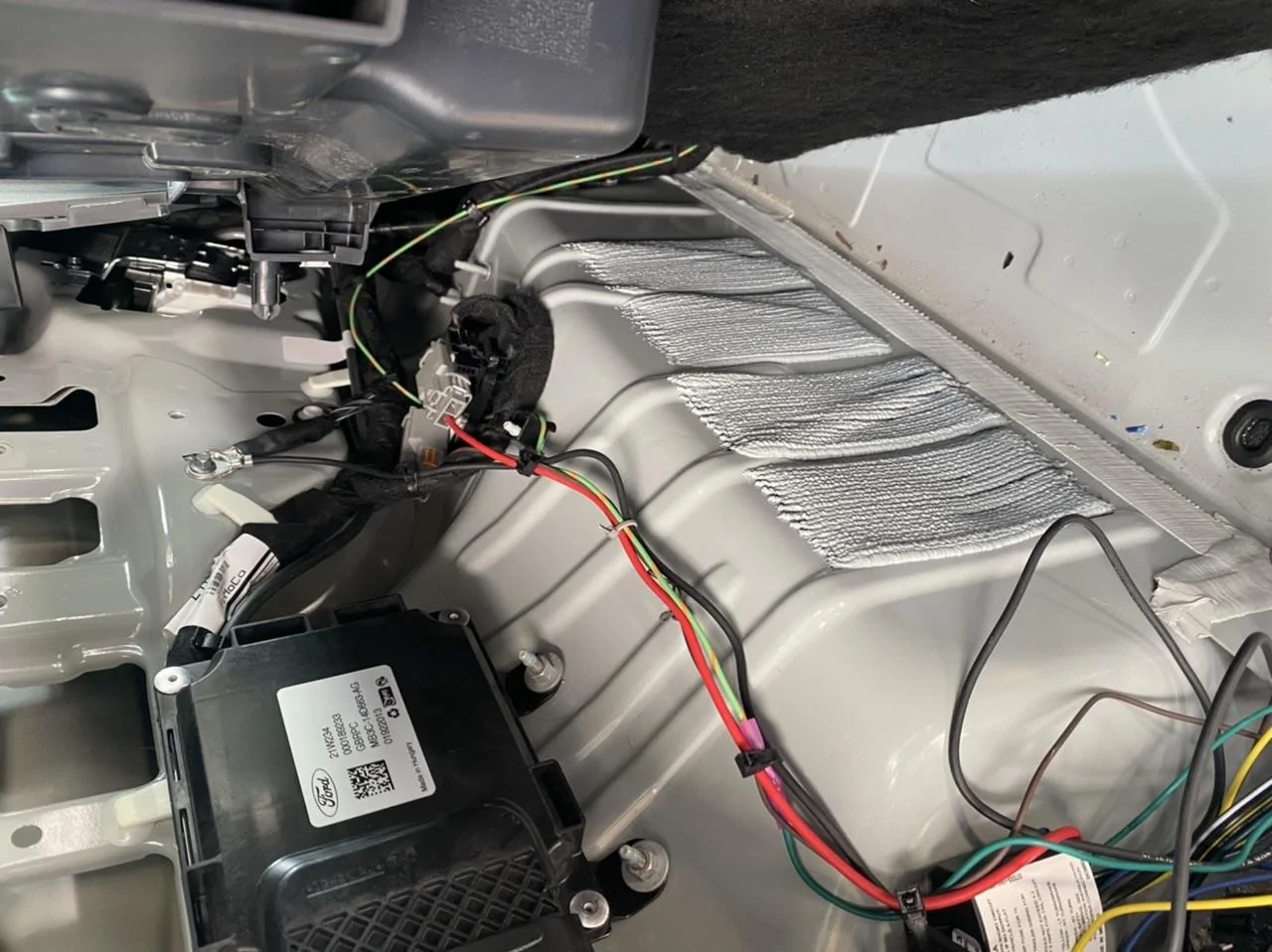

To be fair the OEM TT module/computer is made in Macedonia. I can’t prove it but Ford most likely gets the hitch from Curt ot Reese and restamps it. I have a link to the light module somewhere. I’ll try to post next week. Less expensive than Fords but backordered last time I checked. Does the Curt hitch come with the bolts and mount plate for the 4 or 7 pin plugs?

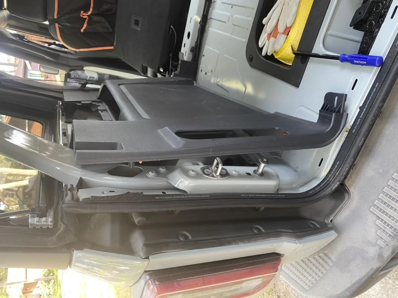

Complete now with Flips help and harness (made it easier for sure). Total cost with a few panel tools was under $400. Mostly paid for with FordPass points. Trim panels and taillight removal was a PIA. Wiring didn’t follow the Ford instructions for LR turn signal, otherwise good to go. 3 hrs is a safe time to allow for someone with average skills(I am average at best).

Go slow, buy a few of the panel fasteners to replace what breaks, watch the LH turn signal you tap, mine didn’t match the factory instructions and per Flip, there are 4 alternatives for the #4 position in the left side plug. The taillight was really tough to remove, not know how it was put in, I can’t even explain what I did, but it came out eventually.

Big thing on the tail light is the little white push pins. Have to compress the "wings" in order to get them to release. They aren't like the other "Christmas tree" or metal spring clips they use everywhere else. We ended up using a set of 90 degree long needle nose to reach them but there are other ways to do it.
