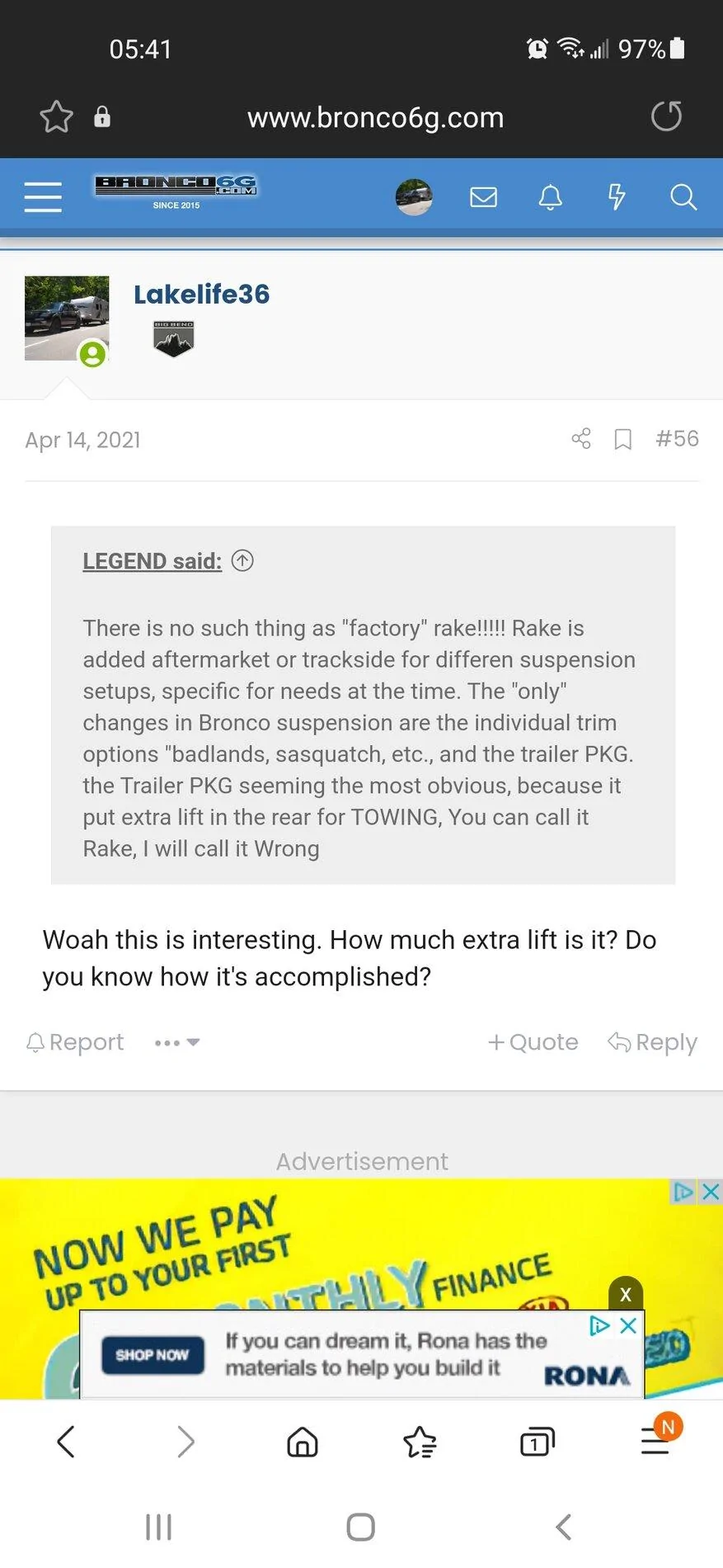

I specifically asked him for more information and got diddly in response.
Edit: photo so it did happen
Whoa that's news to me. So now we have another variable to add when measuring suspension on roadshow Broncos.
You need to pay attention. It has been mentioned (albeit dropped in threads that may be overlooked). Legend dropped that info back in February. I tried to convey it to others. People read what they want. I'm done convincing others how to spend their money.
