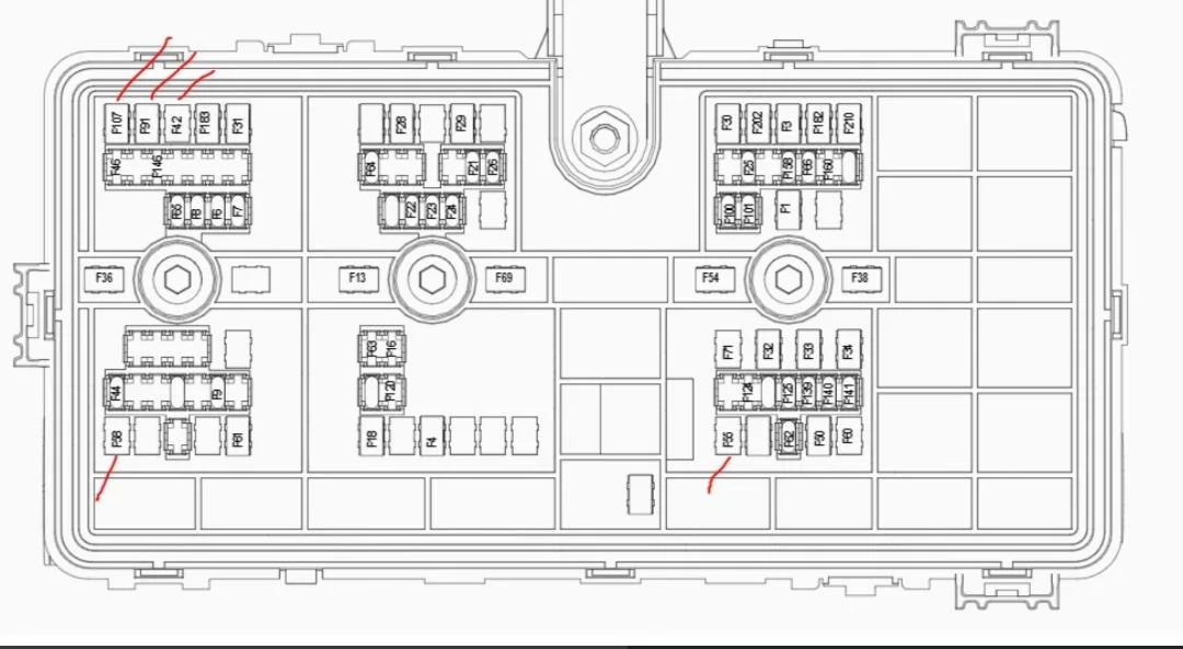

Looks like my turn signals are the only thing that are not currently working after the install. Anyone else have a similar issue? I have the MY23 Bronco that comes with the updated connector and pinout.
Do your hazard flashers work, all 4 corner lights blink?

Did you check fuses?
You need to turn them on with forscan or ford dealer there is a bunch of setting to enable. I made this exact settup with your help flip ording the pins. All fuses should be in place.
I was wondering if something might have popped one during the install. Didn't read all of the install instructions yet, damn the ADD.
Yes it doesn't hurt to check, but yeah I didn't have lights until I enabled with forscan. I just went through all modules and turned anything to do with trailers on.
I have forscan, enabled everything per the forum thread. I also checked the 5 fuses you recommended and none are blown.
When I get home I can get a list together what slots you need to terminate. I think all my wires beside reverse went to c201 behind the fender. Pins 15,16,17,18,19 if I remember correctly.

Appreciate the help. MY23 has a different connector with 12 total pins and different pin locations for the OEM wiring harness. Shown below as Pins 7, 8, 9, 10 and 12. I verified again that they are in the right slots.
