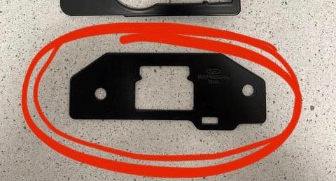

Did anyone here install the Ford hitch kit MB3Z-19D520 and does not need the included mounting plate for the 4-pin harness because they installed a 7/4-pin harness? I am interested in buying one.
I was following this thread and planning to make similar modification, then I decided all I needed was a 4-pin and no trailer brakes. But my dealer sold me just the hitch (MB3Z-17D826) that doesn’t include the 4-pin mounting plate. And apparently the 4-pin plate is not available by itself.
I can look and see if I saved mine tomorrow night.

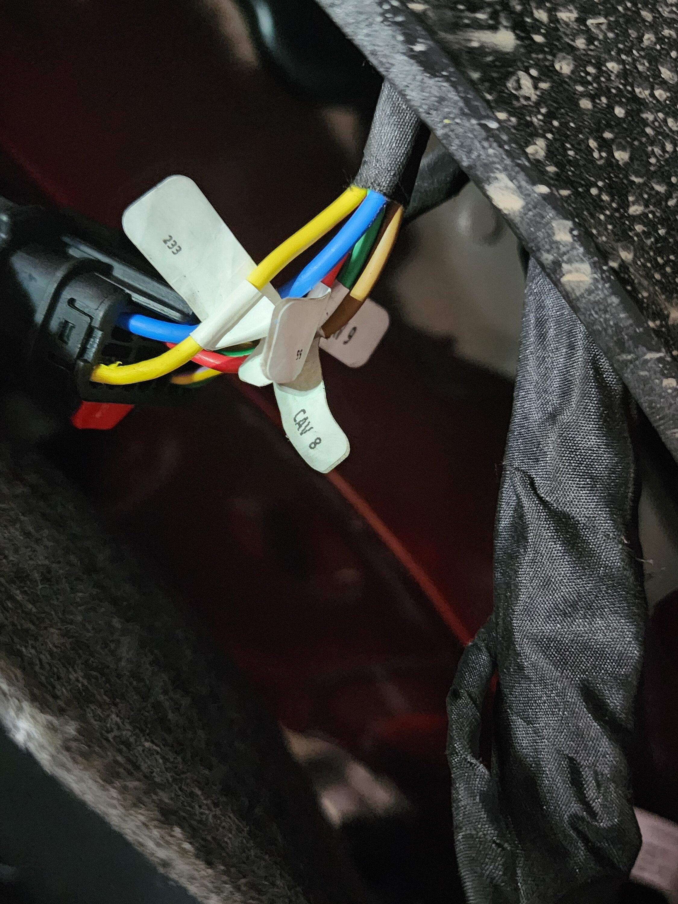

Appreciate the help. MY23 has a different connector with 12 total pins and different pin locations for the OEM wiring harness. Shown below as Pins 7, 8, 9, 10 and 12. I verified again that they are in the right slots.
I also have a 2023 and will be tackling this shortly. Did you ever get this working. I found some forscan instructions from the other DIY thread.
Also did you find a diagram for the connector or did you just attempt to match the colors to the other end of the connector? Want to make sure I get the pins right.
Thanks for any help!

They provide two sets of wire labels, one for each connector type. I also did not do the forscan as built changes as they messed with the 2.3L MT settings and I had to reset them. I only enabled the text description items and now everything works great including the brake controller.
I'm assuming then the extra wires are for the older (pre 22) connectors?

Installation of the wiring harness, however, was a tad complicated. The instructions provided are predominantly visual, making it somewhat tricky to determine the precise point of view. Moreover, the wiring harness modification behind the driver-side front fenderwell featured a different harness than the one depicted in the instructions. This necessitated me to guess the pin configuration as it didn't align with the instructions (for instance, I placed the blue wire in pin 7, instead of pin 19 as directed). Regardless, the installation is now complete and all that's left is some Ford programming to enable everything.
Did you find one of these brackets? I have one I can mail.
