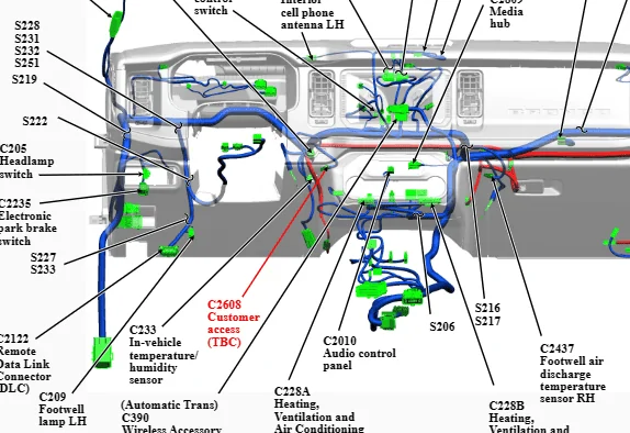

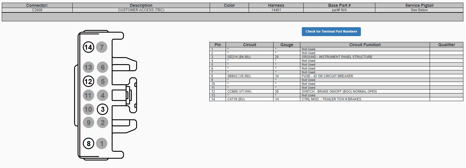

Some awesome info here! I'm almost finished installing a 7 pin adapter with trailer brake controller. I just have the base Bronco, so install hasn't been super easy. Anyone happen to know the easiest way to access the brake switch signal wire for the controller?
flip
flip
Base Sponsor (Level 1)
Phil
4,834
16,026
IN
www.ruxerparts.com
Fords
I don't recall but is the harness not there behind the dash for a controller? It's a violet/white wire you can find in the C200 harness.
Thanks for the info! Wasn't sure if the base had a harness or not, but I will give it a look!

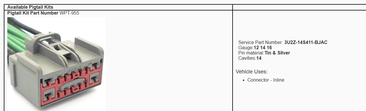

Yazaki 7114-4121-02 big
Yazaki 7114-4111-02 small
If you need a couple LMK.
