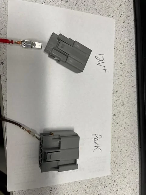

I can't find T-tap molex to go in between the two. If you want a 12V+ source the male side of the connector is on there from the factory. Should be 3 connectors on a tree pushed on one of the studs on the left wheel well. Either of the two pin connectors is hot and come from F107 (30A) or F91 (40A). If you are hooking up the converter, which ever one you use needs to be changed to a 15A fuse to protect the converter. The large blade for 12V+ is a Yazaki 7114-4121-02
Do you have LED or halogen tail lights? LED will require one brake light wire tapped, both turn signals tapped and if you want park lights, I was going to tap one of the connectors on that gang of three instead of tail light wiring (Yazaki 7114-4111-02). I have the terminals for making some of these up but want to make sure of the lengths needed so it doesn't turn into a rats nest.

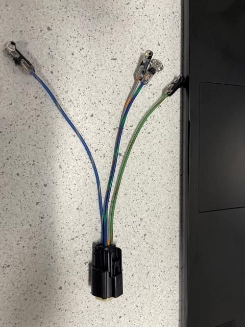

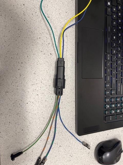

Plan is to use a Molex MX150 6 cavity male and female to connect the converter to a short pigtail with t-taps (scotch lock). The other side will be connected to the converter. I've got a tail on this one for reverse should I decide to hook it up. Need to add one that will run to the right light for turn.
I have LEDs. I want to be sure I am understanding your route. It sounds much easier and seems to use the TT connectors completely, rather than needing to do pigtails to the L/R tail light connectors. Am I reading that right? Or, do I still need to get the turn/brake/marker leads from the tail light harness with the 20 pin (WPT889)?

We are just going to use a t-tap scotch lock on the individual wires. Use the 12V+ and park light in the factory plug that would go to factory TT module. We pick up the left turn and stop signal on left harness at the 20 pin and run a wire to the right side to pick up that turn signal. Truth be told, the right signal can be picked up on the passenger side but would require the harness to be opened to find the wire. Not a big deal but a lot of people might not be comfortable doing this.
I’m up to my arse with work right now and the black bronco has been out on drives so I’m really crunched on time. I’m sending @Mattwings a box of stuff since he is ready to install. Hopefully that will help. There’s a dozen ways to do this from down and dirty to full invisible OE install. My plan is somewhere in the middle and doable by almost anyone. If this works well I can try to do some prewired converters but haven’t played with precise mounting locations, wire lengths or where to pass the plug through.
