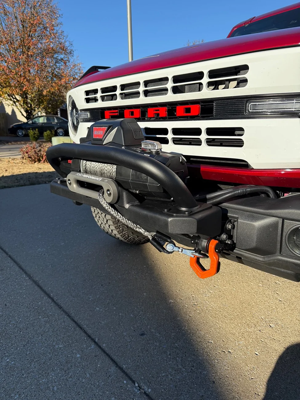

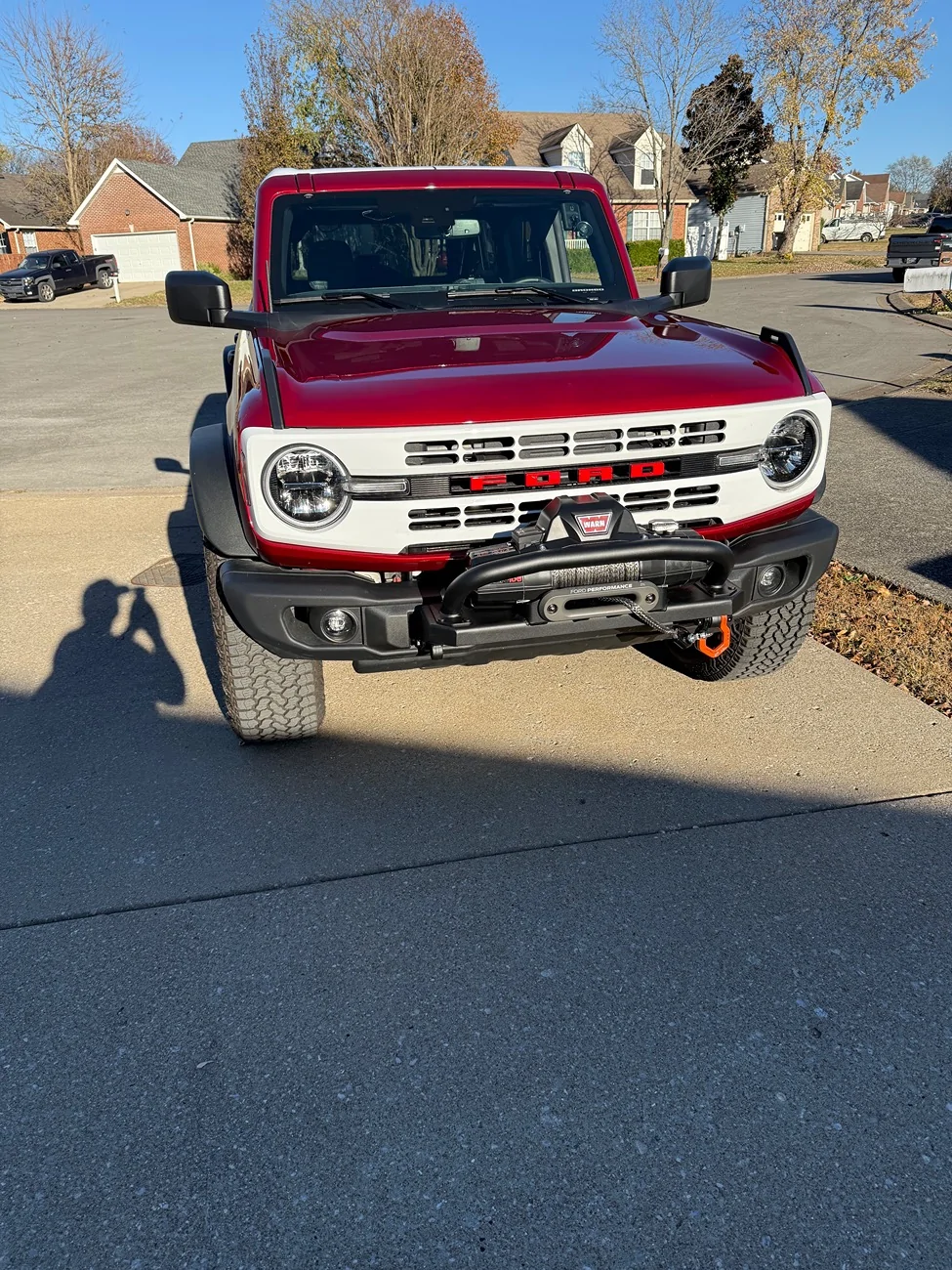

I bought my first Bronco in July (Heritage Edition): and I’ve made a few insignificant changes - grab bars, thumb screws for topper, floor mats - but I purchased the Ford Performance Warn winch kit and installed it today. I have the capable bumper and had to make some cuts to fit the brackets, but all things considered, it turned out fairly well. Took about 5 hours, and I’m pleased with the result. I don’t consider myself a mechanical person, so if I can do it, anybody could do it.
Ford Bronco Total Noob - Winch Install IMG_8071
Ford Bronco Total Noob - Winch Install IMG_8070

I notice the wire loom on those eliminated the white tape / banding that mine came with. I painted it as it was annoying to see the white band on the loom.
Nice job on install. If you're a noob to winch use, I highly recommend playing with it in a controlled environment. hook it up to a tree and pull the bronco. get used to how it works. pulleys, shackles, all the things.
Good advice there along with some recovery training. Additionally, @xxNomad74 you need to tension the synthetic line

Thanks for all the feedback. When i did the Off-Roadeo in Maryville, TN, they had a quick lesson on recovery techniques. I have a tree saver strap, some D-Ring/pulley combos, and soft shackles. I definitely need to try it out just to get the experience. Glad to have a group of folks that can share their knowledge. Thanks again.
