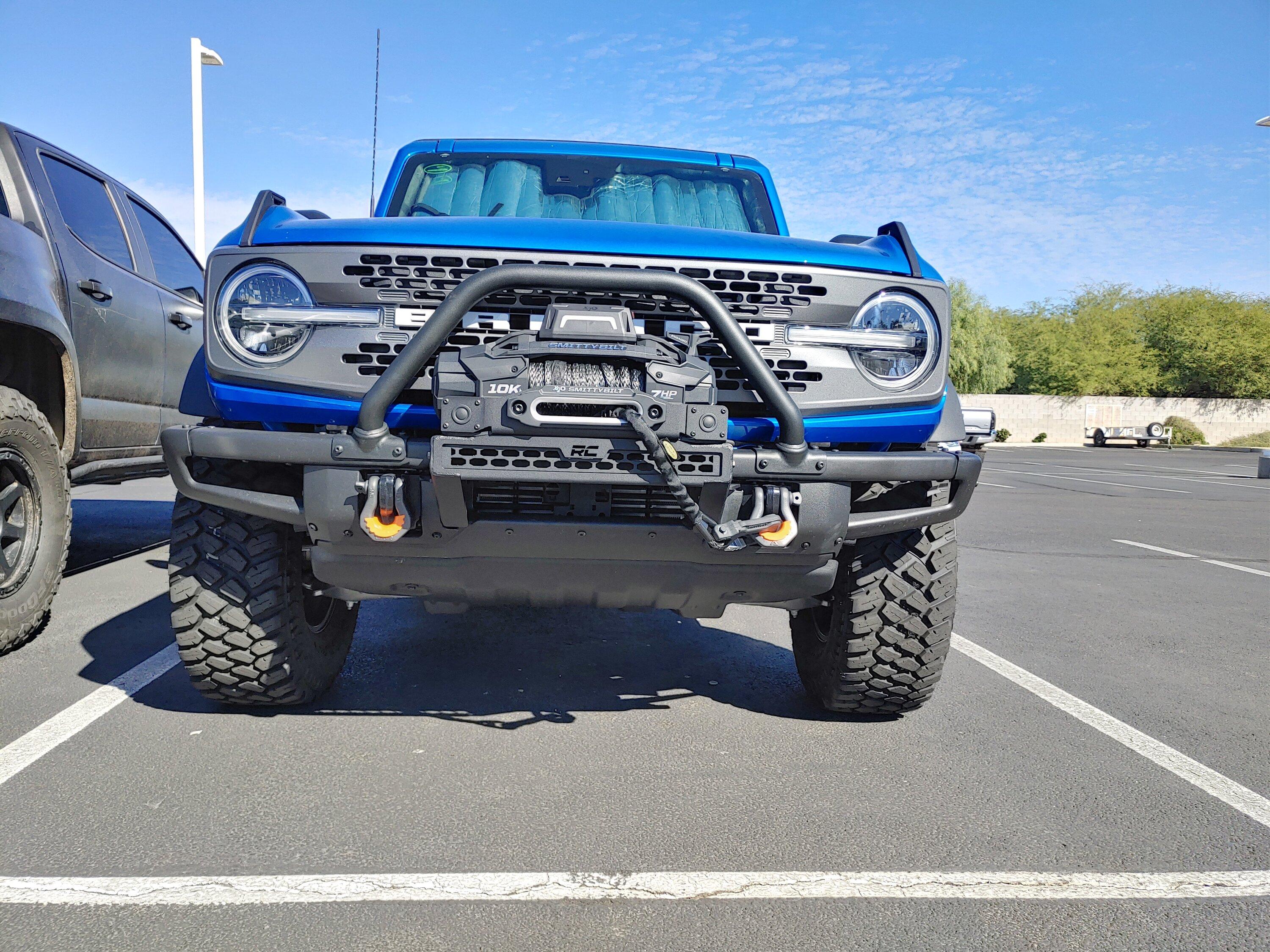

This bracket looks cantilevered off the fr frame horns; has anyone tried bolting the top plate to the bumper to tie it in???
I don't believe the bumper will be able withstand the forces involved. I suggest buying the Tricky Motorsports Frame Horn Reinforcement Kit. I haven't installed mine yet but am considering sourcing longer bolts to simplify things and maybe take advantage of some double shear action.

I wouldn't unless you put a sleeve in the frame. You can't get proper torque on a bolt through an open box section.
Ah yes, duh. My brain was very slow Friday.
Thank you both, I will install with the supplied hardware. Probably not worth fabricating sleeves that fit perfectly.

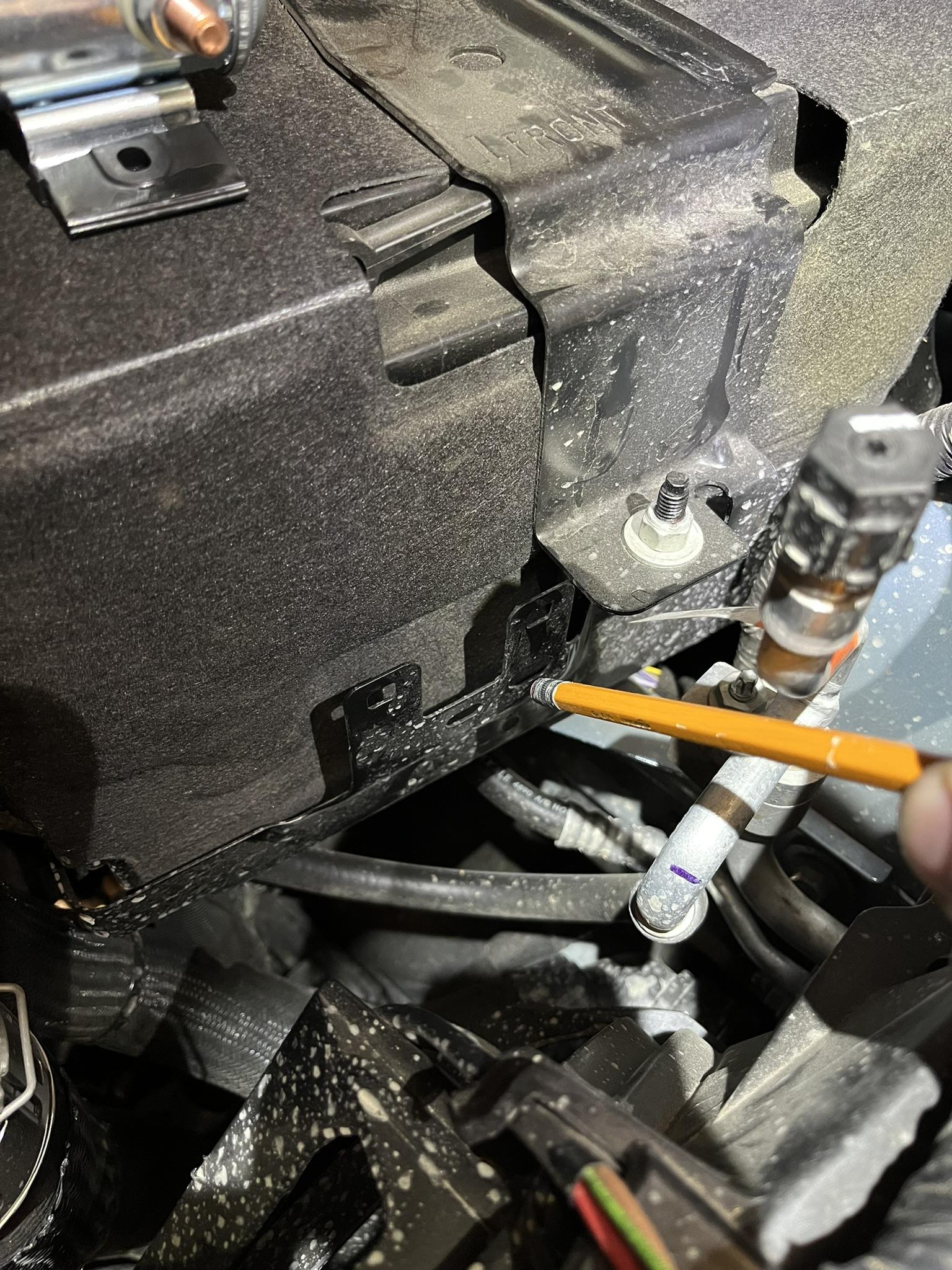

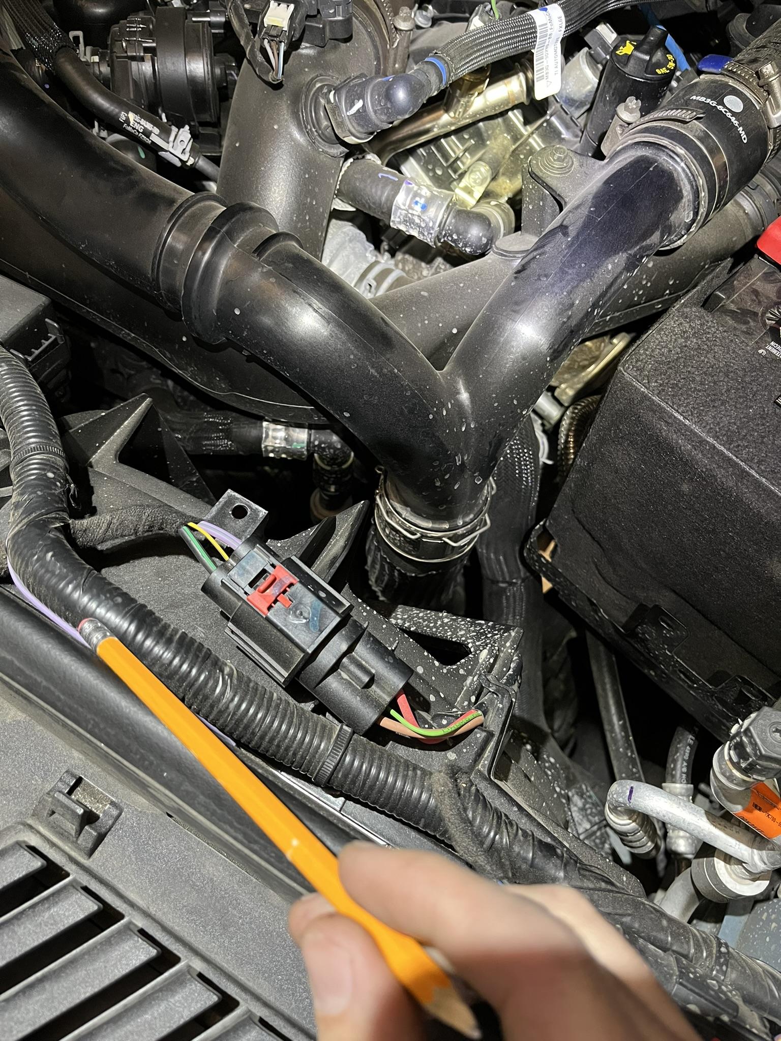

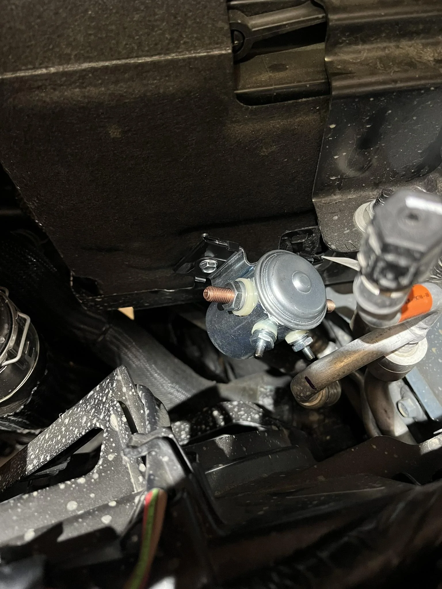

I'm in the overall planning phase of final install of my RC high winch mount and I've got all my components in. I'm planning to add a Warn Power Interrupt solenoid to send power to the winch when I need it and for an extra level of safety. I want to mount to the battery box. Anyone think that's a god or bad idea?
Here are my mock up pics:
Ford Bronco RC High Winch Mount & Winch Install w/ Control Box Relocation IMG_5619.JPEG
So I want to mount here. There are already holes in the bracket. I can drill out more to change angles.
Ford Bronco RC High Winch Mount & Winch Install w/ Control Box Relocation IMG_5620.JPEG
This is the front of the battery box without the solenoid. As you can see, at some point I splashed through something big and got a little water in there. I don't think it would be a huge problem.
Ford Bronco RC High Winch Mount & Winch Install w/ Control Box Relocation IMG_5622.JPEG
I plan to power the solenoid off the prewired front upfitter wire at the grill. It's close and easy access for powering on from an aux switch when I need to winch.
So that's my plan. It puts the solenoid close to the battery terminal and its a convenient location for access and replacement if needed. Anyone smarter than me think that's a good or bad idea?

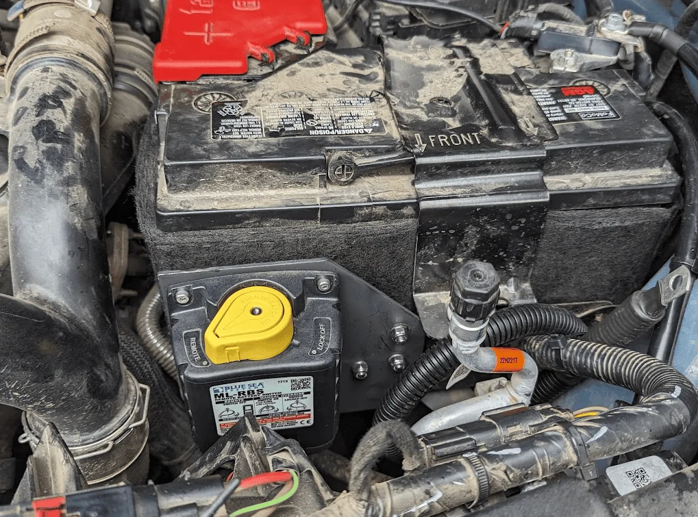

I did almost the exact same thing with an AL plate and a Blue Sea Systems solenoid wired to the up fitter switches. Works great!
Ford Bronco RC High Winch Mount & Winch Install w/ Control Box Relocation 1702311609441
UncleBuck
456
1,339
Washington
2011 Ranger XLT 4.0L - 4x4
That's awesome! I'm glad someone else is thinking about this spot. I like your mount plate. I might fab up something like that and get my solenoid a little higher.

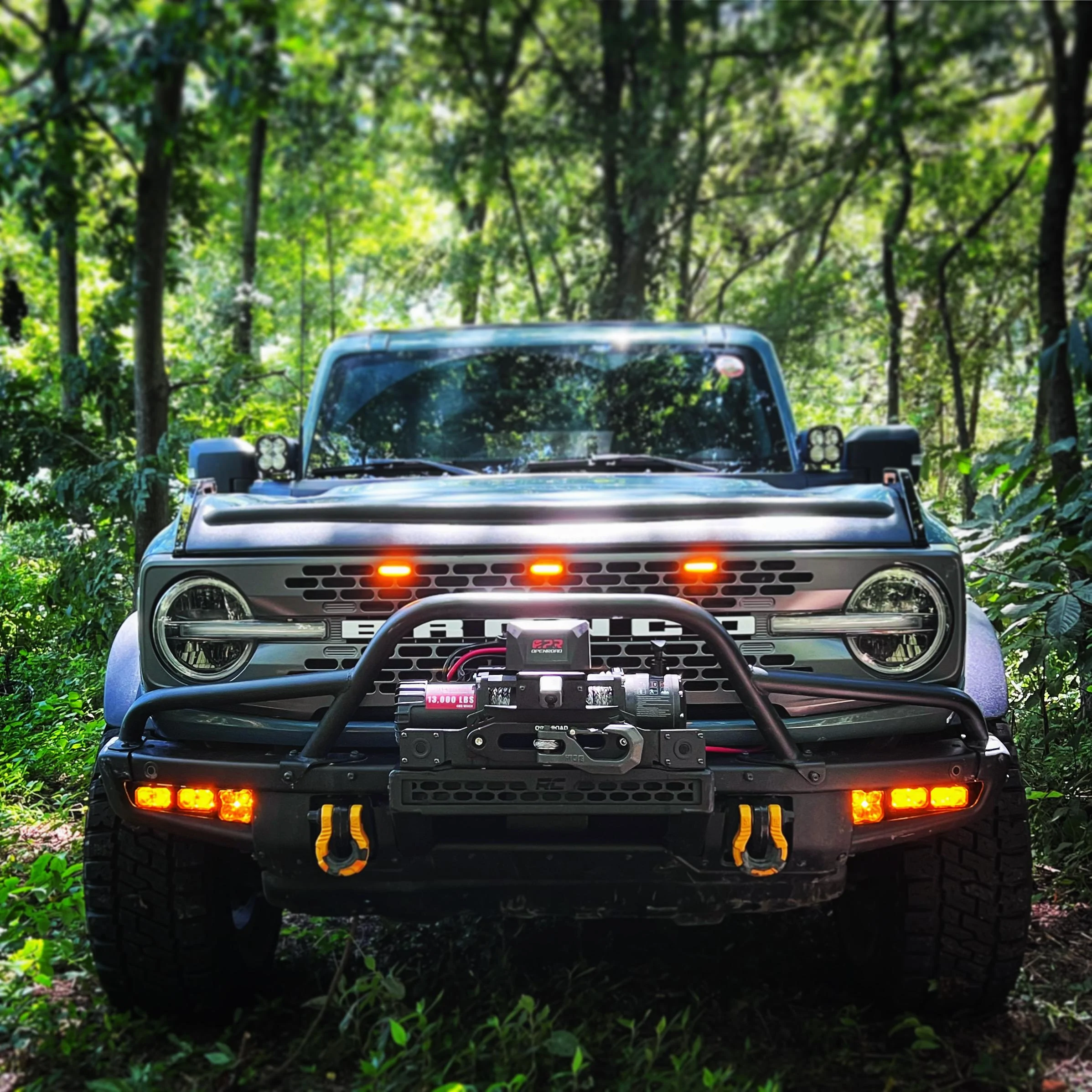

Here you go. Finished trimming the bolt covers the other day. All finished.
This looks really good but, does anyone else notice the misalignment of the winch vs. the ends of the sensor mounts? I feel like every photo has this. My OCD is a nightmare I guess, but it's really bothering me 😂
