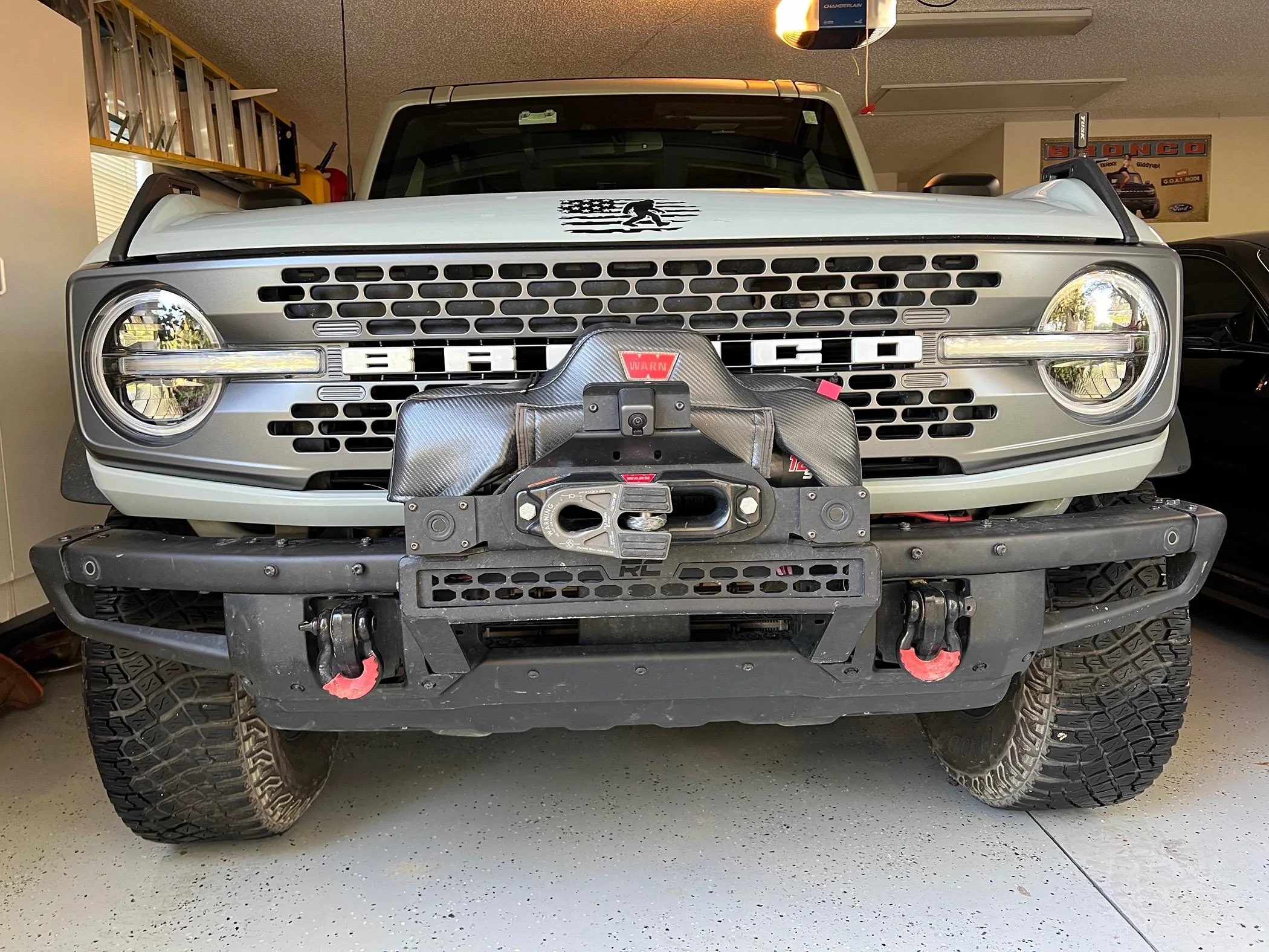

I did a vid on the install to my 2024 Heritage.
Curious if anyone is using/not using frame horn braces with this or similar aftermarket winch?
Thoughts?

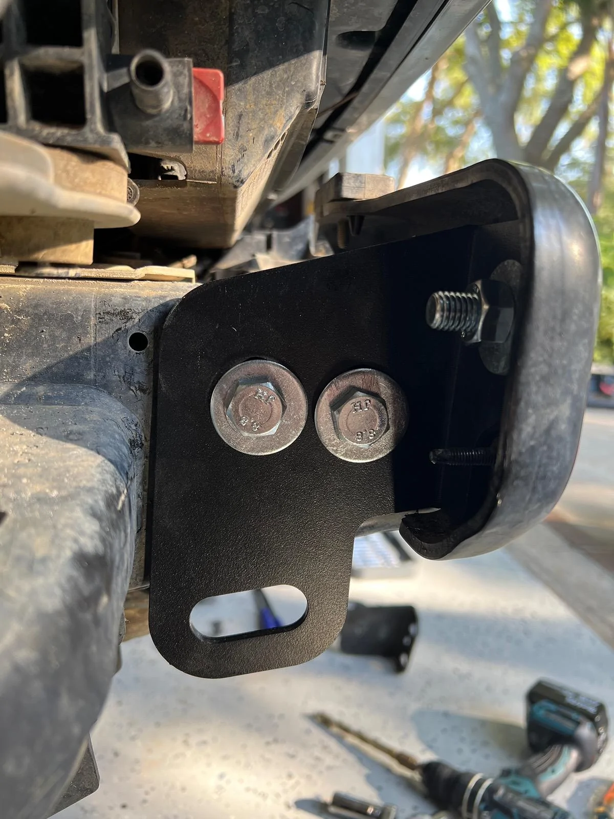

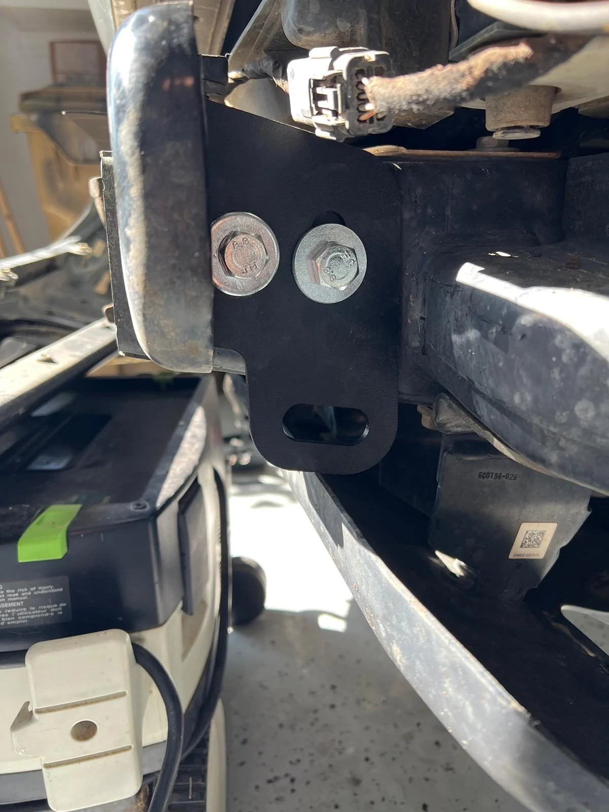

Winch was on for 18 months and never used. Decided it would be wise to add the LOD brackets, which I did a month ago. I’m an old Boy Scout, generally always prepared. The brackets fit into that category. Now I don’t have to worry.
Nice!
So... Quick question. Did you have to pull the bumper to install 'em?

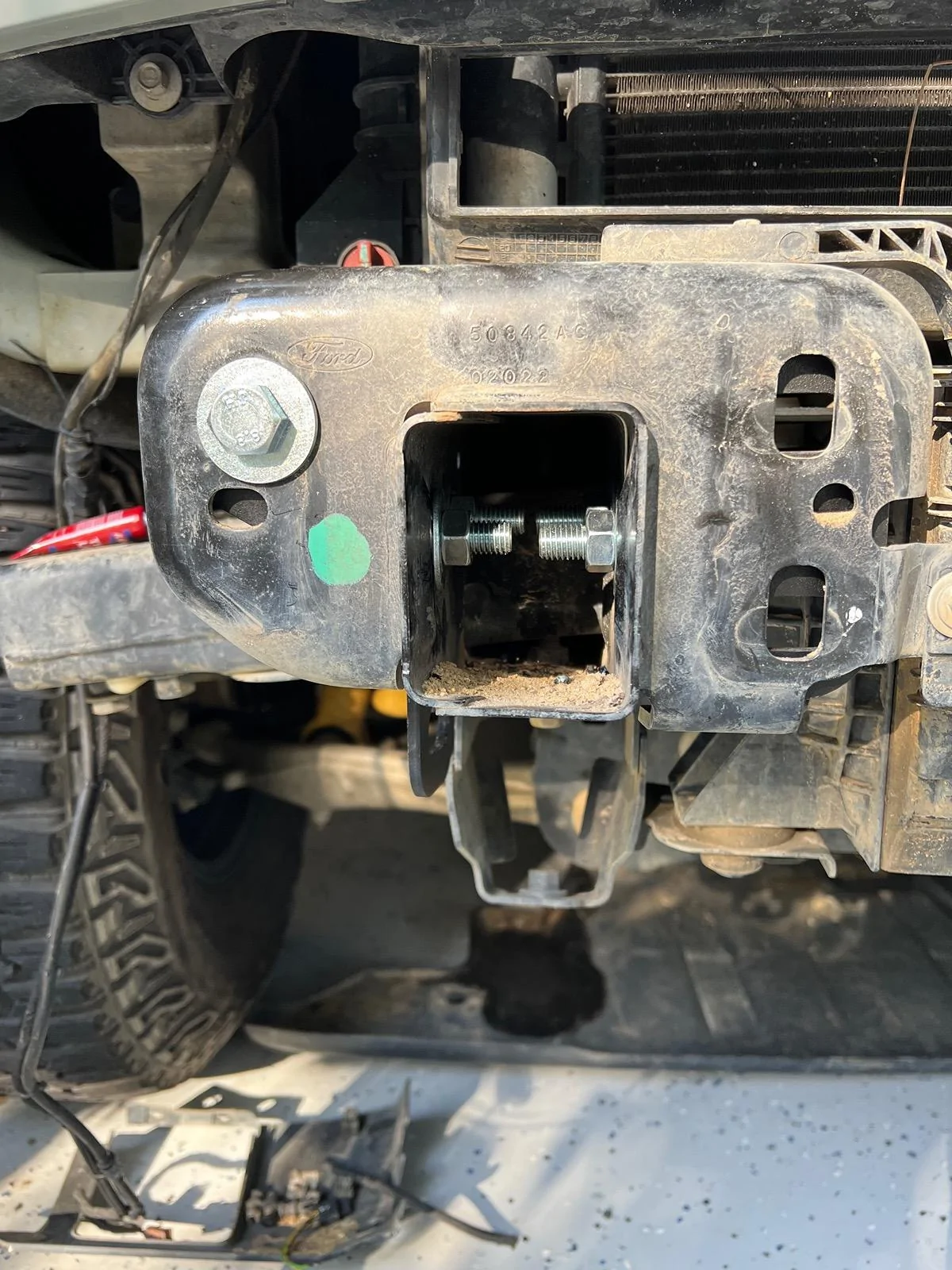

How did you get the bumper mounted back on without the nut plate? I went to install these brackets today and ran into that problem. How did you get and hold the nut in place for the bumper?

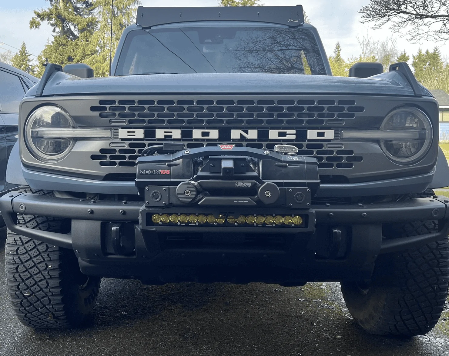

Great thread right here all about the RC high winch mount. I'm running the now discontinued Tricky Motorsports frame horn reinforcements on my build. My build is all listed on like page 12 or 13. Many builds with ideas for everything you need on different winches, control box relocates, camera relocates, custom camera relocates, etc. Read the whole thread, it's really fantastic. I love my setup and although I haven't had the winch under heavy load for recovery, I've done testing and it's held up.
I supported/balanced the bumper in place with my Harbor Freight Badlands jack. Then just used both hands. With out the jack, you either find a way to support it or have two helpers to hold it while you install the bolts.
