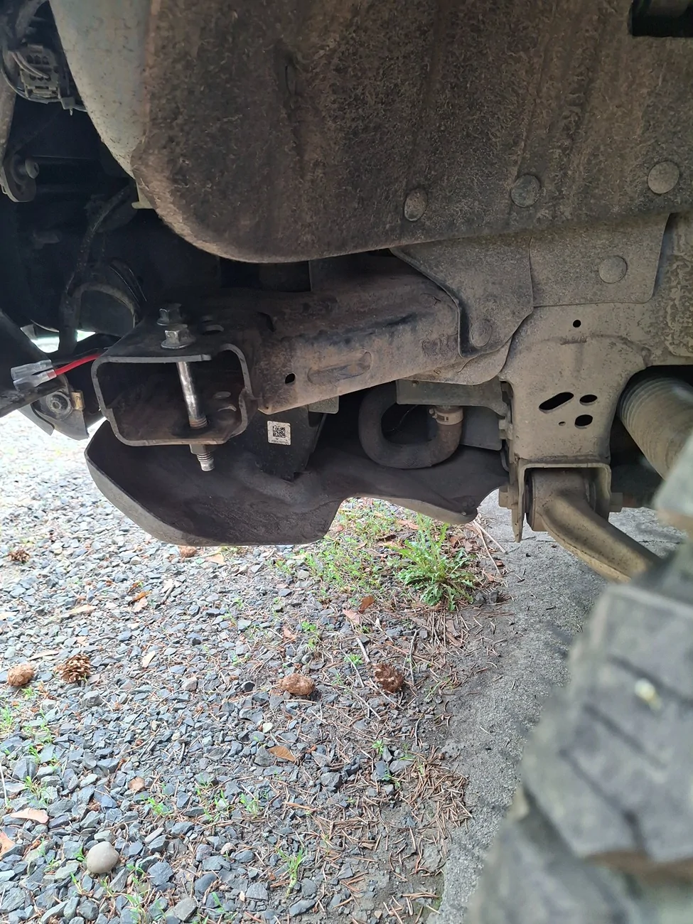

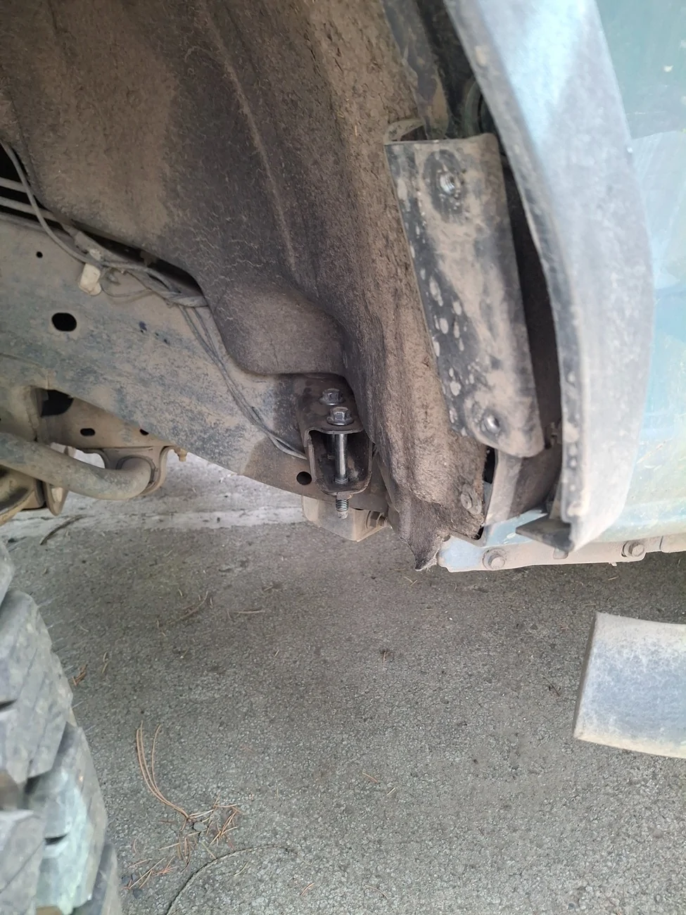

I went with the General Grabber AT/X in 285/70R17 10ply because;
I knew the tire so no surprises on handling, wear and noise so for 90% of my driving they work well. I haven't looked to see how much weight was used.
Made in the USA
Cost
I got AM wheels with 0 offset so that pushed them out 55mm from OEM is my understanding.
But here is what I found at mounting time;
The Mabett front mud flaps rubbed at near to full tilt. Removed for now.

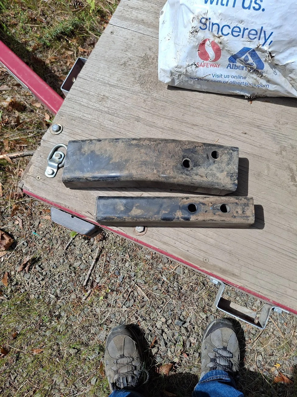

On my Black Diamond there were 2 brackets on each wheel well bolted (2 each) & extending out from the frame. These rubbed 100%. I suspect they were OEM mounting points for front guard and running boards? Removed them and plenty of room. Note the nuts are welded to frame.

Per the pics. Here is what I had to remove and where I had to remove them from. It dosen't look right to me somehow.
It will be fine. That’s what everybody does. LEV8 makes a bolt-in end for those if you want to look more finished. I have a picture of mine somewhere. I actually just took them out because I put 37’s on and trimmed back the frame brackets

Those are the crash bars. If your bronco came with 35s on it, it would’ve already had those removed.
