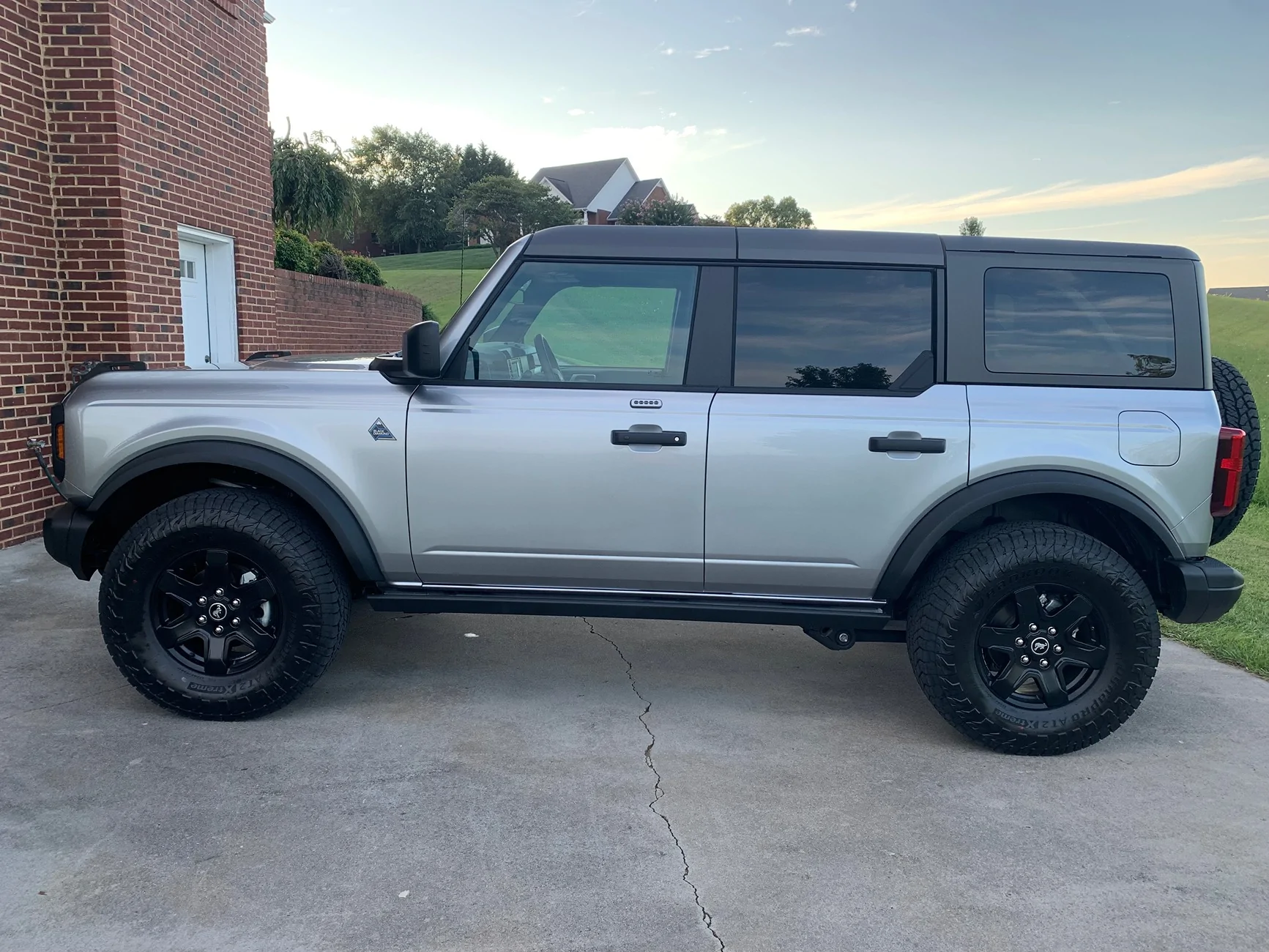

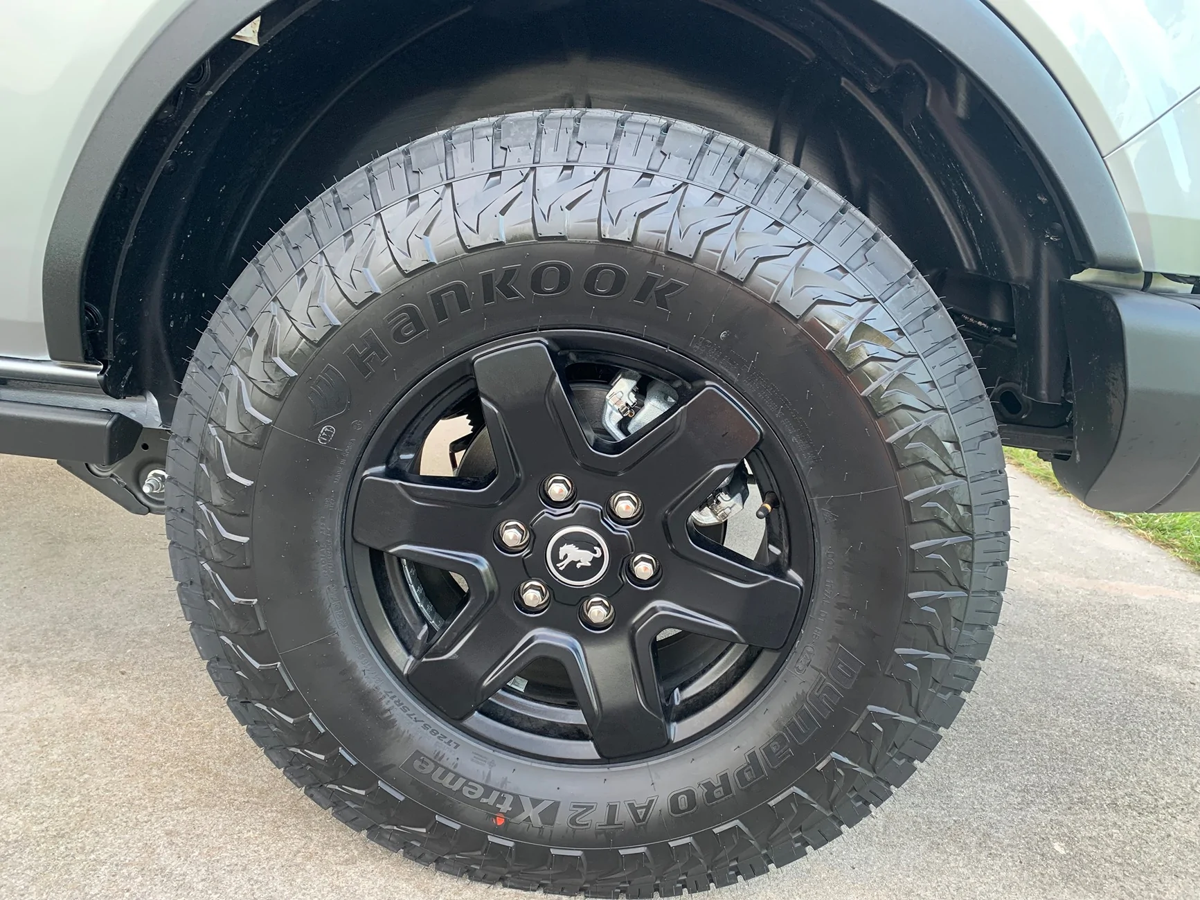

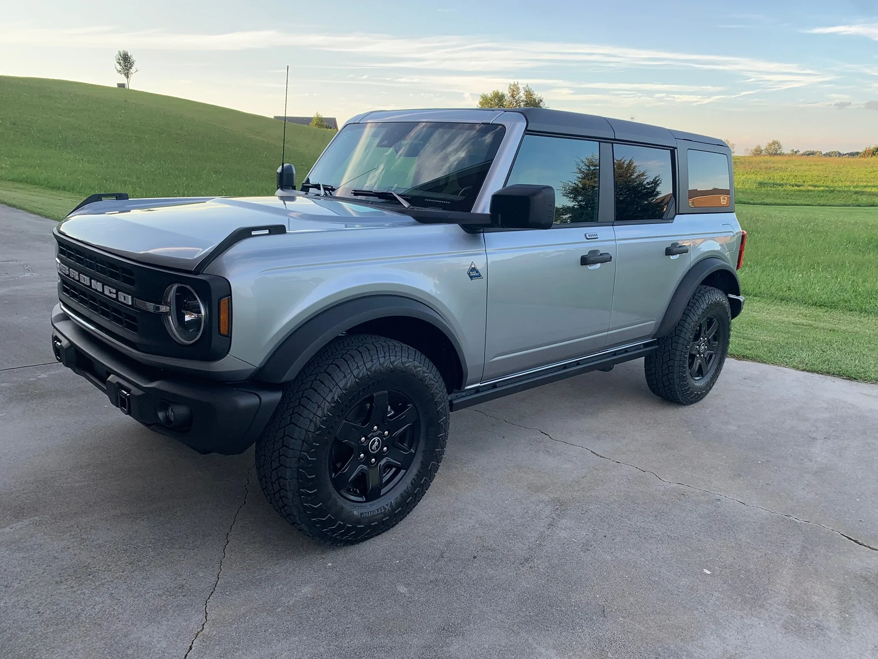

Hankook Dynapro AT2 Xtreme 285/75 17 on my 2023. This is the perfect size tire. The hankook is great. Smooth and quiet AT tire.
No lift and No rubbing. Love the way this size tire fills up the wheel well
Height with stock tires: front 36.5 rear 37.5 ground to fender lip. With new 285/75 17 front 37.5 rear 38.25 ground to fender lip

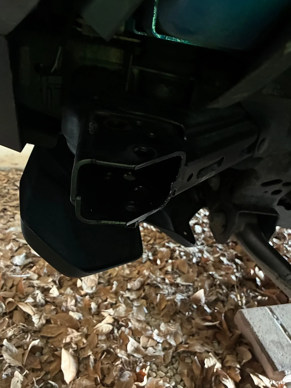

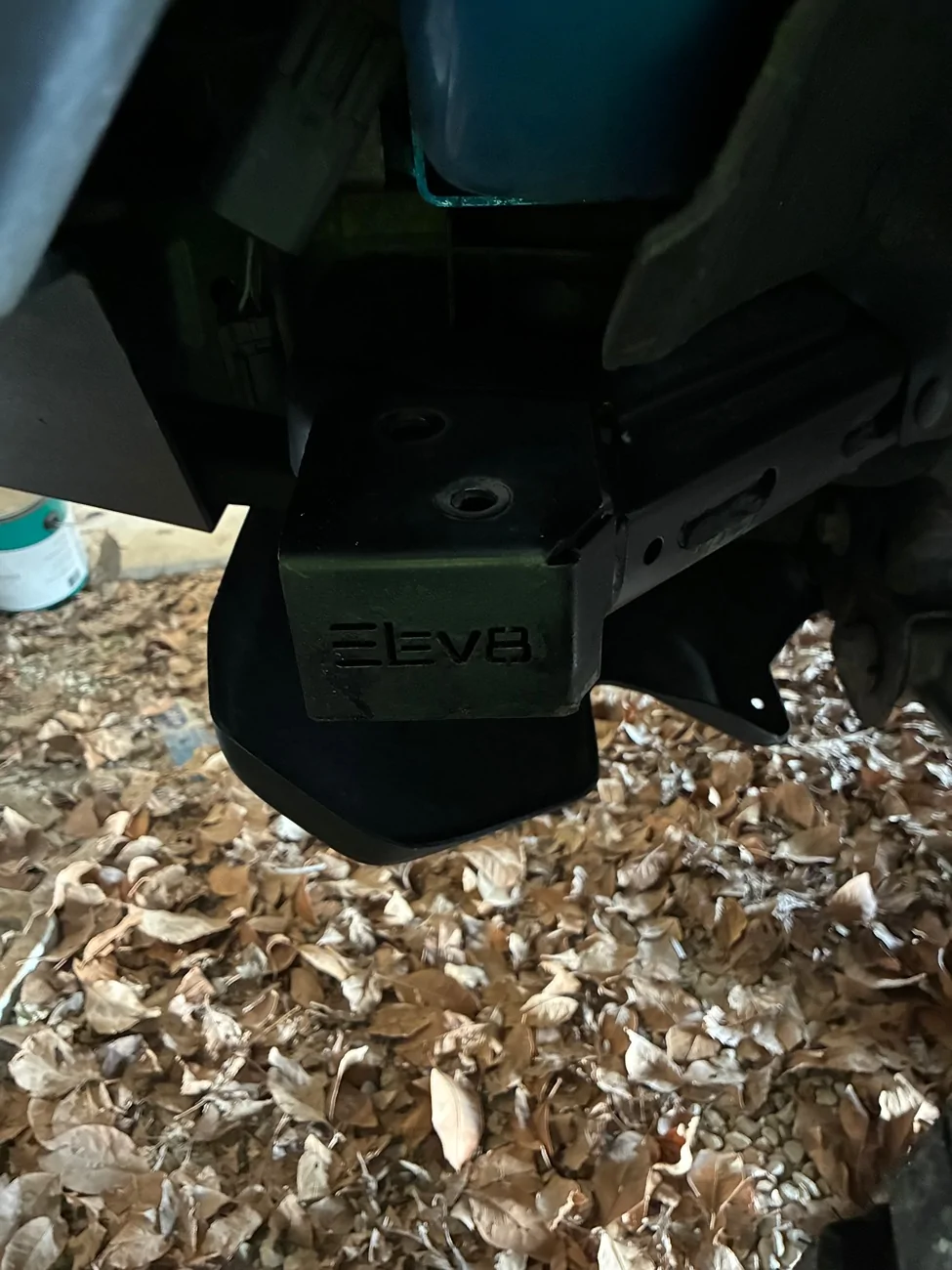

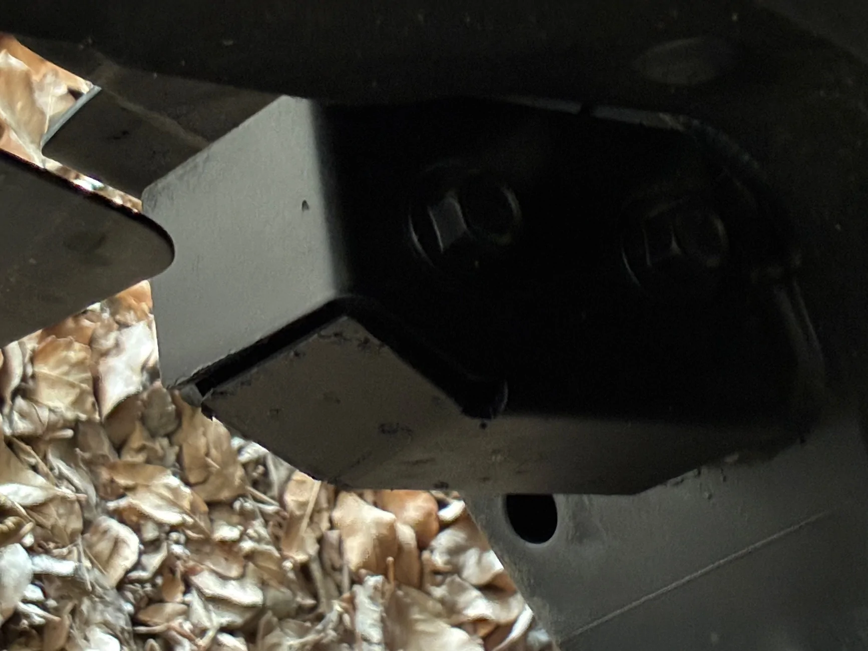

It will be fine. That’s what everybody does. LEV8 makes a bolt-in end for those if you want to look more finished. I have a picture of mine somewhere. I actually just took them out because I put 37’s on and trimmed back the frame brackets
I take it ELev8 front & rear covers means front of front wheel & rear means rear of front wheel.
You wanna sell yours?

Per the pics. Here is what I had to remove and where I had to remove them from. It dosen't look right to me somehow.
Yup those are the crash bar mounts on the Bronco, and the crash bars themselves you had removed.
