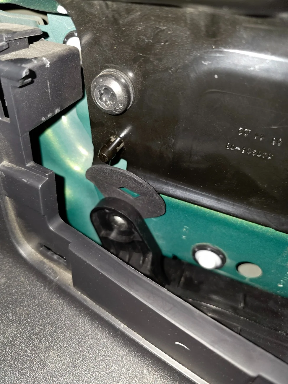

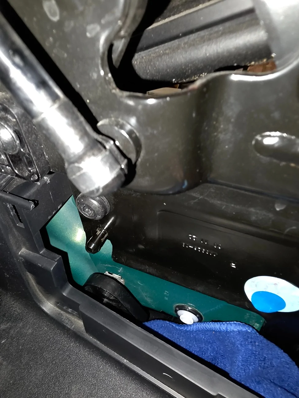

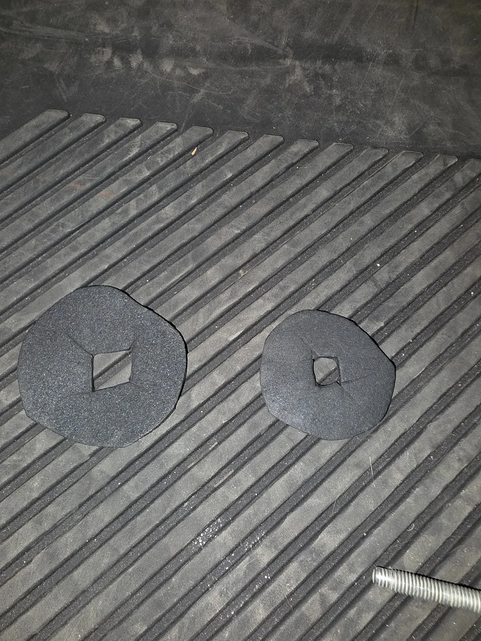

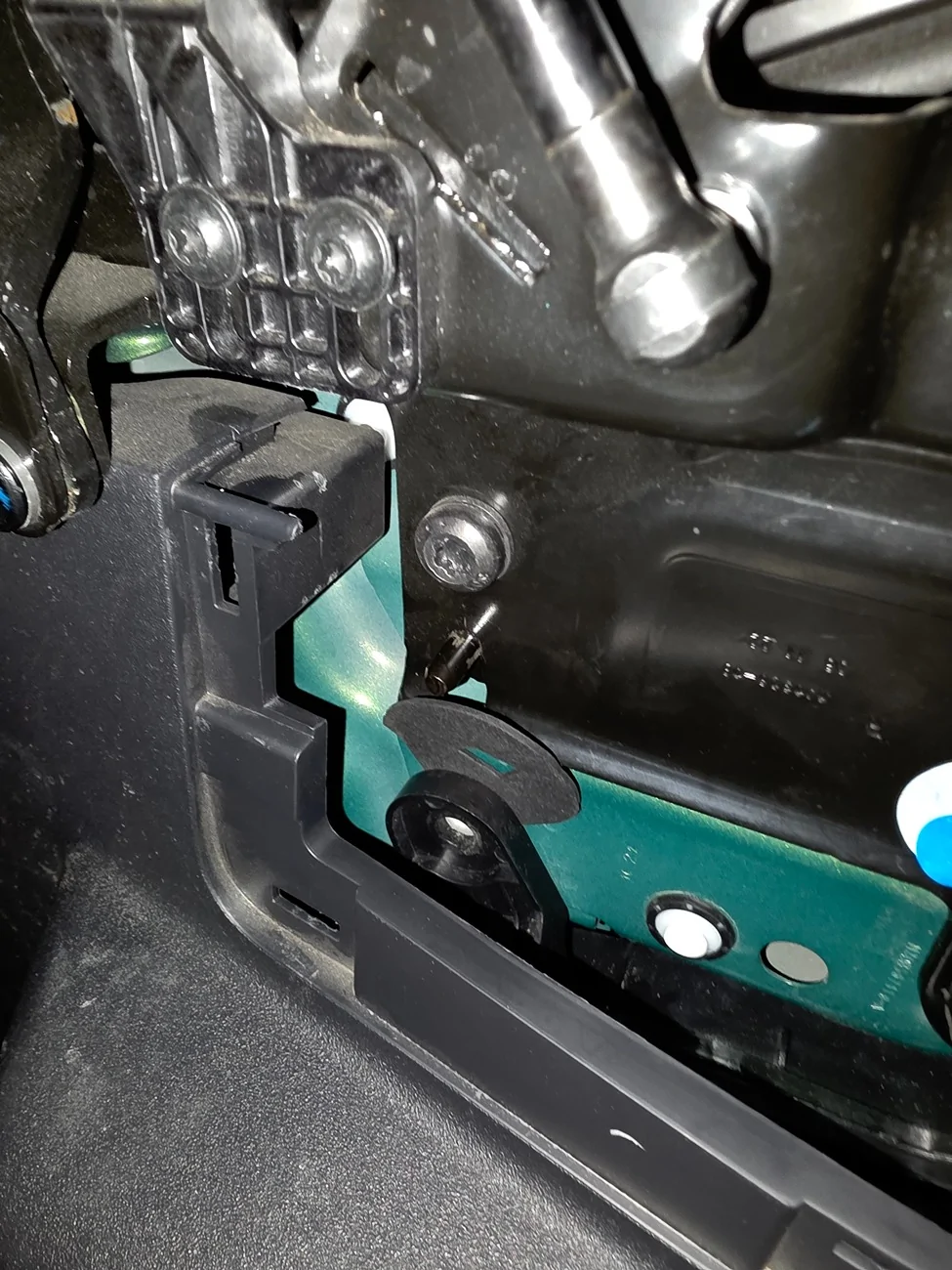

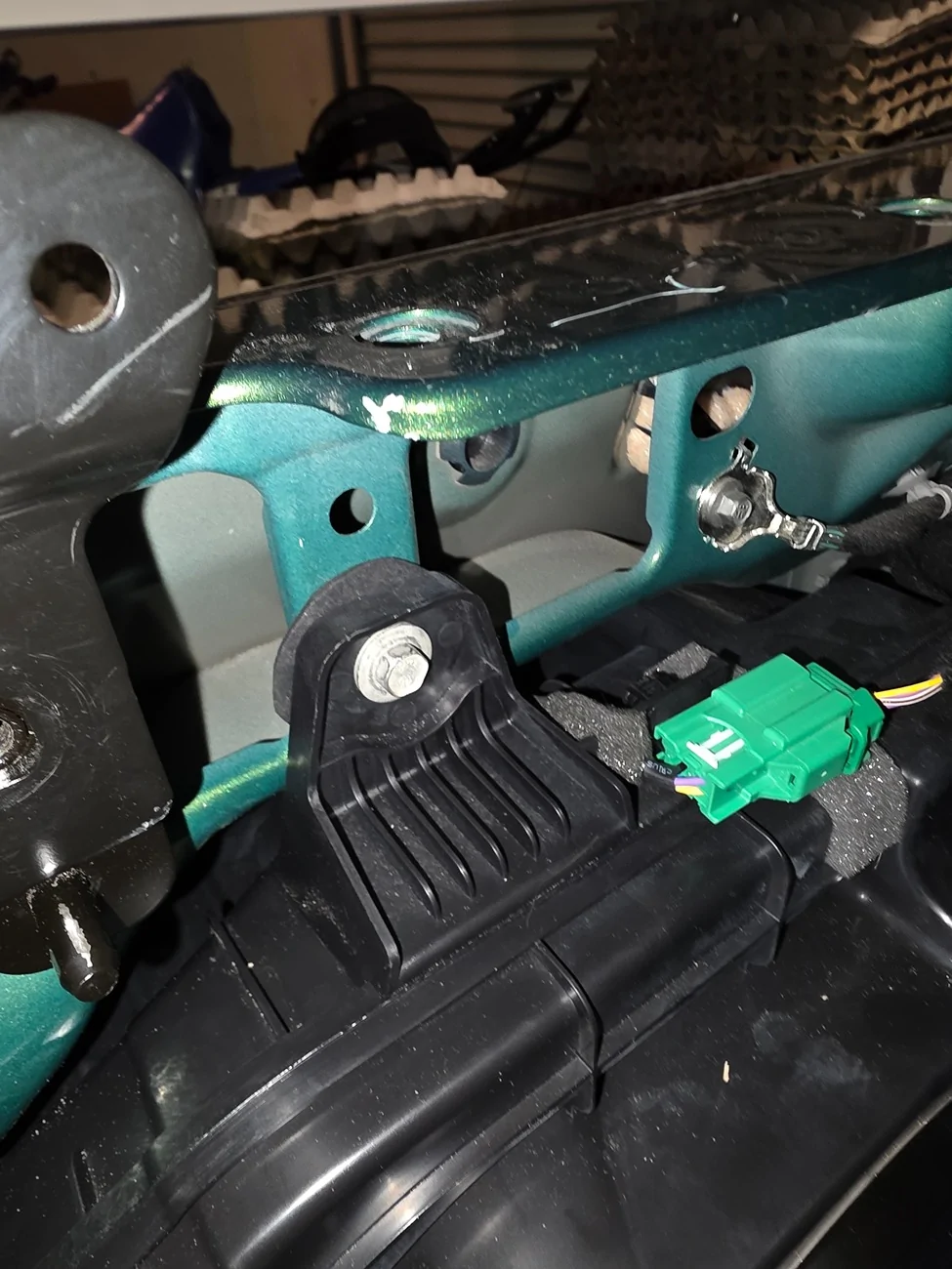

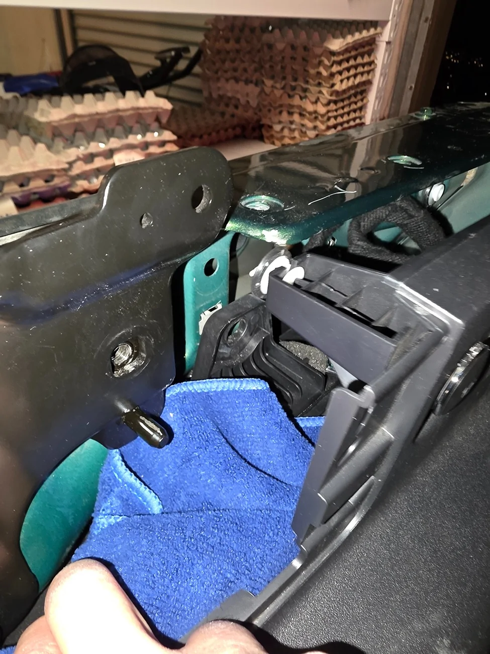

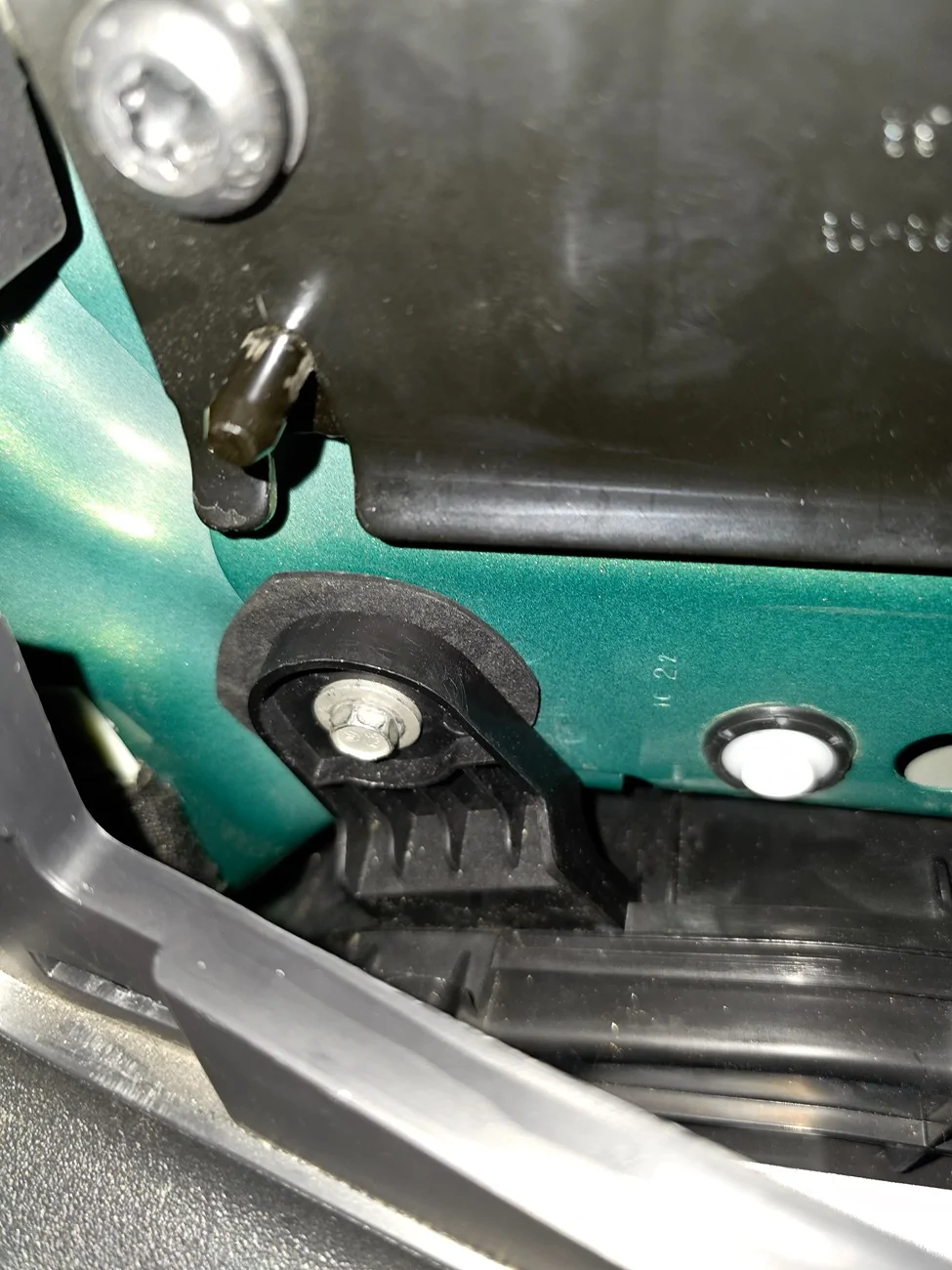

Funny there's a TSB now, my sub developed a truly irritating rattle and I forced my dealer to warranty me a new subwoofer, just for the rattle to come back. I finally tore apart that area before a long trip. Come to find out it was the subwoofer plastic housing bolts (I addressed the top two locations because those were the ones I could get to that night) that is basically plastic on metal. So I mcguyvered a rubber washer/gasket from a thin floor mat and put it back together. Its a little ghetto but completely fixed the issue. Now I can bump my music at max volume and no rattles. Give it a shot!
You'll know it'll fix it before doing it if you have a bass heavy song on and push on the subwoofer housing hard towards exterior on the painted metal quarter panel and if the rattling stops you'll know its not actually a bad speaker. Make sure to put a cloth underneath to catch any falling bolts or washers.
Pictures attached.
