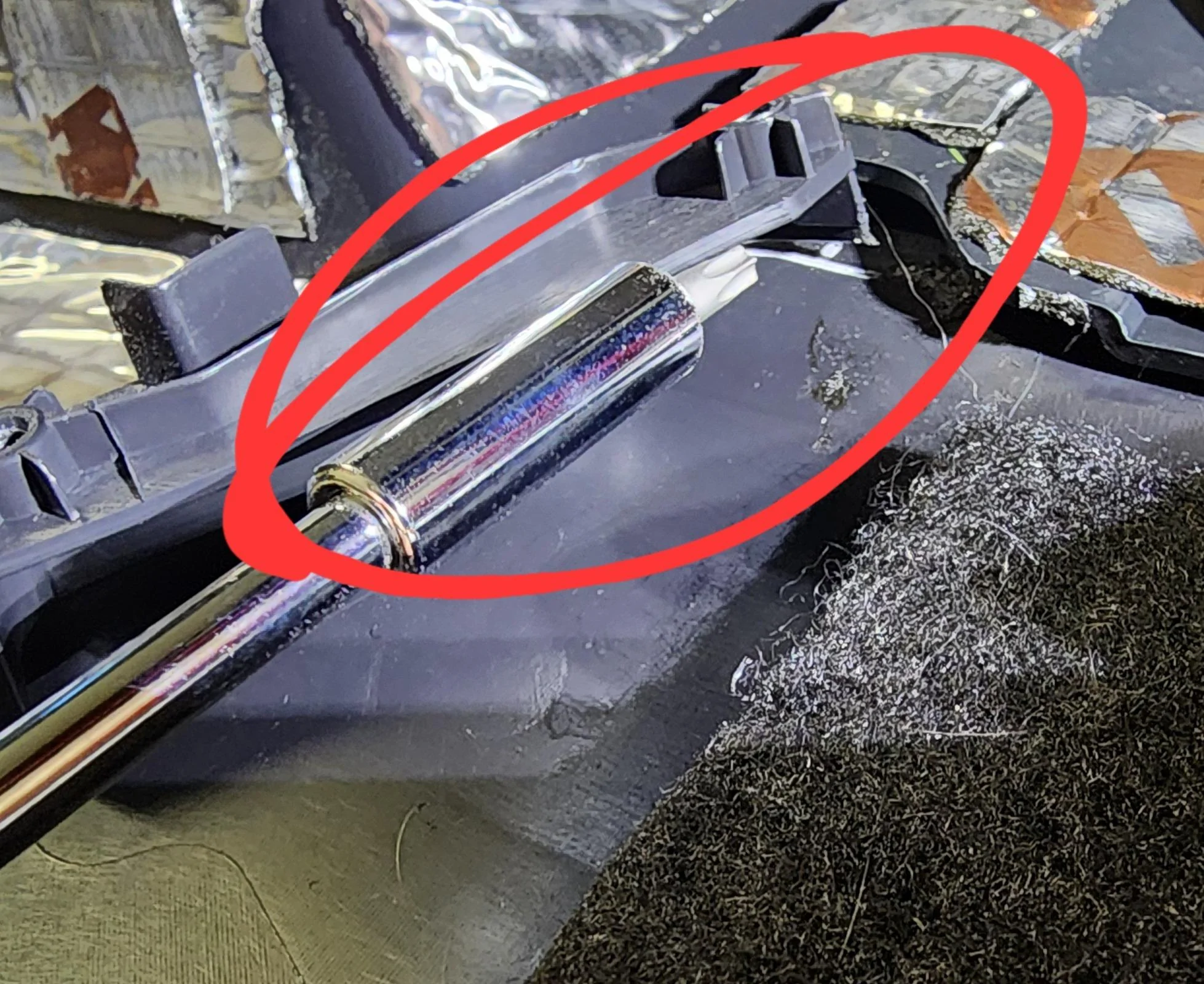

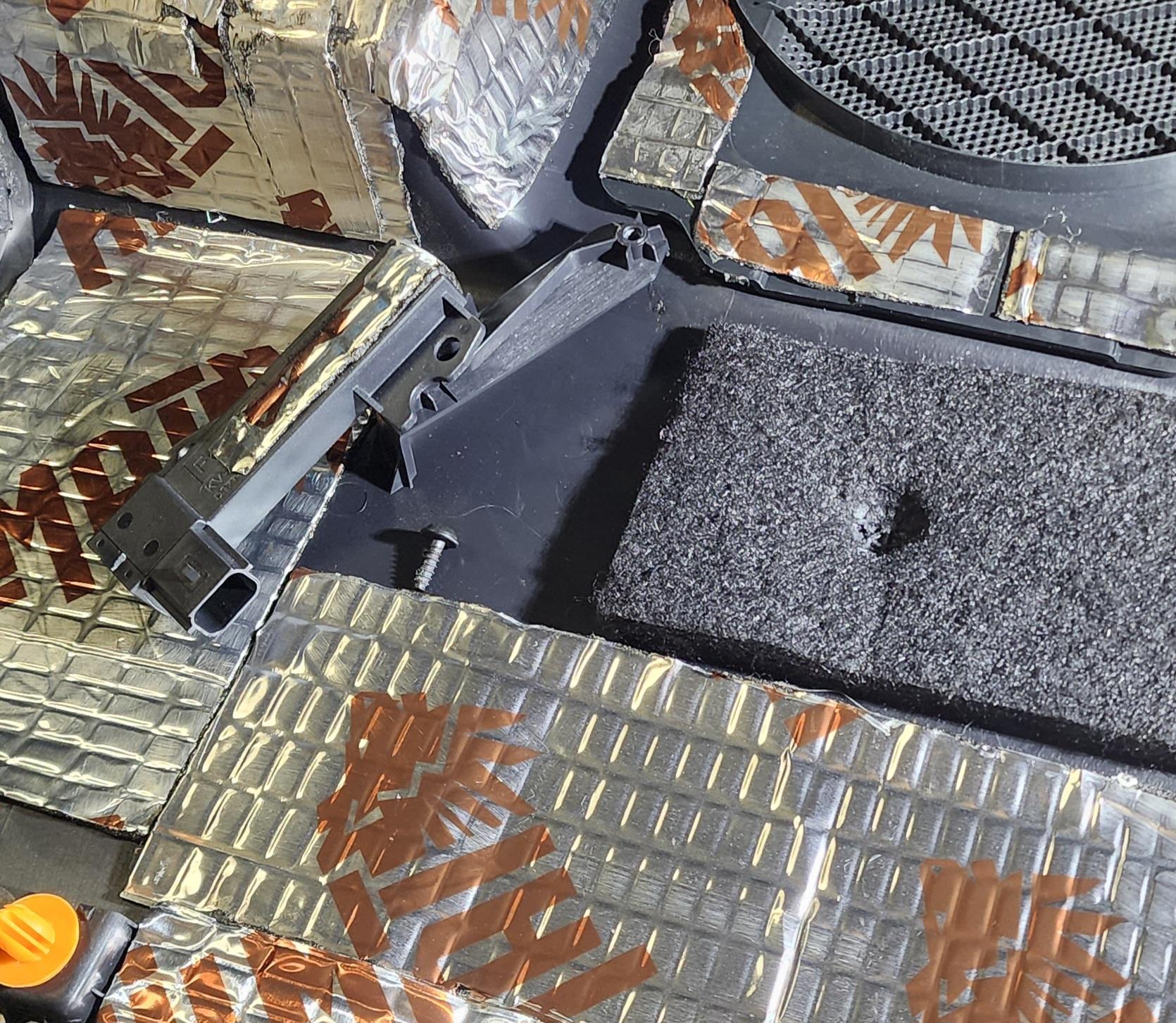

Just FYI. I was messing around with an increasingly bad rattle (hence this thread) and found that the bolt mounting the sub at the ton was loose. A few turns with a wrench and almost 0 rattle.

I wonder if this is my issue then, it's been increasingly worse almost as if a bolt has been slowly loosening 🤔
