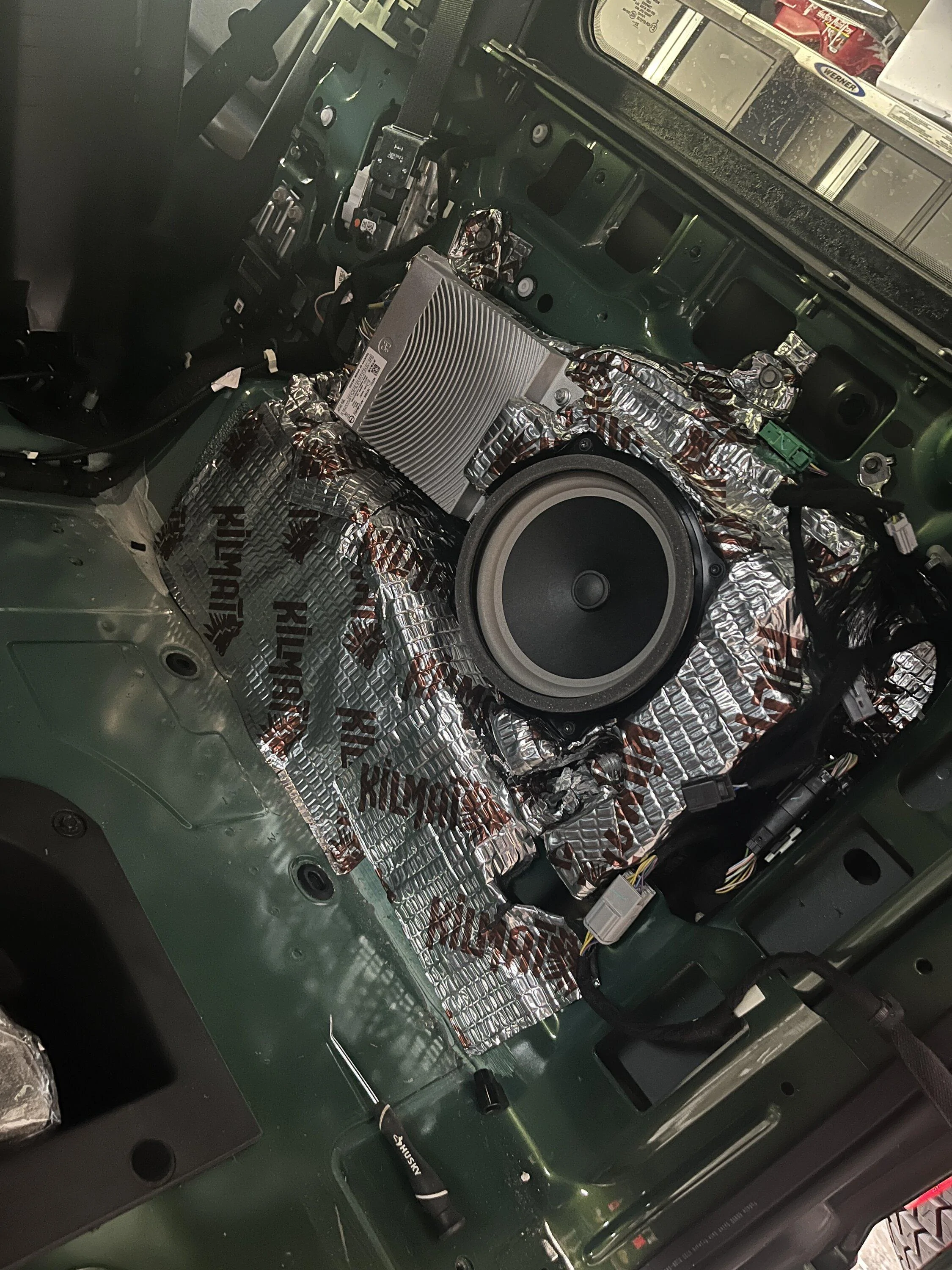

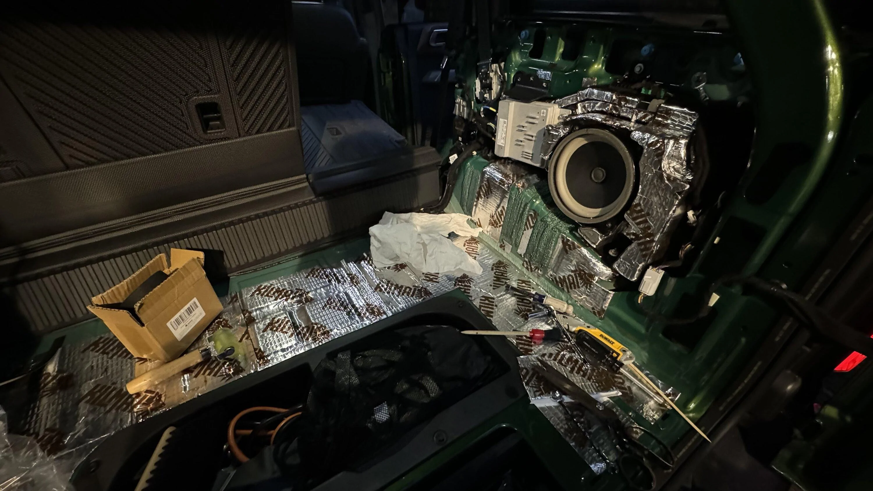

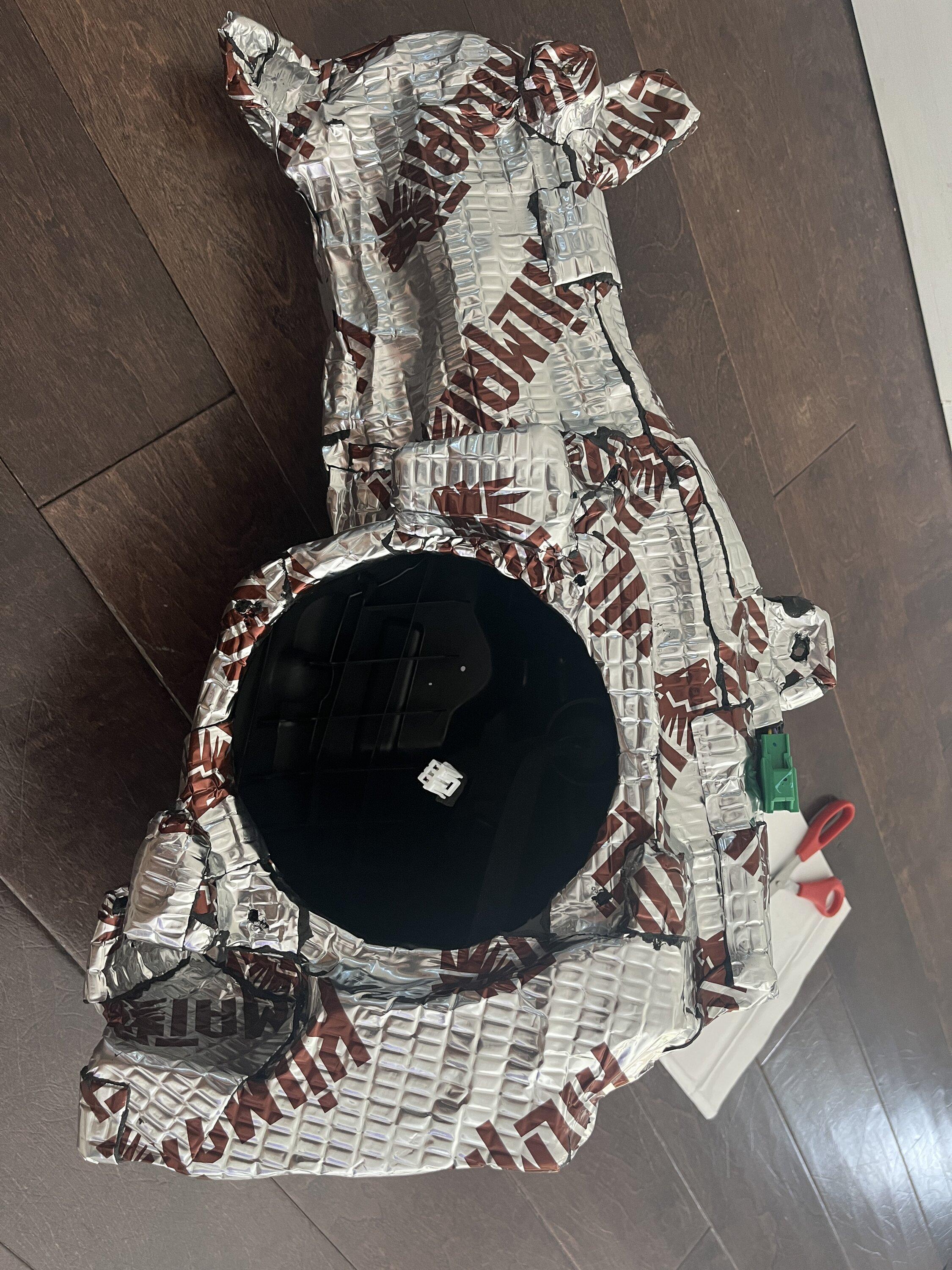

I'll also add that I added cloth tape or foam anywhere and everywhere two pieces touched, especially the clips and screw threads. I used rubber washers on the 4 sub box connection points also. I wasn't having bad rattles (except at higher volume with bassy songs) but since I had the back opened up and I had plenty of materials I went ahead and kilmatted any flat/metal surface.

Adding in Kil-a-mat and pulling out the entire enclosure, then re-torquing the attaching screws was all it took to clear the rattle back out. Honestly I think it was just the screws were loose.

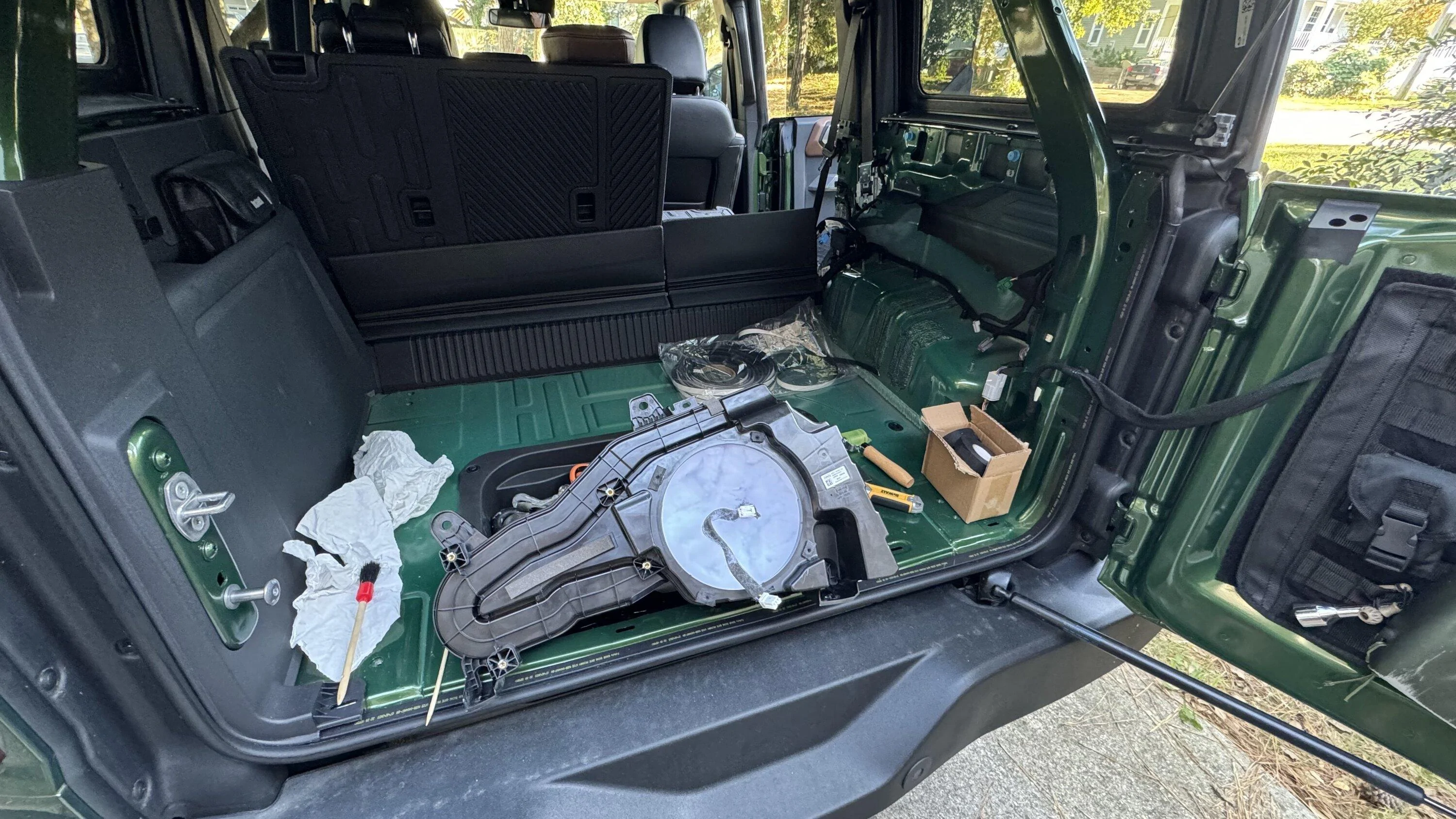

All said, I had to go back into this back side panel like 4 times, so I was a pro at it by the end of it. Not too difficult to do but you do have to pull out a lot of interior panels to get it. There are good videos showing the process - not difficult, there at the end I could be in and out inside of 20 minutes, but the first time it took me almost an hour. There is an TSB update for the snapping clips for that rear interior panel (new P/N W722128-S300), although I haven't been able to find the updated clip in stock anywhere. I ended up replacing one of them with just a standard barbed plastic clip. I don't think this is what was causing my rattle though.

When I went back in, I used the 6.5" Kicker hoping to not have to significantly modify the stock enclosure - I was hoping to just speaker swap and be good. The stock speaker had some plastic alignment that I had to cut out, and there were some reinforcement gussets on the back side of the housing that kept me from using speed nuts to really toque the speaker screws in. I just used sheet metal screws and a bit of silicone and thought it should be ok.

Since the rattle wasn't fixed, I went back in. Pulled out the entire enclosure, Kil-a-matted everything, and screwed it back in good and tight. That fixed it. Been running good since.
