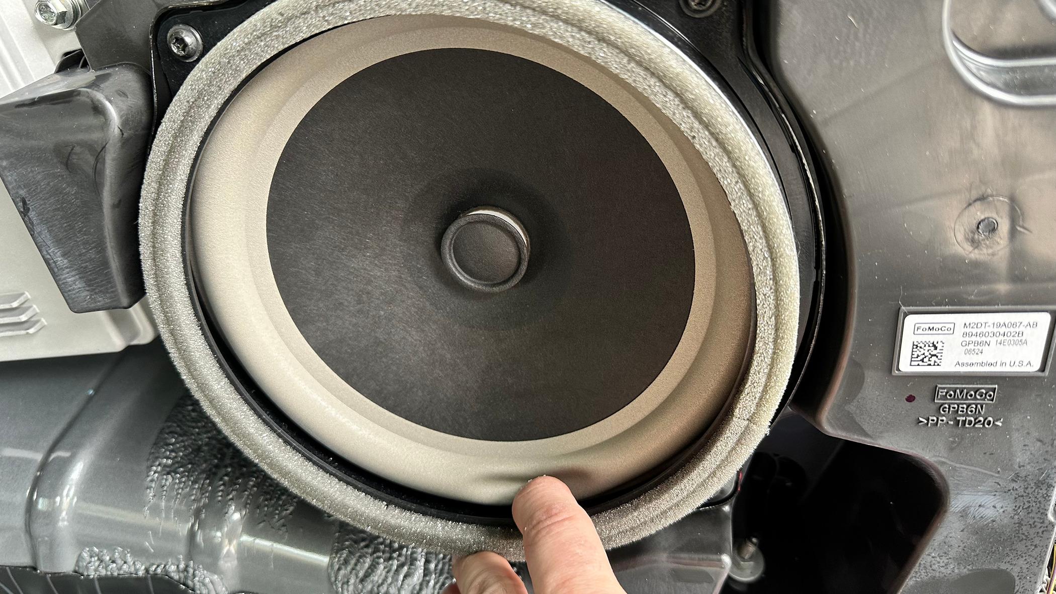

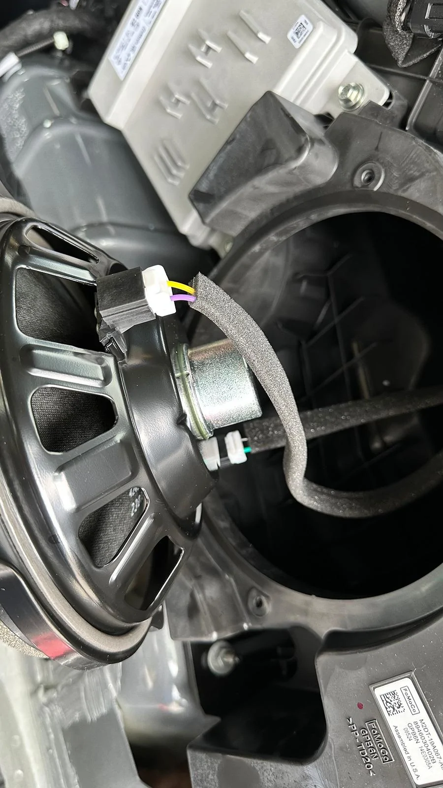

so I took everything apart and didnt see any immediate cause for the rattle. I ruled out any of the plastic trim, and put some amazon trim clips with some 3d printed TPU washers. That reduced the slight vibration i had in the panels. But it seems the sub itself is the culprit.
I removed the enclosure and saw the wires behind it, but nothing seemed immediately like it could be a problem. I dont think the sub could be hitting the wires.
It seems that the rattle is only when the woofer hits full flex. Not an official troubleshooting step, but when i pressed a bit of the rubber gasket/diaphragm, on those bass hits, the rattle stopped.
I sealed everything back up and used some loctite. Not sure what my next step is. A coworker said suggested removing the sub from the enclosure and seeing if the rattle continued. Not sure what that would prove other than whether or not its hitting the wires or anything in the enclosure. I have a video but for some reason it didnt record the sound.
It’s possible part of the cone is starting to separate from the driver and that’s what is causing it in your case. Fix for that is a new speaker though, if that’s the issue
Is there an easy way to confirm this is the issue?
if it’s a warranty thing (purchased 4/5/24) I have no issues pursuing it. Else, I’ll just upgrade the sub.
Sometimes you can see it physically but not always. If you are looking at a warranty claim you should just take it in to the dealer and show them.
