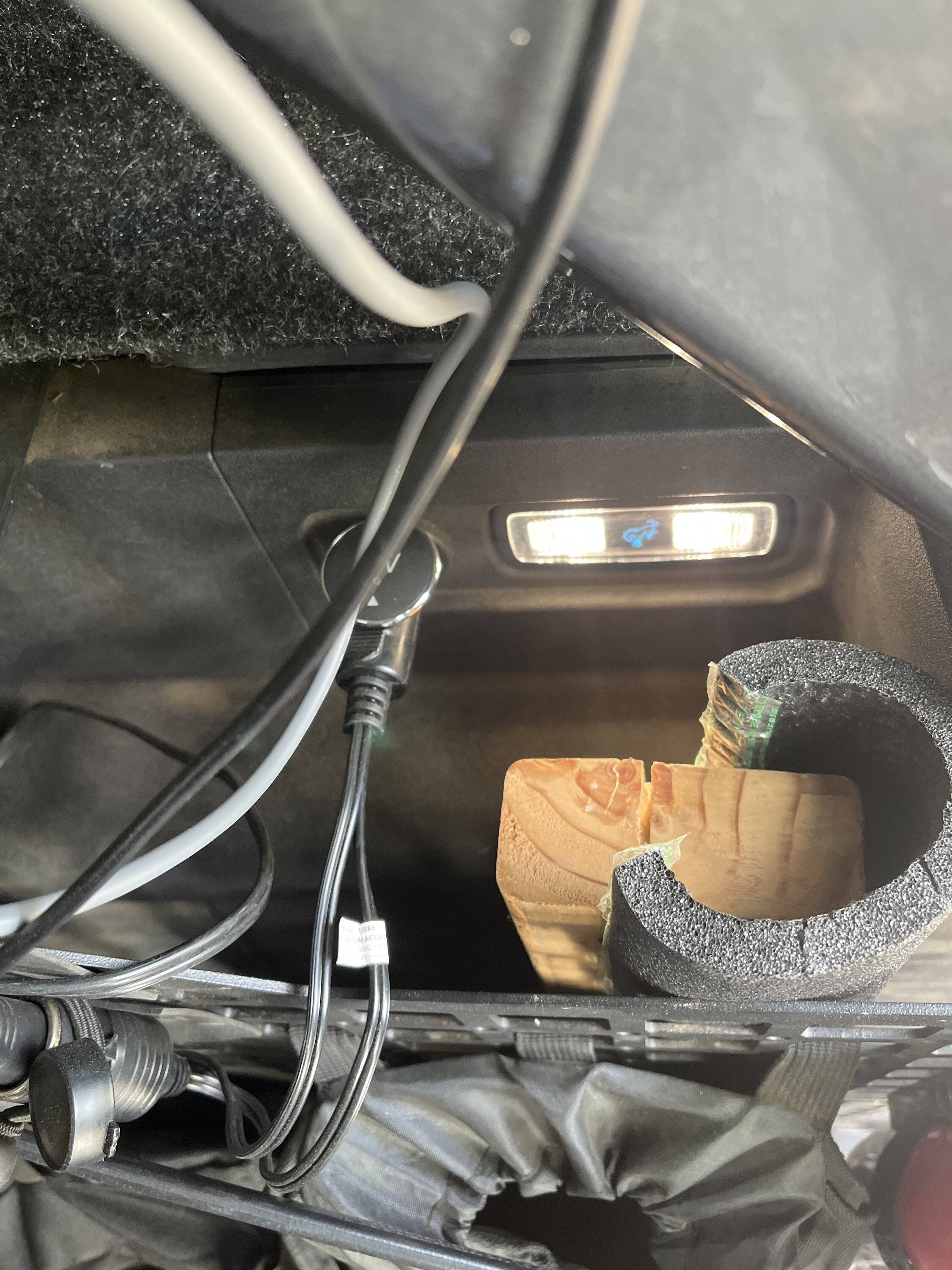

Have a Kicker 8” 2 Ohm run by a Kenwood 802.5 - so about 300W give or take going back here
Finally got back to see about some of the frequency related rattling, and it’s the cargo trim panel itself. Not sure if I have a missing/broken/loose clip or if the sub excursion is hitting on the panel itself or what. If I push inward on the trim panel near the top of the sub grille I can get it to tighten up and the rattling stops.
But I did come up with an ingenious fix that seems to have resolved my issue, at least temporarily
Ford Bronco My fix for interior sub trim rattle image

Not entirely sure what I’m looking at, but I’ve noticed in the 10 speaker B&O that I have, that certain bass frequencies produce a somewhat high pitched rattle, which is annoying.
I haven’t tried to isolate the source yet but definitely will.
