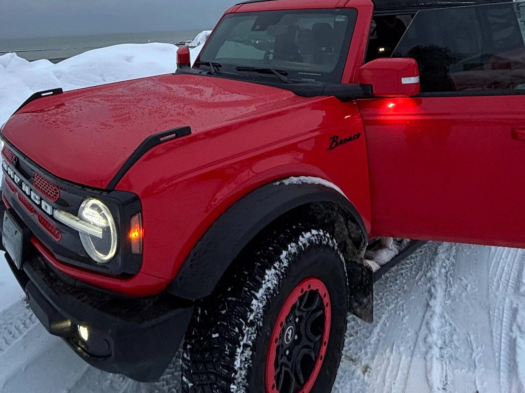

I kinda came to the opposite conclusion after driving the Bronco in snowy/sleety/icy conditions for the first time a week ago.
Now, like many of you, I've been driving in snow for a long time (almost 40 years) and only one of the vehicles I've ever owned has had AWD/4WD, and all my vehicles up until the Bronco, have been cars that are at least a bit sporty, so you have some good things for driving in snow ie. limited slip differential, and bad things ie. lower than average ride height/clearance, wide tires etc.
I also always put on dedicated snow tires. Having read that the offroad tires my Bronco came with aren't great in snow even if they have the M+S stamp on the sidewall, I got a set of Nokkian Hakkepelita (sp?) tires.
When I was thinking about a Bronco I was almost convinced that I'd just get the default 4WD system, I thought it was kind of cool, like the 4WD on trucks back when I was a kid (albeit easier to engage). When I was a kid, I kind of liked these smallish trucks like GMC Jimmys or whatever (by that time the current Bronco was the huge F150 based thing way to big for my needs), but I never took the leap and this Bronco is my first truck ever.
So when I finally got to play in snow, I was psyched! I put it in 4L, and 4H just for fun, and tried 4A as well. Mind you, I was testing the dynamics of the vehicle in snowy/icy conditions, so I was 'responsibly' aggressive with the throttle in all drive settings, seeing how easy it is to upset the car.
Frankly, this Bronco, on those tires has so much traction in conditions, that my experience shows are among the slipperiest winter can throw at you, I was perfectly comfortable driving in RWD mode. It seems that the advanced 4WD was kind of a waste for me. Could have 4H/4L for driving through 3 feet of snow (which rarely happens where I live), and RWD for most other circumstances.
Now a couple of questions to answer,
Do I need advanced 4WD?
Do I regret getting advanced 4WD
The answer to both is, hell no.
Hopefully we get a three foot snowstorm this winter, so I can play in those conditions too!

I have the same tires, it’s a beast in bad weather, love it in the snow!!
