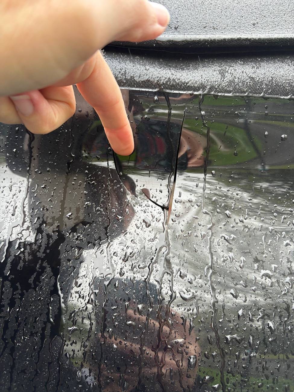

Has anyone else had this happen? The plastic window breaks right where it folds because it was cold?

Plastic gets brittle when it is cold and doesn't fold/roll well. Very common problem on jeep tops. Not sure how common it is on Broncos.

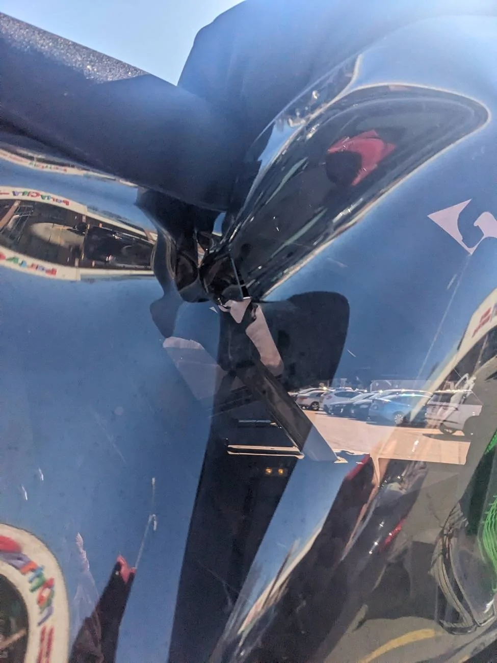

This happened to me in Wyoming with 17 degree weather one night while camping. I had to cut the window out and replace the plastic. We have had so many issues lately that we traded it in for a Wagoneer. You can’t really tell it was replaced. At least the dealer didn’t see it.

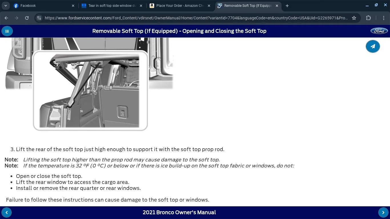

There is a warning in the owners manual to not open the cargo area in cold temperatures. I've done it without issue, but only by making sure the heat inside the vehicle had helped warm the windows a bit. Probably something a dealer or salesperson should mention, especially in northern climates.

I've seen a couple other people post similar. One was able to get a warranty replacement, but don't be surprised if it's denied, since it was February and it is mentioned in the Owner's manual.
