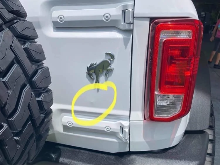

I don't know how this happened, but when the dealership I went to installed the tailgate table on the mannequin, they managed to go in too far with one of the screws. There is a noticeable bulge on the exterior from the screw going too deep or using the wrong screw.
Just a heads up for anyone installing tailgate attachments, check the screw lengths, and don't overtighten!
This was a dealer mannequin back in August..

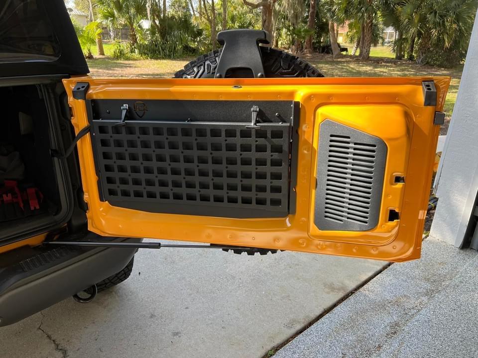

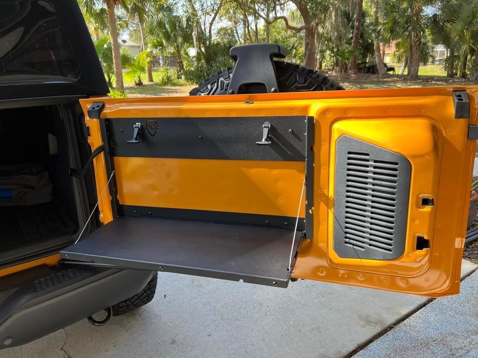

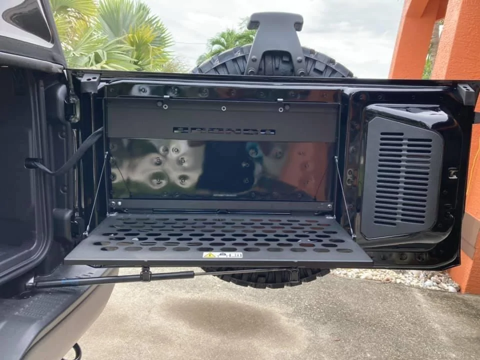

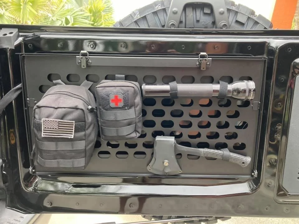

I bought the Ford one a while back before i got my Bronco and before there were other no drill options. I wish I would have waited so i didn’t not have to drill. I’m happy with the outcome though.

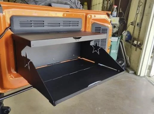

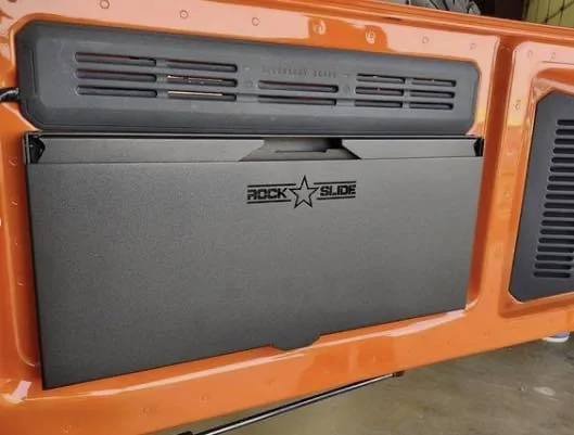

Other options..

It’s not the screws, it’s the drill bit pulled through and poked the outter skin. The bottom left hole has to go through two layers of aluminum and the bit will bite into it and shoot though. The Ford table now includes a bit stop to fix this issue. If you go the Ford route be careful to not over tighten the nut-certs. They are rather fragile.
I went with the Ford table, at the time the only other option was the Rockslide table and that one’s a hard no with the star and branding. I like it, no rattles at all.
Nice setup where did the pouches come from?

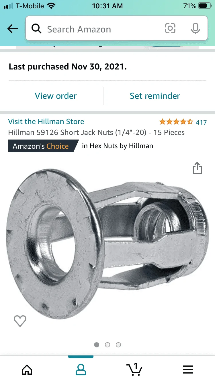

Side note, if you go with the Ford one and planning to run GMRS/CB or any wiring through the tailgate, i would suggest doing that first. Otherwise you will need to remove the table to run wires. And if you strip one of these little guys, you can get them on Amazon or your local Ace…
