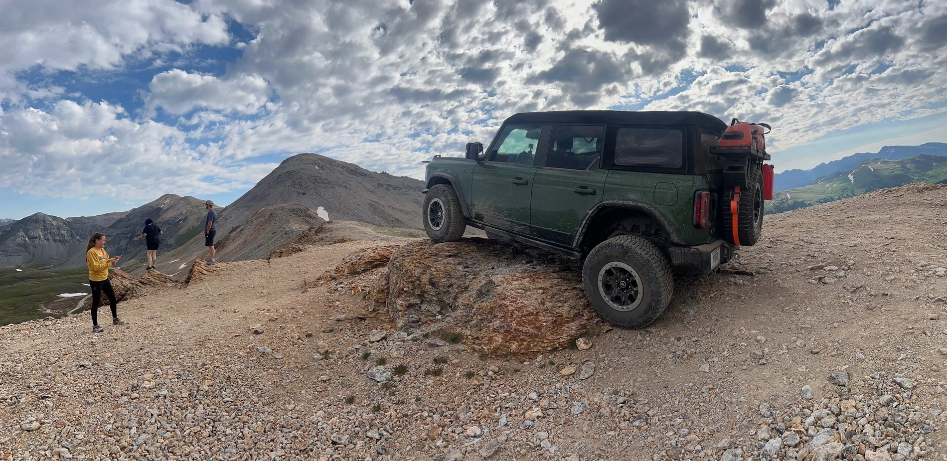

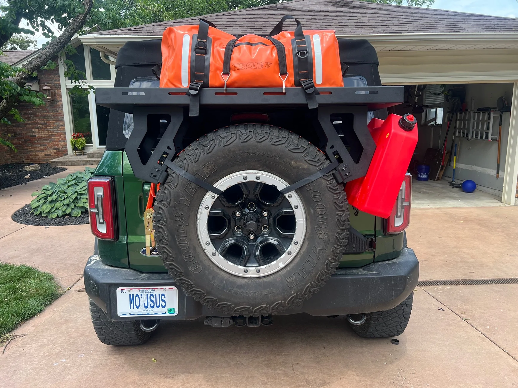

I have the Raptor hinges/reinforcement on my Bronco and put one of those tire attached carriers with my recovery gear and rotopax. It’s pretty heavy.
I wheeled with it in Colorado over the summer and was in and out of my tailgate multiple times. When closing it, I’d have to lift slightly for it to close properly. But with it off, I haven’t seen any issues.

I guess time will tell if it’ll cause long term issues. I plan on going to 37s when my stock Sas tires wear out.
