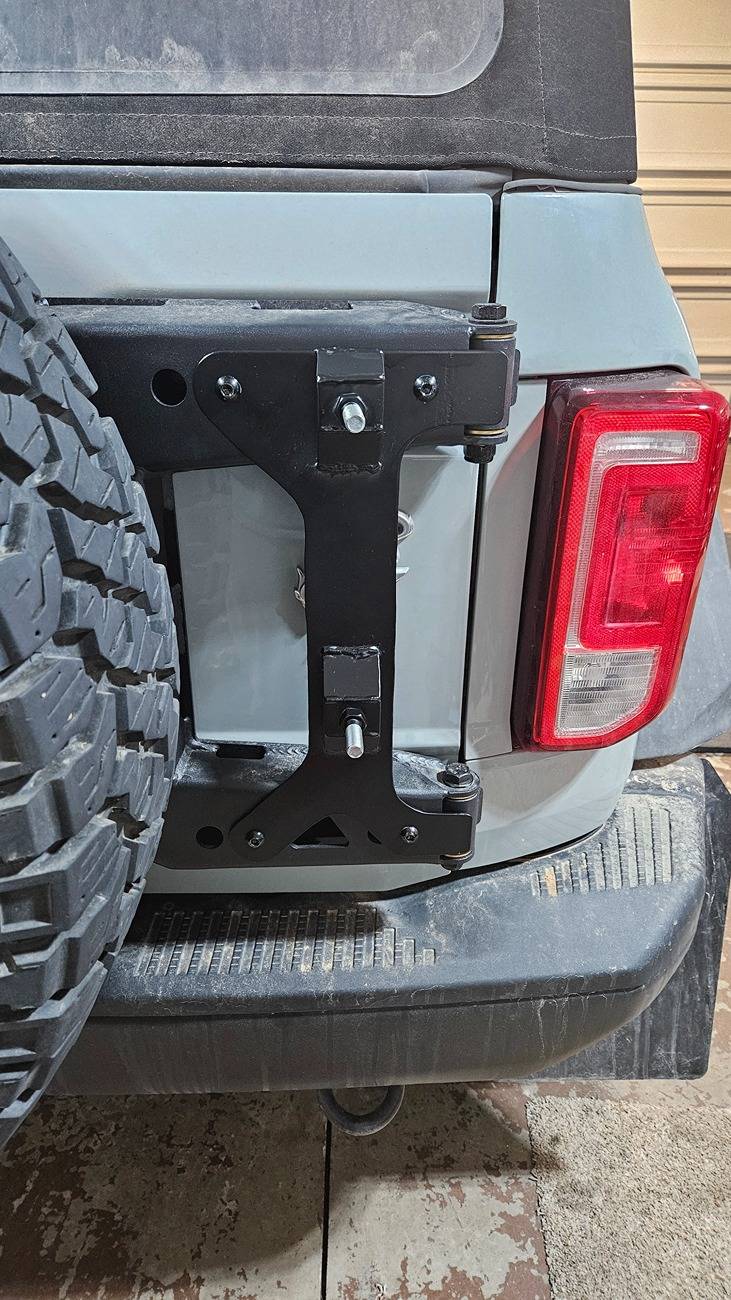

I went with the IAG tailgate reinforcement, it is an all in one package with new hinges attached as well. I also went with 37's but went with take offs from the Braptor. The spare fit, the third brake light did touch the tire so I went ahead and grabbed the Rough Country one and have plenty of clearance now.

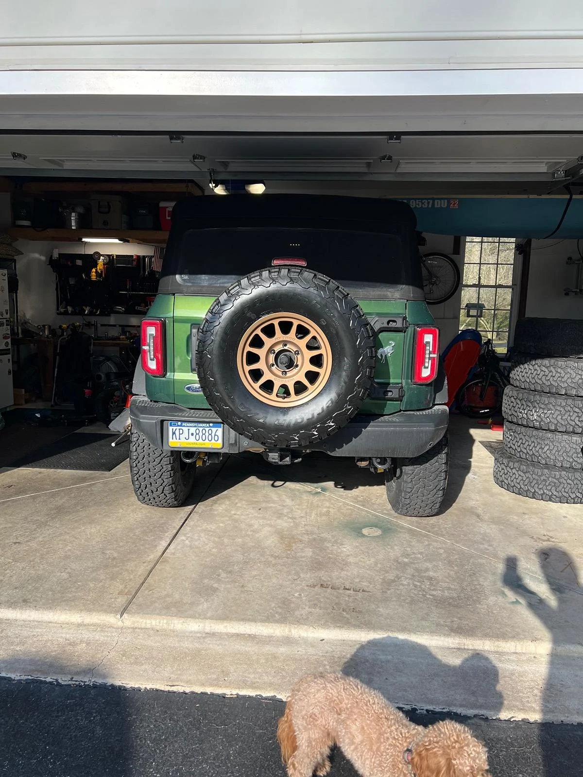

JMacBadlands
Apr 4, 2024
West Chester, PA
2022 Bronco
I am going to be doing a 3'' lift soon and while it's in the shop, I was thinking it would be good time to get the tailgate reinforcement done for when I upgrade to 37's in a couple months. I have a OBX SAS, with stock rear bumper. Not sure if I would need a spare tire relocation at the same time for when I get the 37s? I am trying to more or less future proof for that.
I've seen a few different one's out there and wanted to get peoples feedback and recommendations.
I did the same thing to my badlands non sad. 3” lift upper control arms rear track bar relocation bracket and tailgate reinforcement. I went with the iag X brace and it fit perfectly. Just remember the rear tail light bracket to raise the light. Its solid and replaces the entire hinge so there is now existing weak point. Good luck.

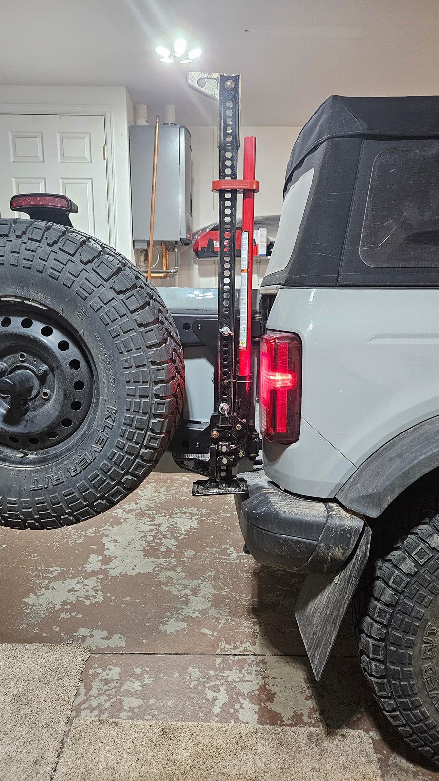

One company makes a tailgate reinforcement that lets you store a hi lift horizontally. Don't remember which one.
RTR I believe.
