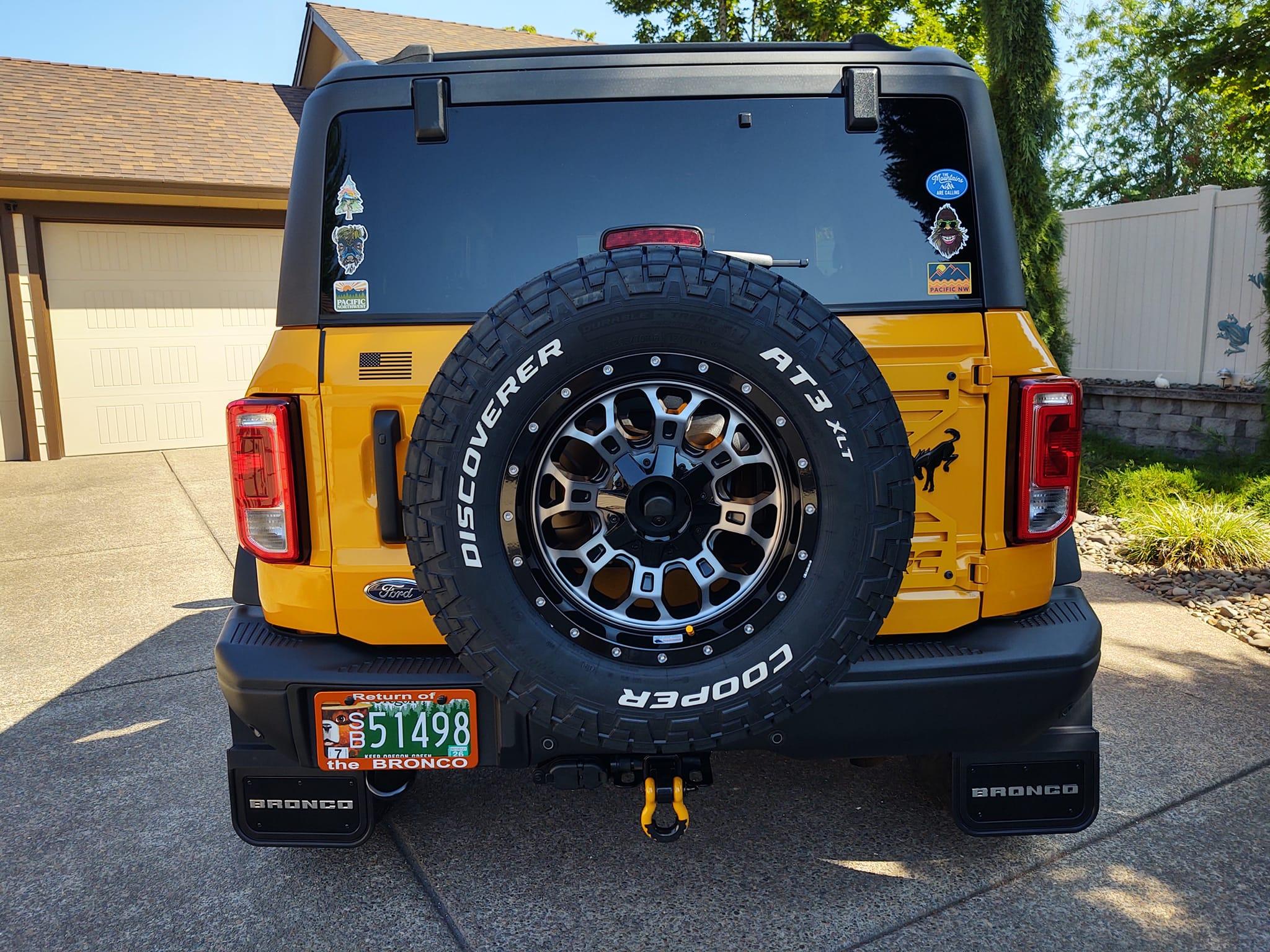

Hi all,
I'm not clear if I need a reinforcement bracket for the spare tire. I'm thinking about getting 18" fuel wheel with Nitto Grappler tire. Do I need to get like a rough country bracket? is that necessary or is the door able to handle the weight?
IMO, a reinforcement is insurance. They are cheap compared to the damage that could be done. I went with a larger wheel and got the RC bracket (I had mine painted. Even if you leave it black, I would still paint it with automotive paint and clear it. Some of these have been said to have rust issues). Easy install and it was well under $200bucks.

Hi all,
I highly recommend it. My 35" covered up the rear brake light, but the rough country tire mount extends the light so it can be seen above the 35" spare tire.
