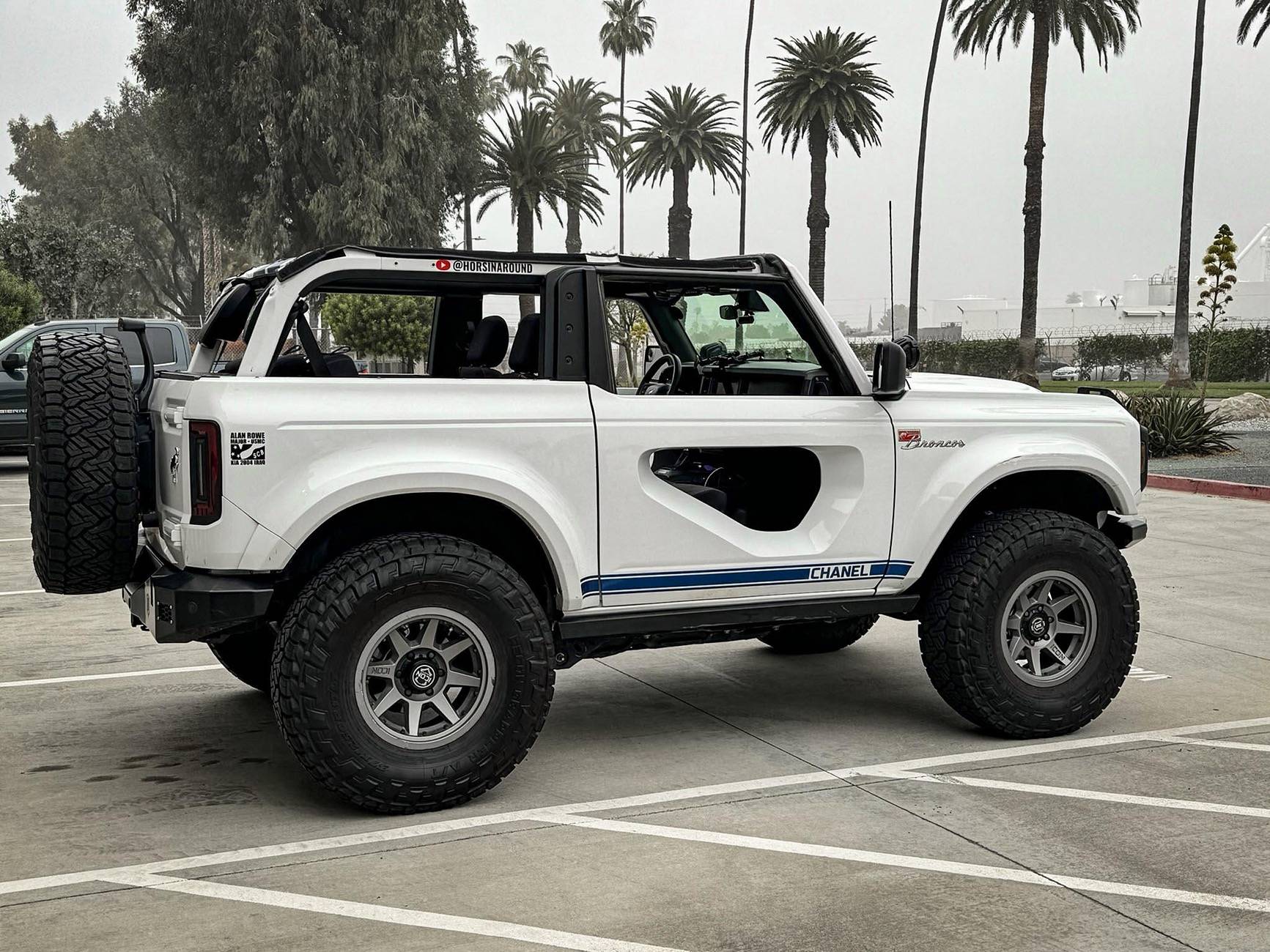

So with bumpers and fender flares, I’m swapping those out because of aesthetics—I just hate the way the OE fenders and bumpers look and I’m looking for an aesthetic as far as fenders and quarters like the build in the attached image. If you can recommend anyone that makes these it would be greatly appreciated because fiberwerx doesn’t have anything like ones I linked.

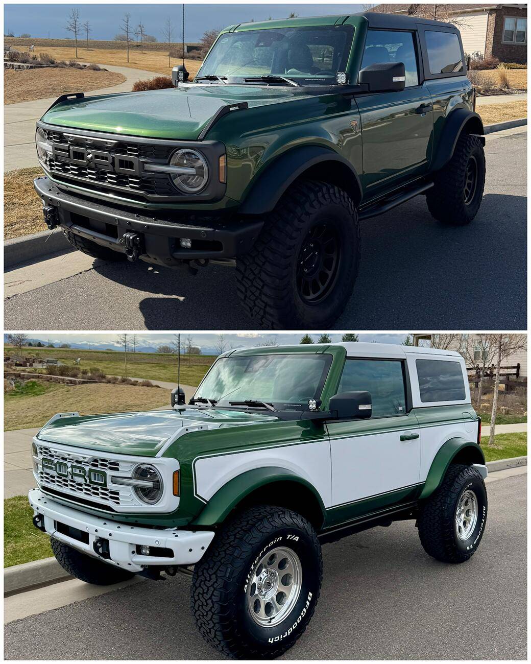

I just completed basically what you are trying to do minus some details, but from a SAS model. Running “37s” on a -12mm offset wheel with eibach coilovers and zone UCAs. While the UCA may not be necessary (I don’t off-road), for the price it seemed like a no-brainer for me. I also did track bar relocate.
before and after
