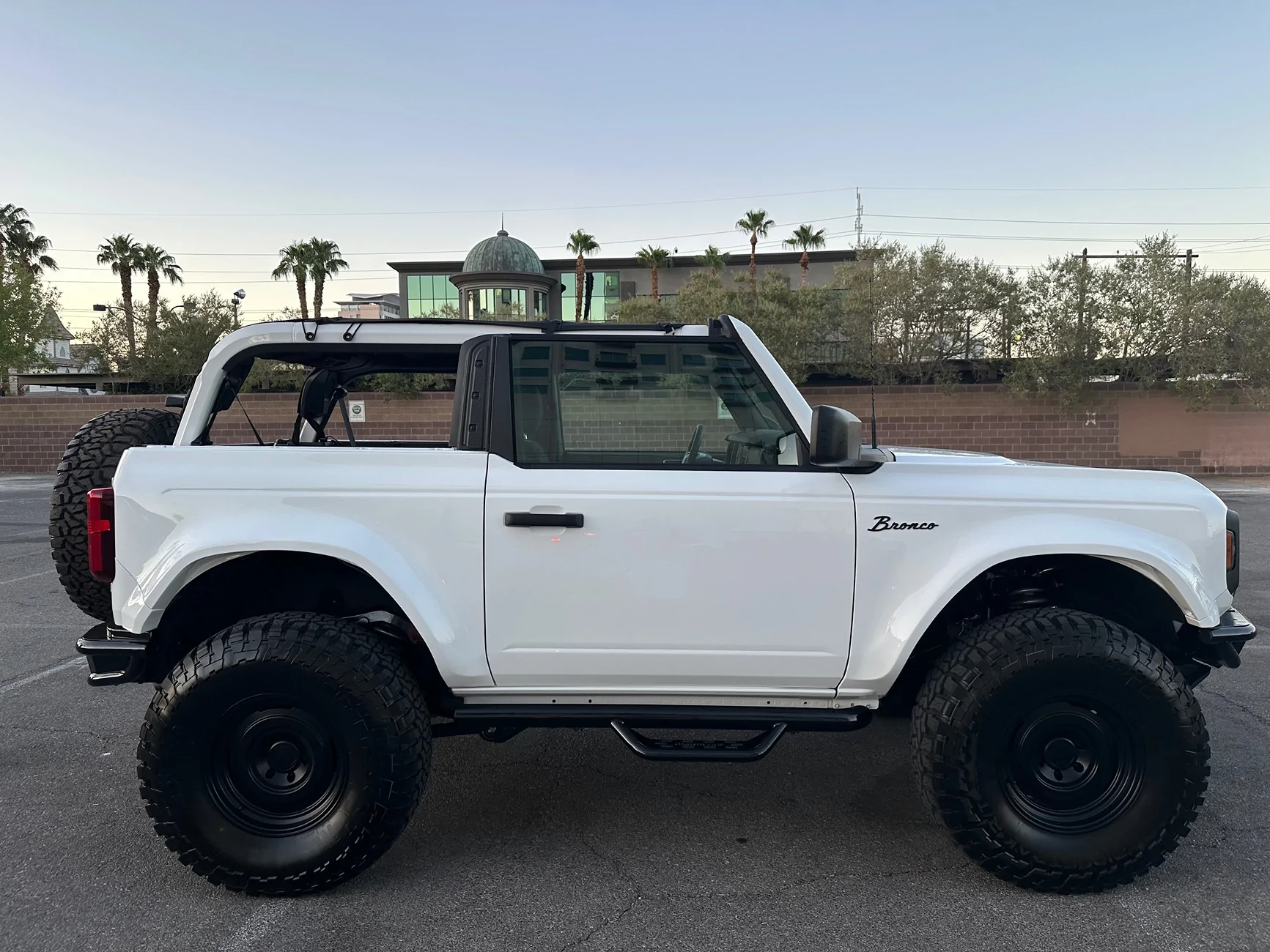

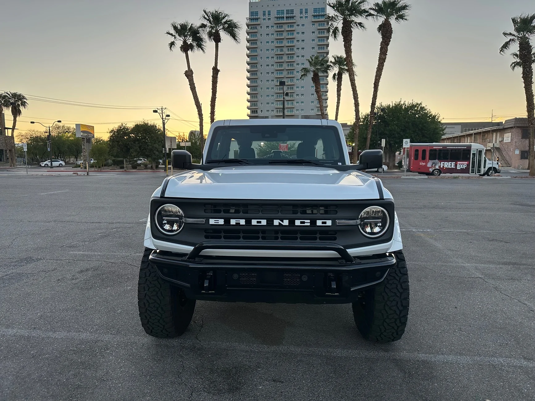

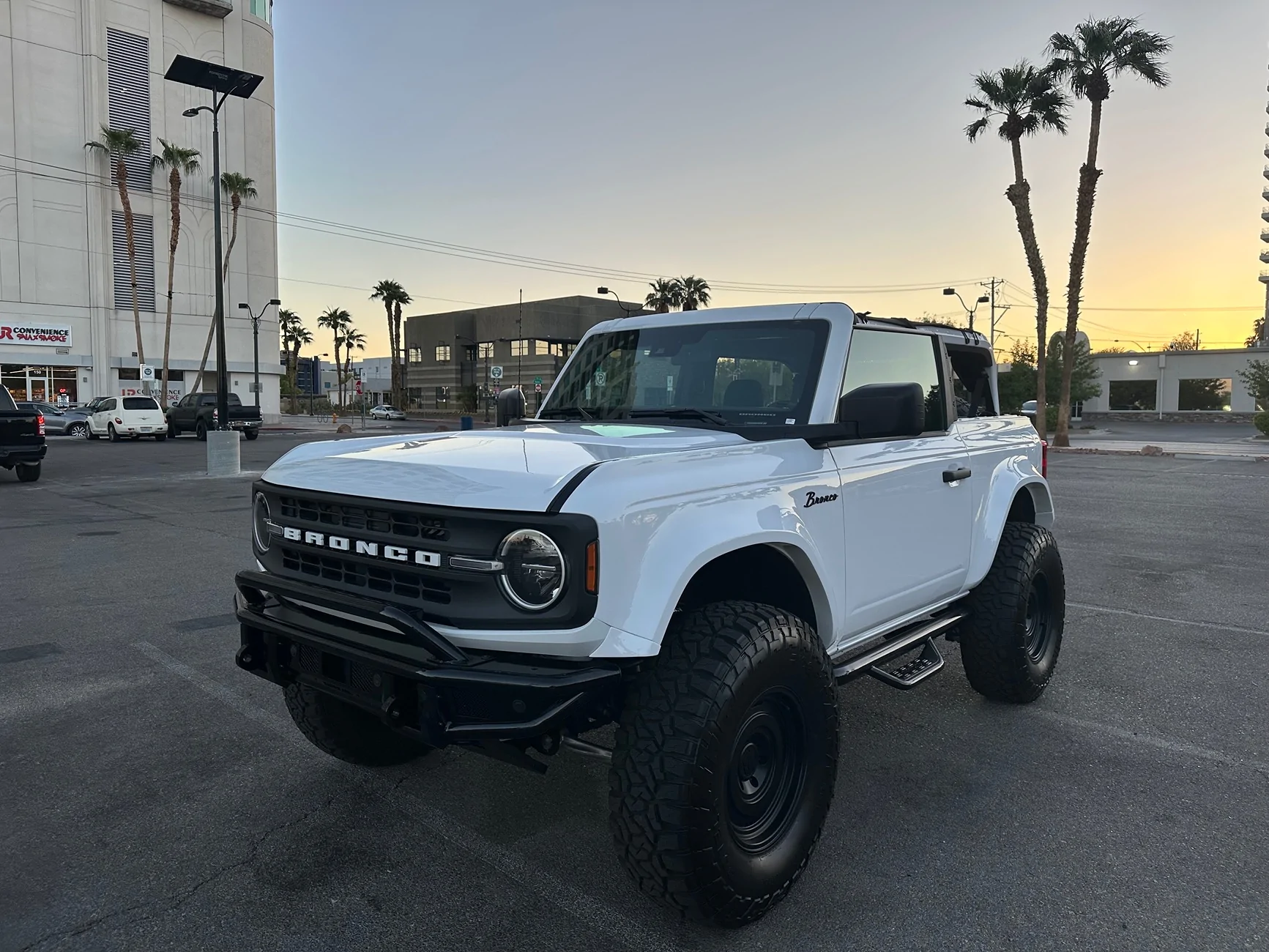

I just completed basically what you are trying to do minus some details, but from a SAS model. Running “37s” on a -12mm offset wheel with eibach coilovers and zone UCAs. While the UCA may not be necessary (I don’t off-road), for the price it seemed like a no-brainer for me. I also did track bar relocate.
before and after
What. A. Fucking. Build. You just absolutely nailed this.
Re: UCAs, my thinking is the exact same. If they're dropping the suspension, might as well throw some in for what they cost. I'm just a little lost on what kind are compatible with what I'm trying to do. I'll likely PM you with a couple questions about this build. Really outstanding.

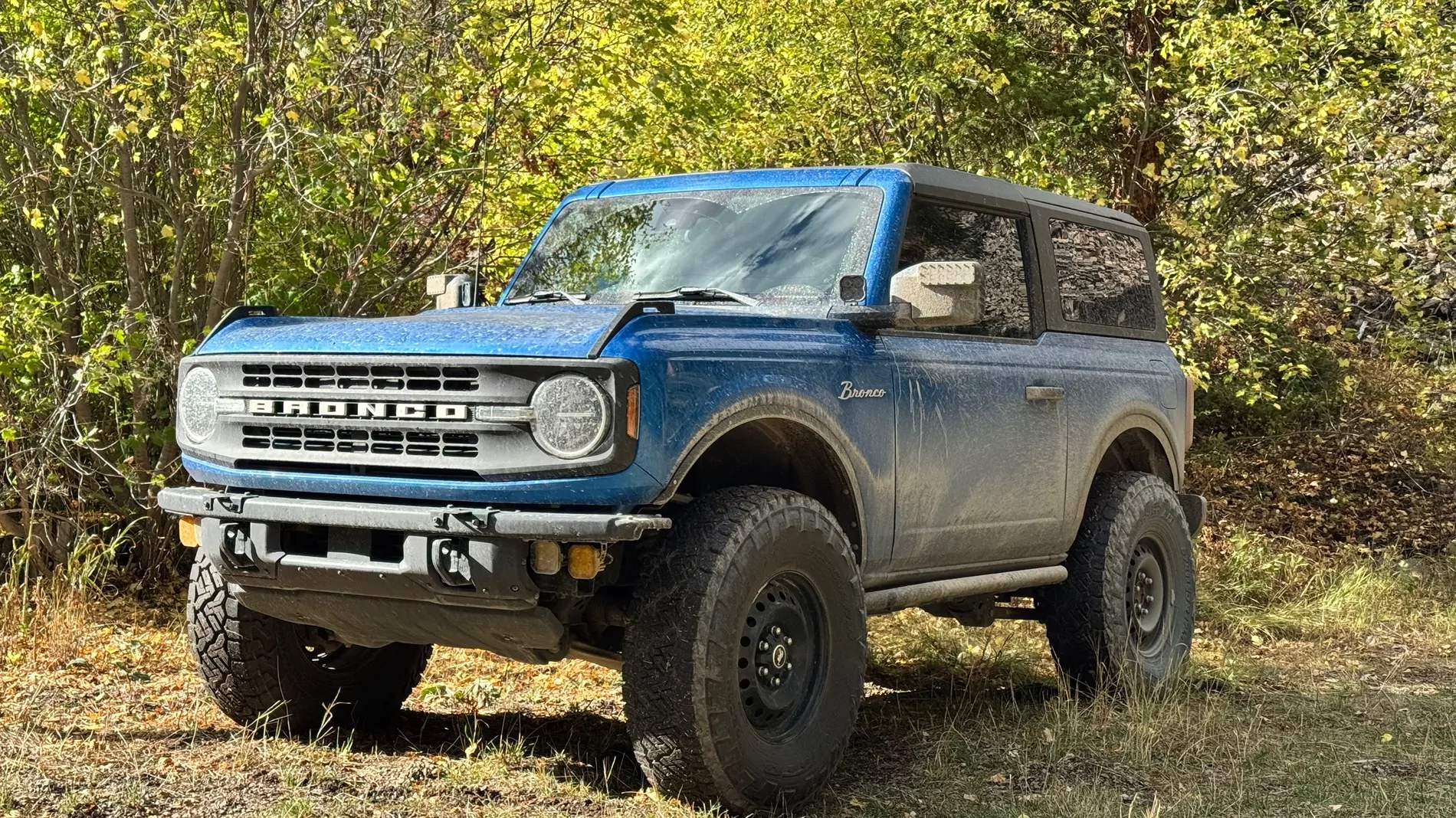

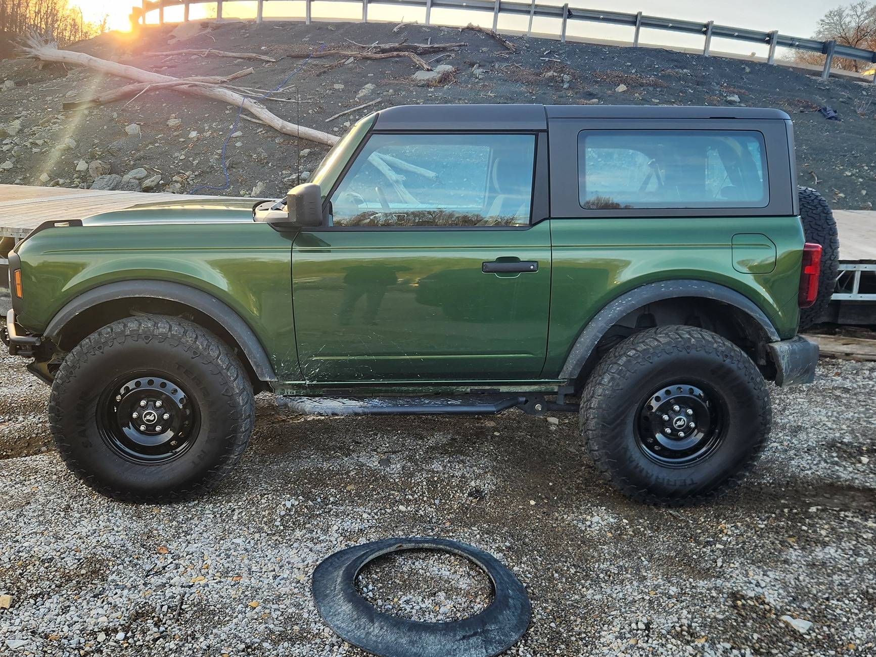

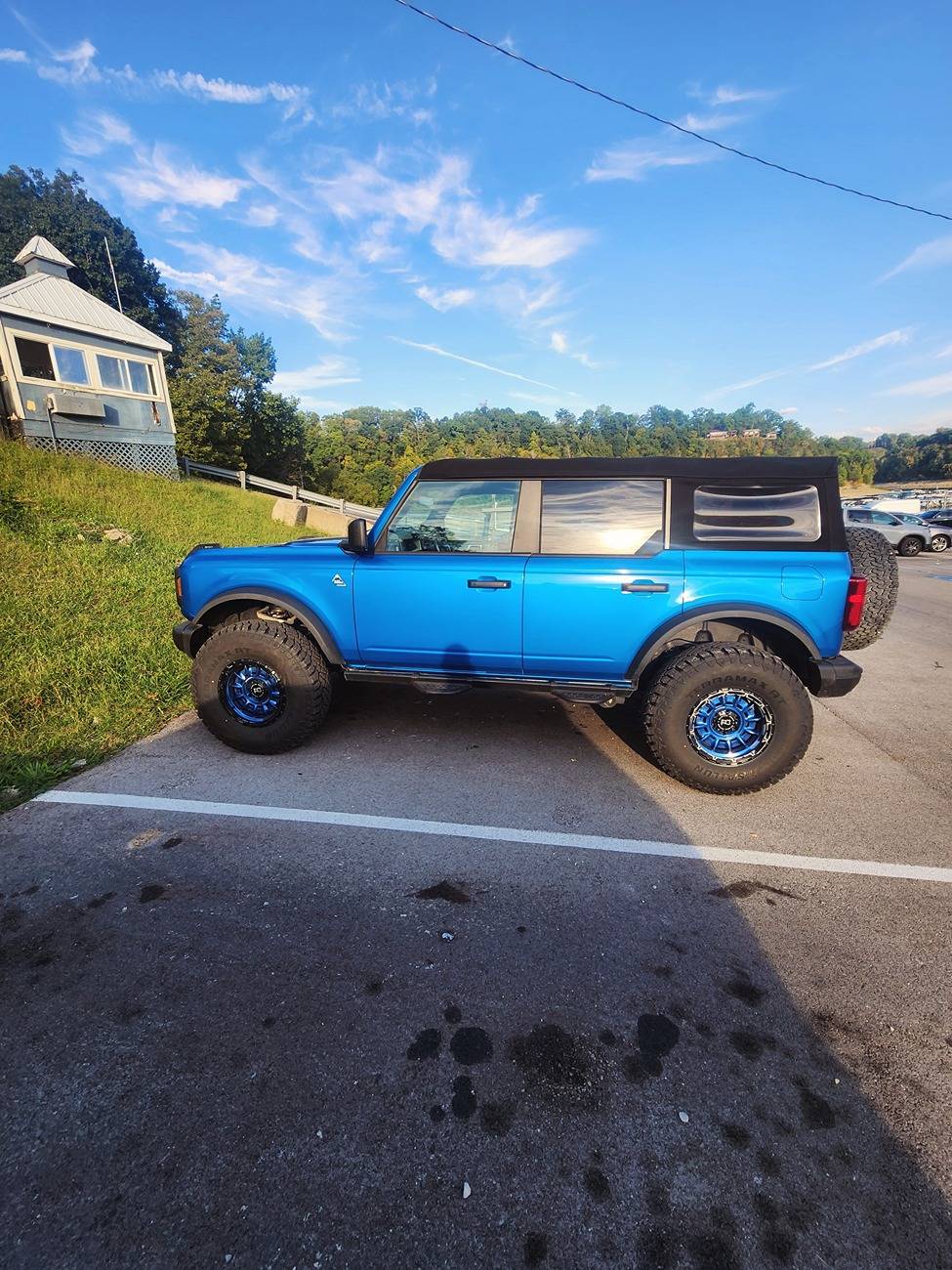

both have 37 green one 2 in rc spacer the blue one 2.5. tires terramax rt the green one haa a 1.5 wheel spacer

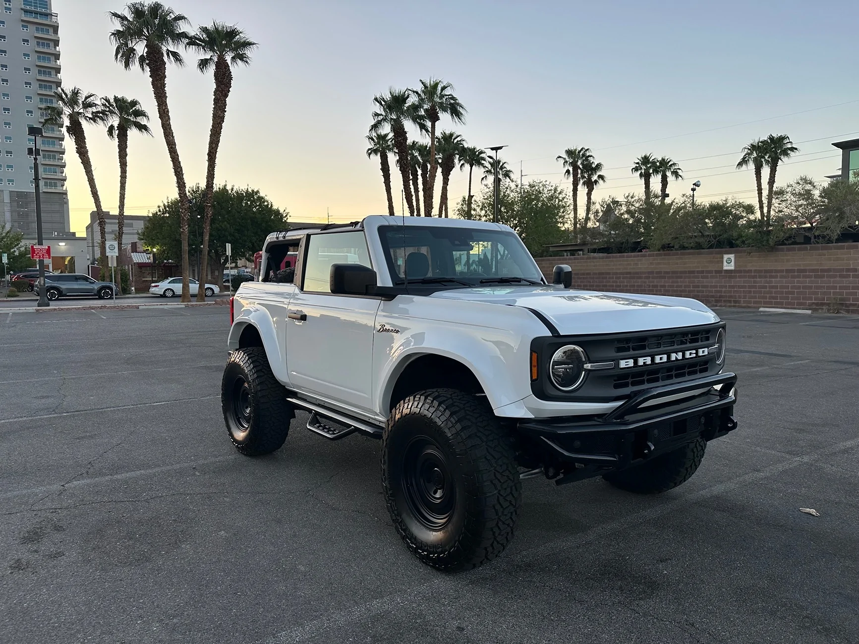

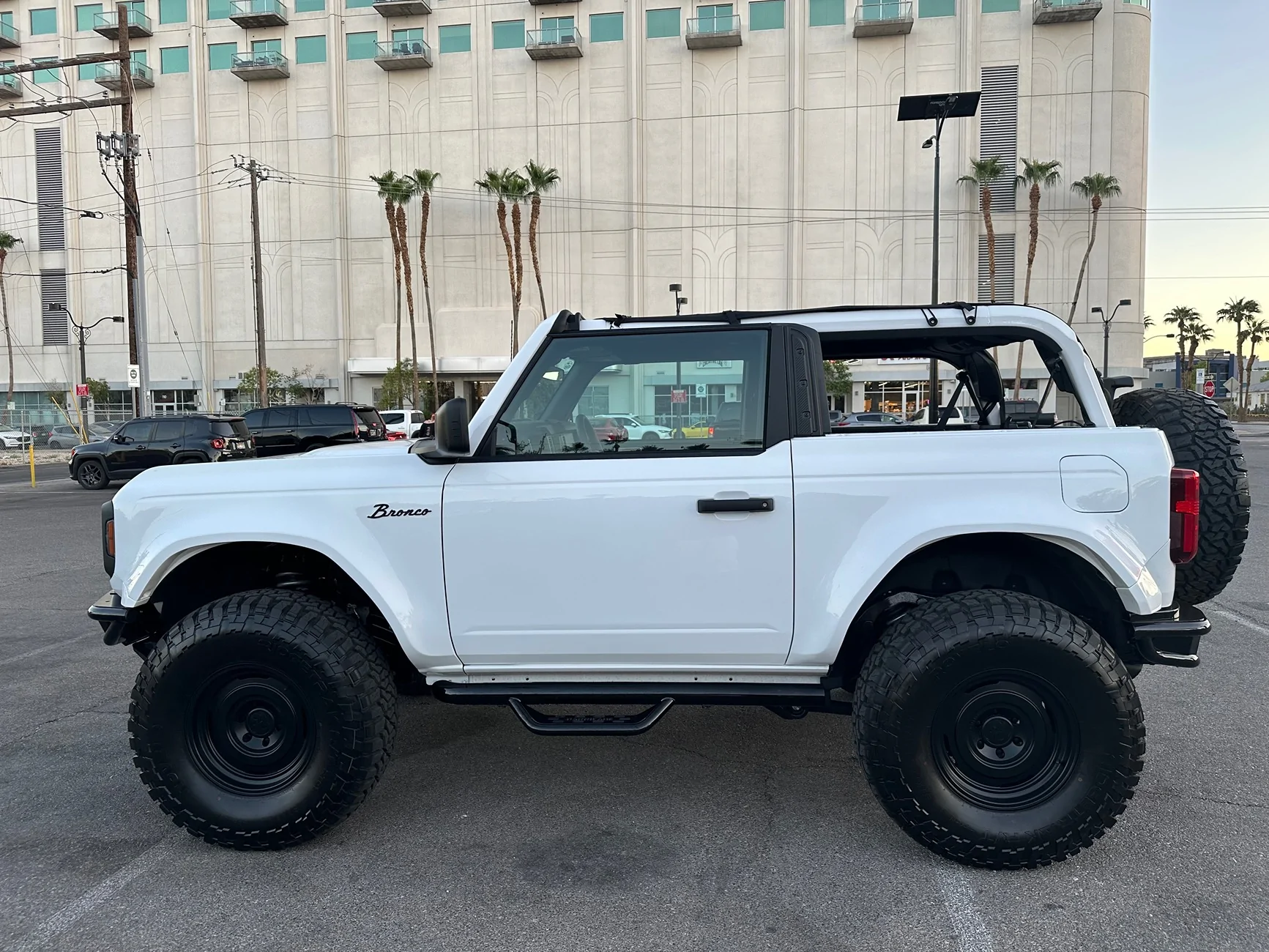

before and after
Question for you. Did you do the JKS (or any other) body mount kit and cut the crash bars?

no just crash bars removed the green one jas a 2in rc lift with 1.5 wheel spacer the blue one 2.5 lift wheels -12 offset the tires 37 12.5 but they run skinny that why i dont touch of rub . tires terramax rt

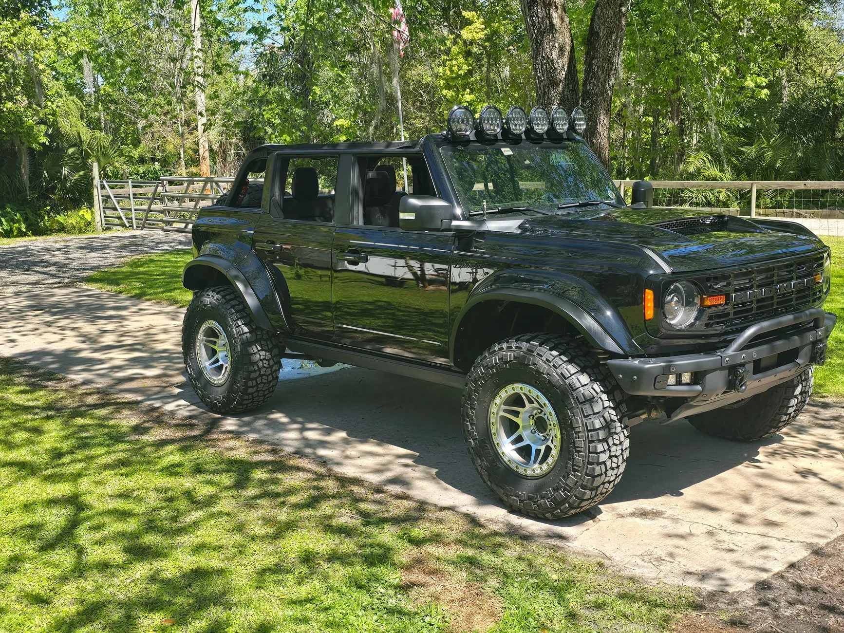

I went with the 8" fenders . Love how they changed the look so much
Ford Bronco Suspension Help for 37" Tires 20250311_141055

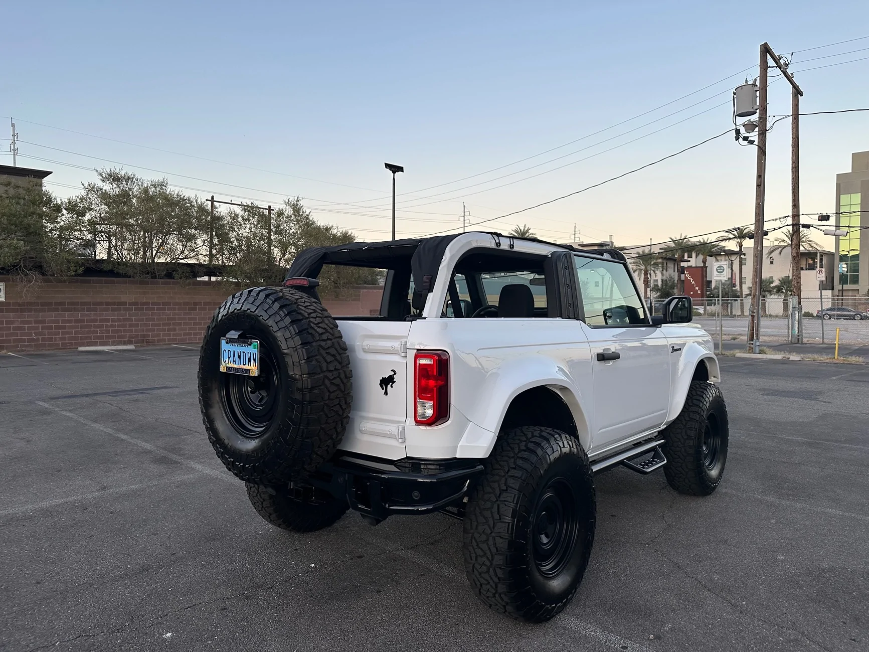

I've got ICON coilovers with stock black diamond steelies, no spacers and 37s. No issues.
Not as pretty a route, but it works.
Ford Bronco Suspension Help for 37" Tires IMG_0636
