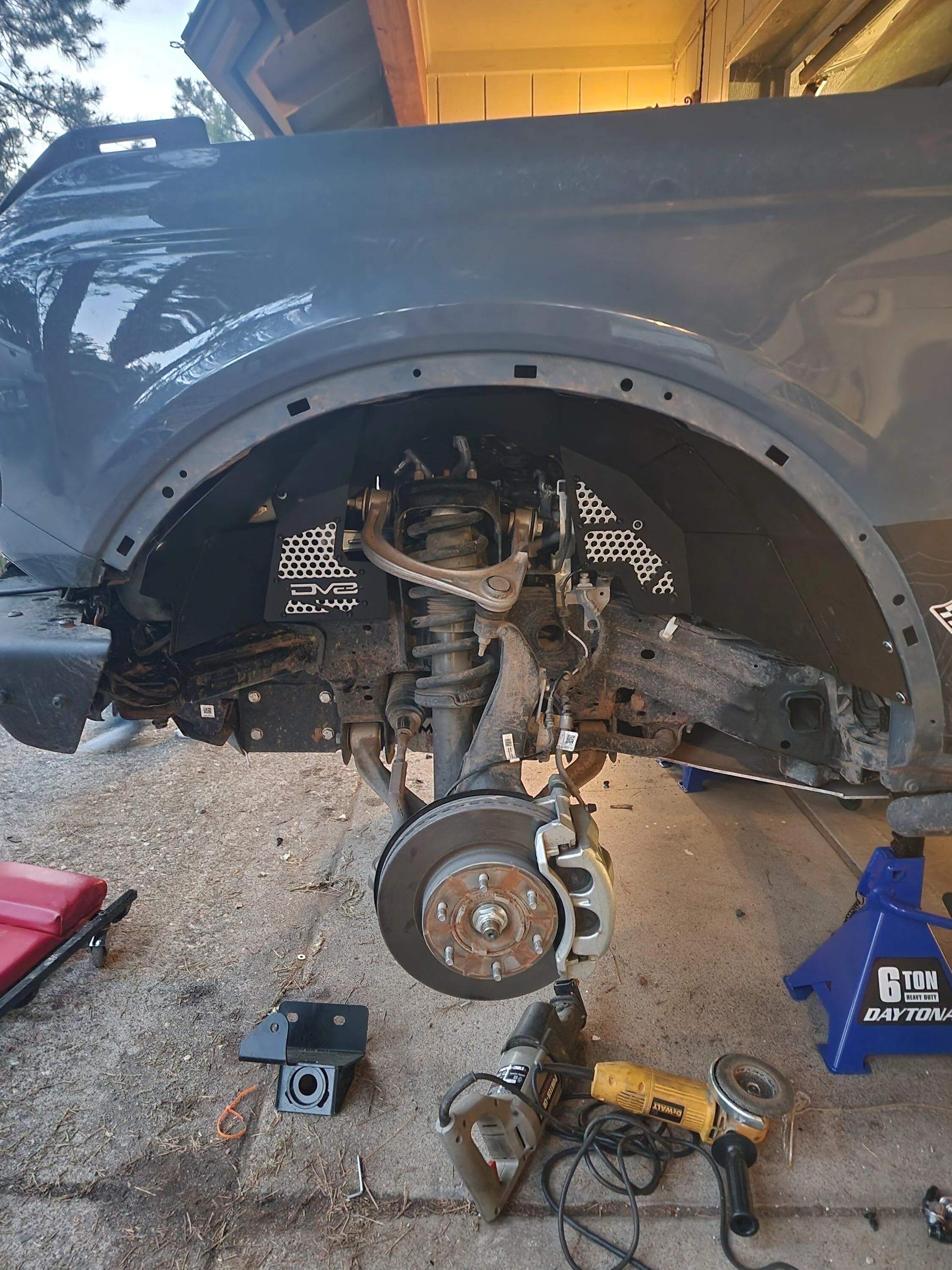

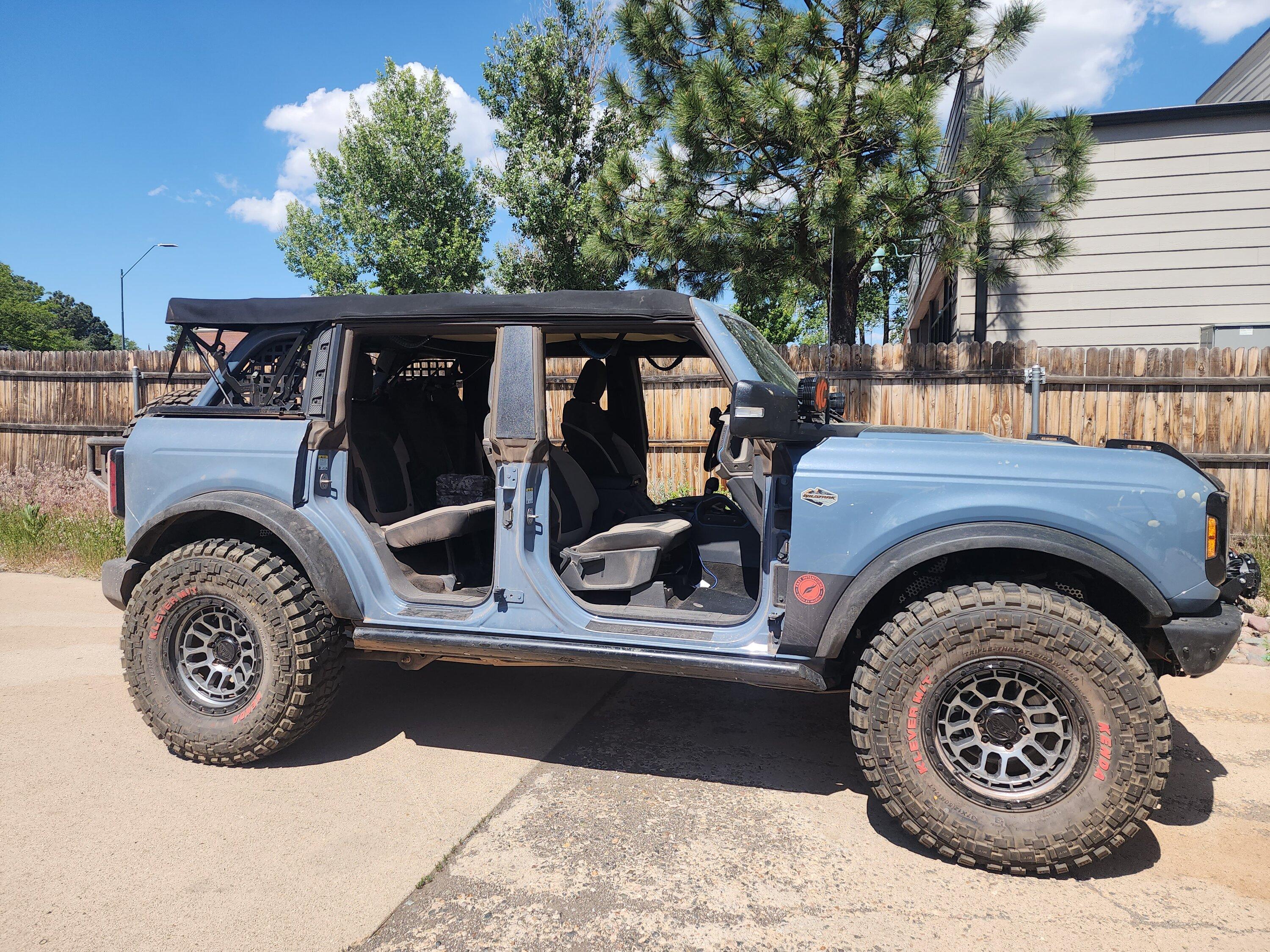

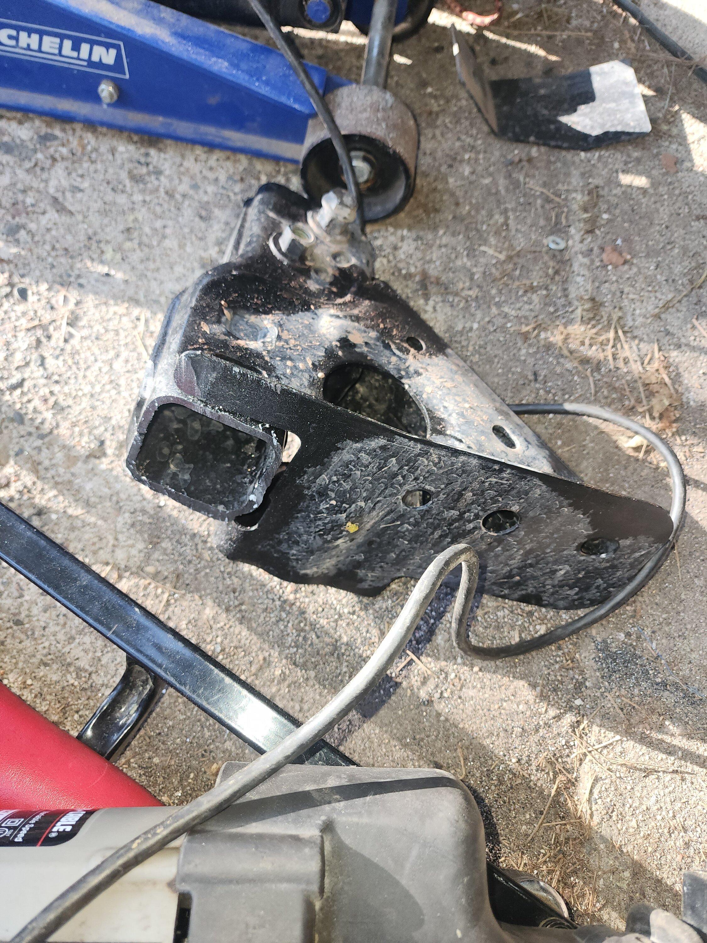

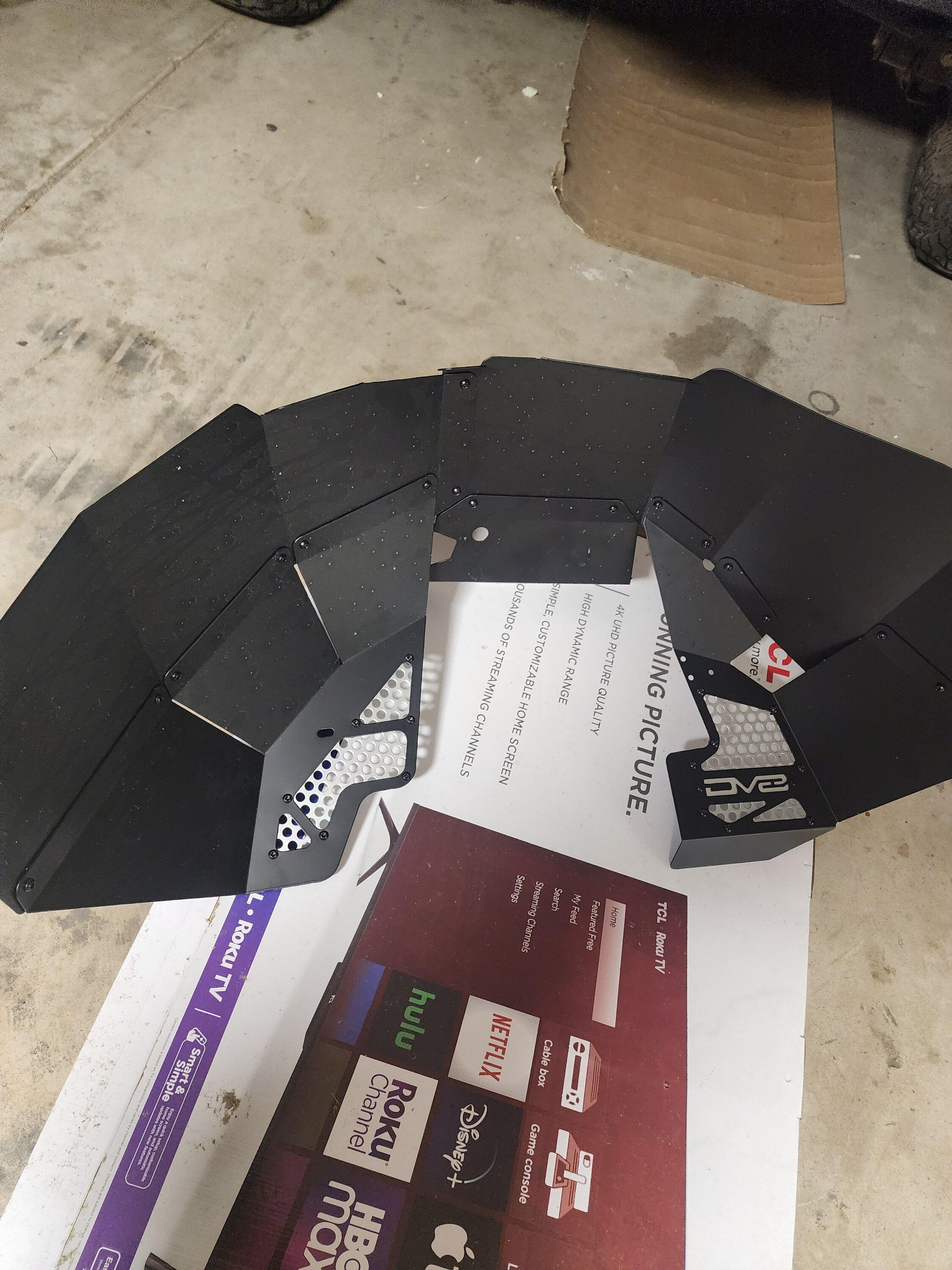

I went a slightly different route with mixed results.
HOSS 3.0 w/ mod bumper & hidden winch (nose heavy)
JCR Tire clearance kit
DV8 Wheel wells all the way around
0 degree offset wheels.
1 1/2" Foutz perch collar on front only (leveled it out)
No other modifications to the rear.
The DV8 kit helped allot and the JCR one also made considerable room in a different way.
So far still has minor rub on the forward inside of front wheel well during spicier driving /turns.
I thought the bigger wheel well and small perch would be 100% perfect, and it isn't bad at all, but it fell just short of what I wanted.
