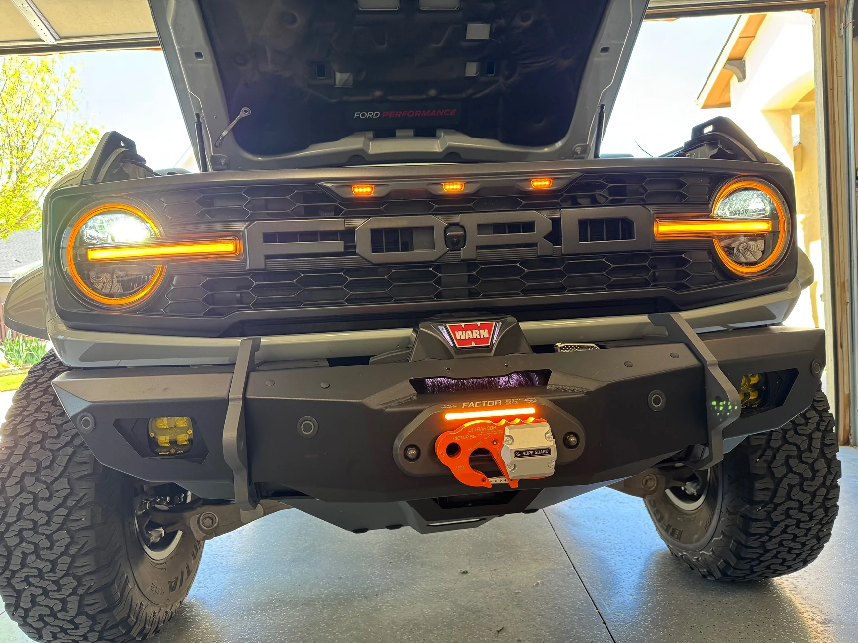

I know its been a while but finally in a position to work on this. Did you buy the lights individually and link them? How did you mount the bumper lights?

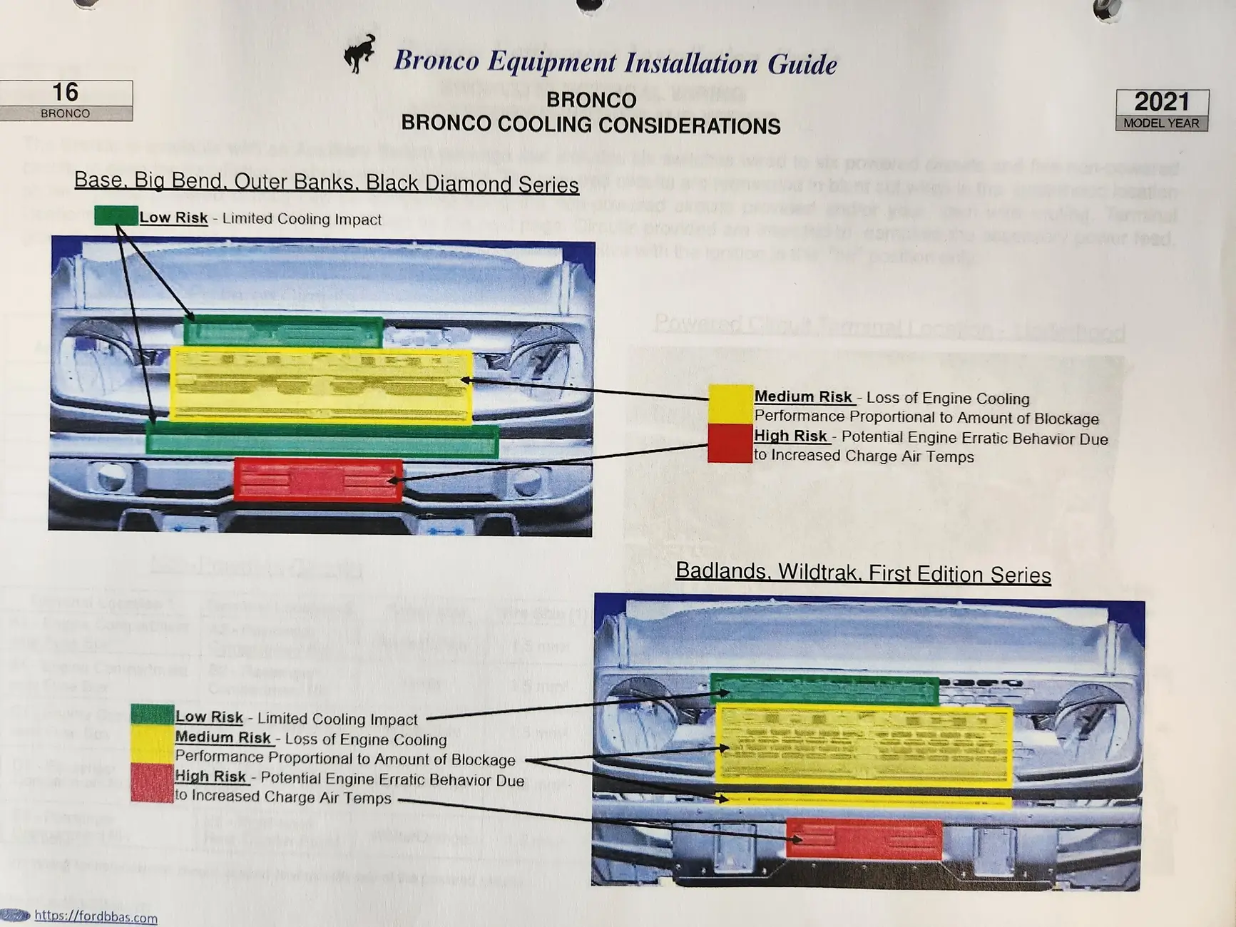

Bumper lights can affect cooling on the Braptor...
I think that is pure speculation and most likely false. Any data?
Similarly are you not worried about the significant radiator "blockage" from your bull bar?

This was circulated around a while ago
I don't worry about it one bit.
Thanks, hadn't seen that.
There's certainly an element of CYA going on there. They have to cover cases of numbskulls covering 80%+ of those areas and hugely interrupting air flow.
Also, they certainly put a lot of accessory mounting points on the bumper. That's somewhat contradictory...
Agreed - they have to cover the worst-case scenarios
The challenge on our last outing was that a few folks had overheating problems with fully loaded rigs, restricted cooling, and crawling through mountains on a 100-degree day. If you are not going to push to the extreme, I think most will be fine with a couple of lights or a bar.
Interesting case. Just engine coolant temps too high? How high exactly? Raptor or non-Raptor? I think the highest I've seen in my Raptor is about 218 °F
Only the 2.3 was suffering, don’t know how high , but it triggered the unhappy noises from the dash
