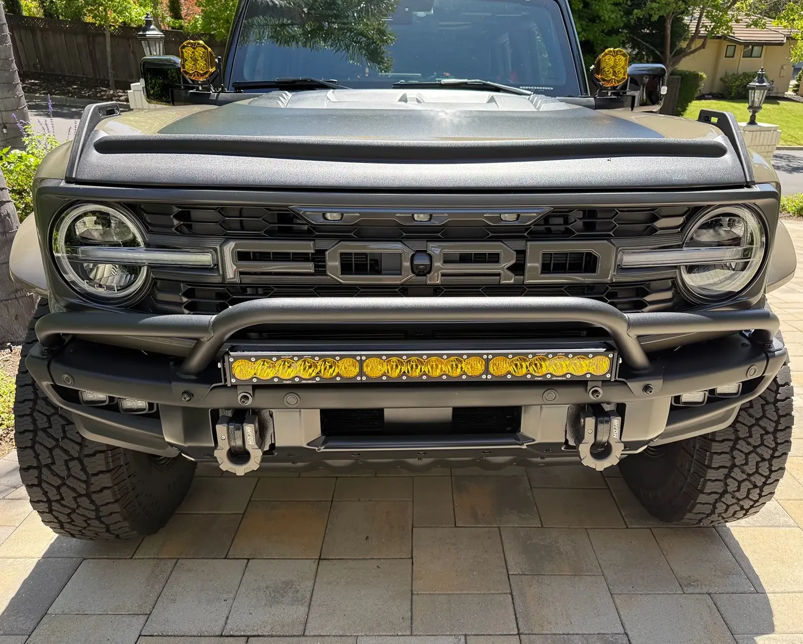

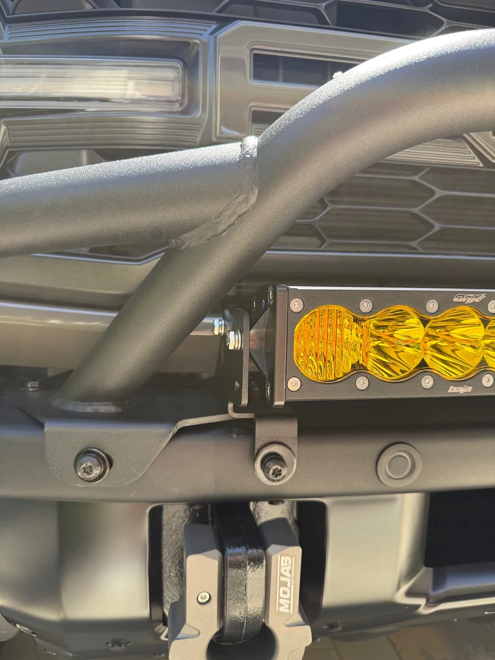

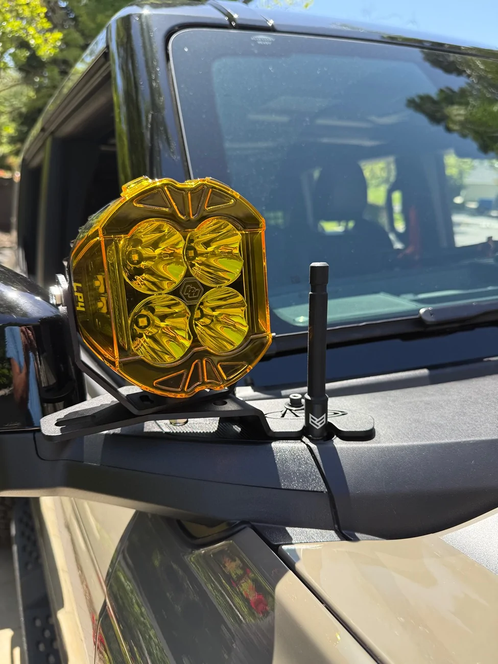

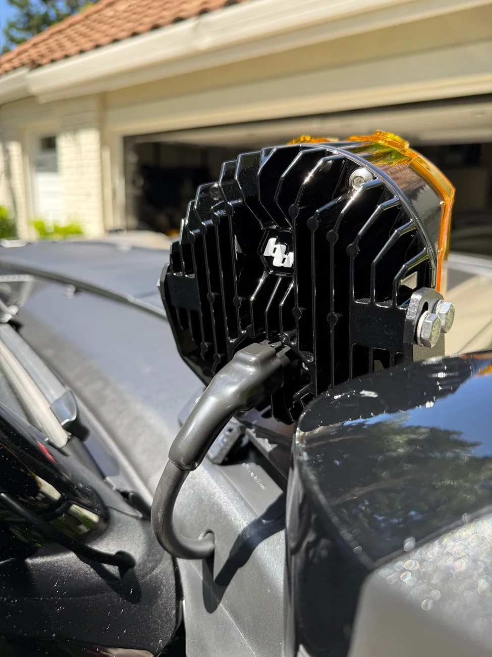

Finished up Baja Design lighting on the front bumper and a-pillar. Used LP4 spots on the a-pillar with amber covers when needed. I used ADD a-pillar brackets - super sturdy and push the LP4 forward a bit in front of the side mirrors. I didn’t like the way the plastic windshield and mirror fascia gets sandwiched between the a-pillar mount and the cast threaded mounts beneath them - drilled out the plastic parts and installed 1/2” diameter, 1/4” thick M6 hole aluminum spacers for a solid bolt up. I ran the a-pillar harness through the mirror plastic cap instead of through the gap along the windshield, thick heat shrink for robustness and Deutsch rubber boots from Digikey to protect the rear LP4 plugs. I used the ONX6+ 30” drive combo light bar in amber with Grimm mounting brackets that worked with my Turn Off Road brush bar. The front slots of the Grimm bracket had to be opened up since the rear bracket mounts on top of the TOR bar flange.

I really like the light bar on the front. I'm always happy I have the winch because I'm usually out solo but that light bar looks better imo - great work.

Great look. Quick question... do you D-Shackle rattle and / or make noise?

They do not. The Mojabs happen to be a tight dimensional fit and used a rubber mallet to slightly tap them on. The rotate fine. There are no rubber spaces between the shackle and bumper mount. The Moab main 3/4” pin is held in place with a clip ring so not easy for someone to remove by just screwing off.

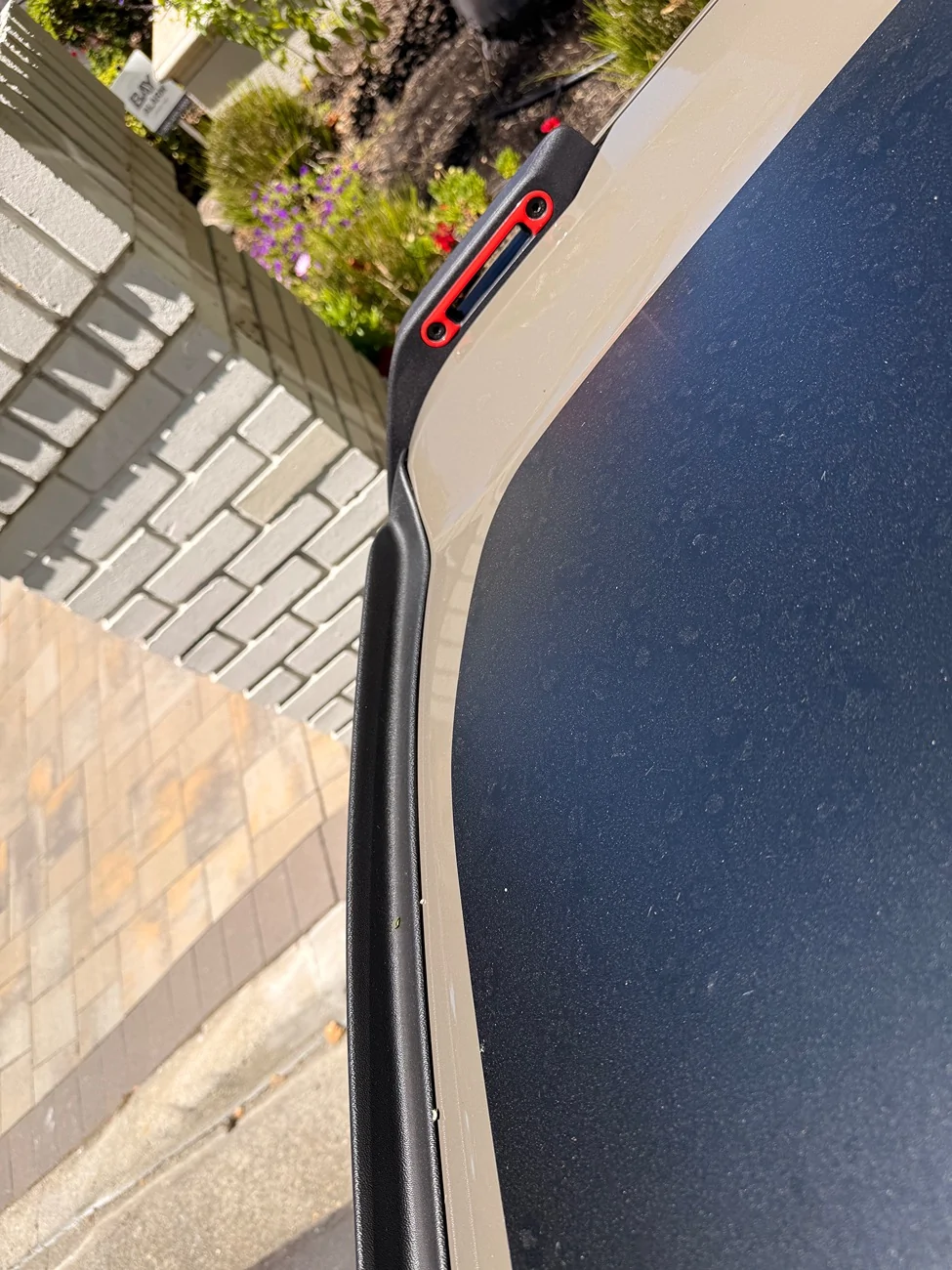

That looks great. Quick question—did you find a hood deflector that’s actually made for the Raptor, or did you have to modify one from a standard Bronco to get it to fit? I’ve been looking for one and haven’t found many Raptor-specific options.

I used the Husky version 2 for regular bronco and the shop that did my PPF used a heat gun to mild it to the Raptor hood profile. Fits perfect.
