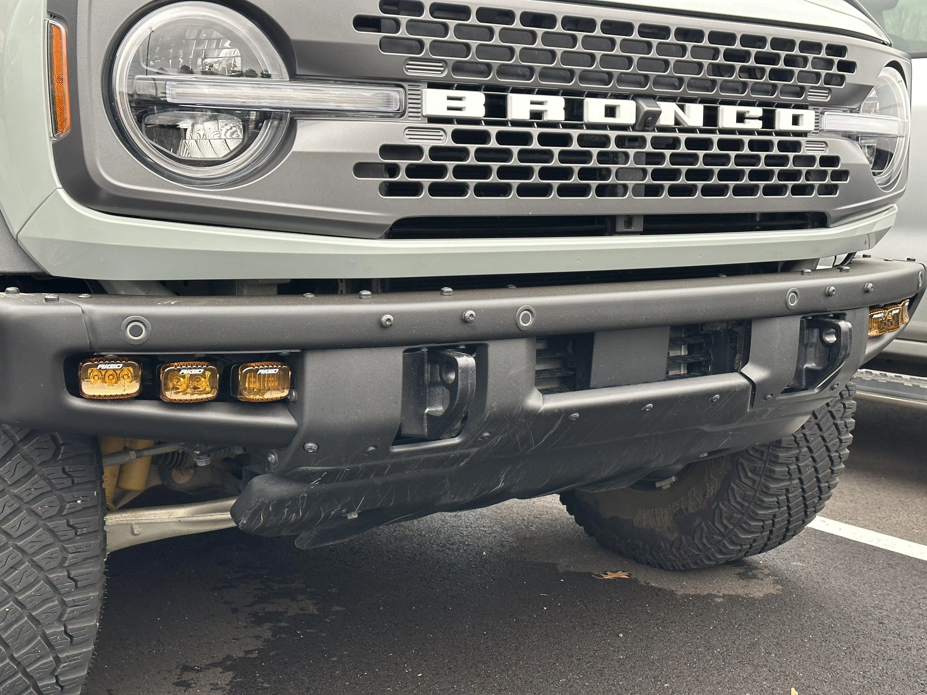

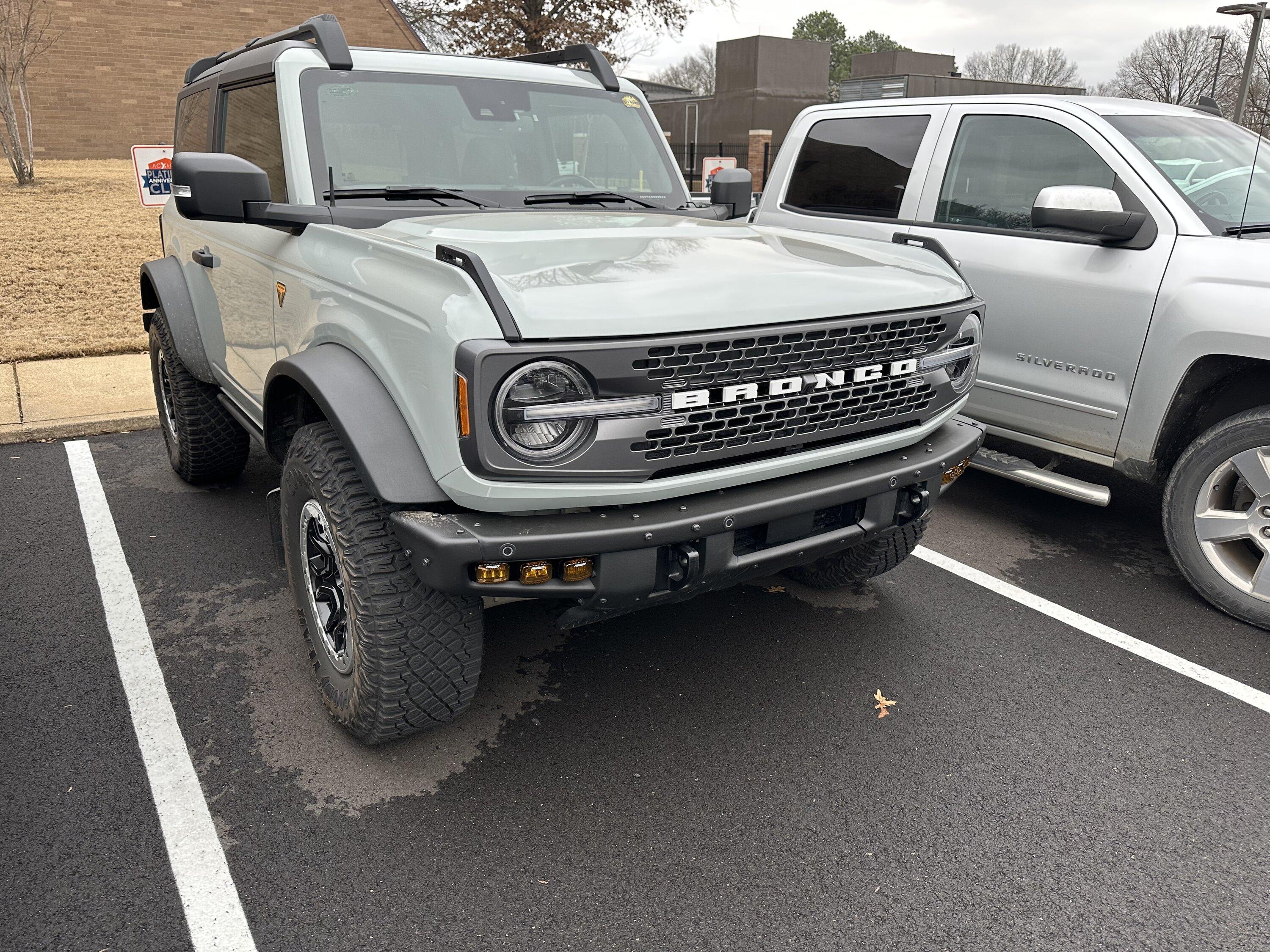

Rigid has a kit for those of us that wish we had a Raptor. I just installed it on mine. The SAE fogs are connected to an OEM headlight switch with the fog light button and the other four are connected to AUX6.
That’s a nice look
