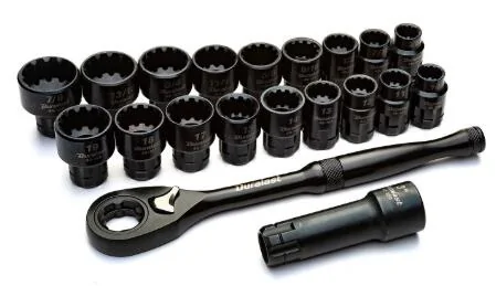

wonder why this part says it won't fit a Bronco?
Where does it say that?
Edit: Oh I see, on the ford accessories page.
It’s likely because they don’t let you narrow down the model further, and it will not fit a Bronco Raptor.
These will fit a regular Bronco though, just like the FP listing says.

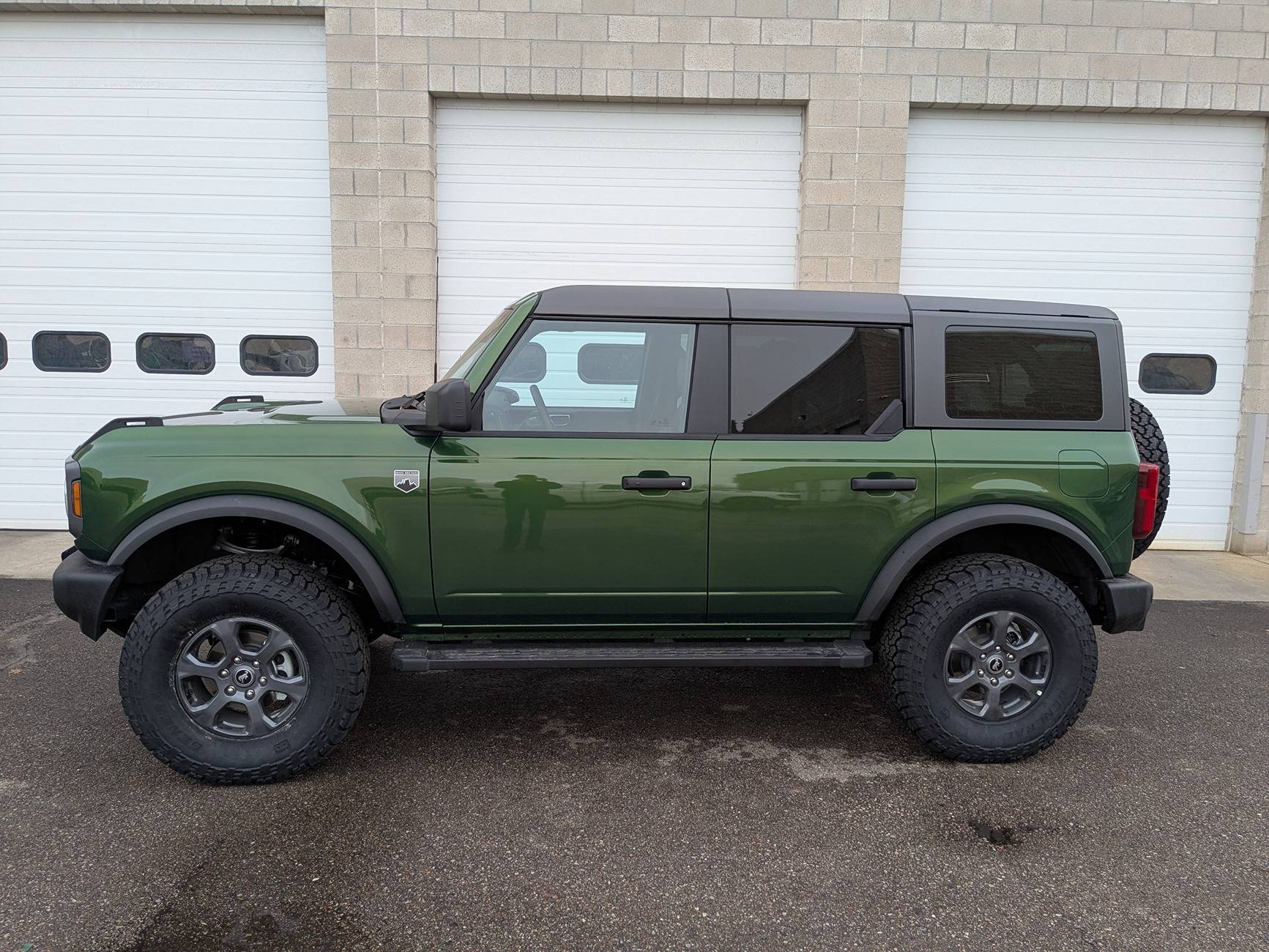

Well after the help from a friend it is finished. Love the outcome. Loosened the UCA, Sway Bar End Links, and Outer Tie Rods and made it to where the knuckle could be moved to the side and used pry bars on the LCAs to get it on. Wasn't easy but it went in.

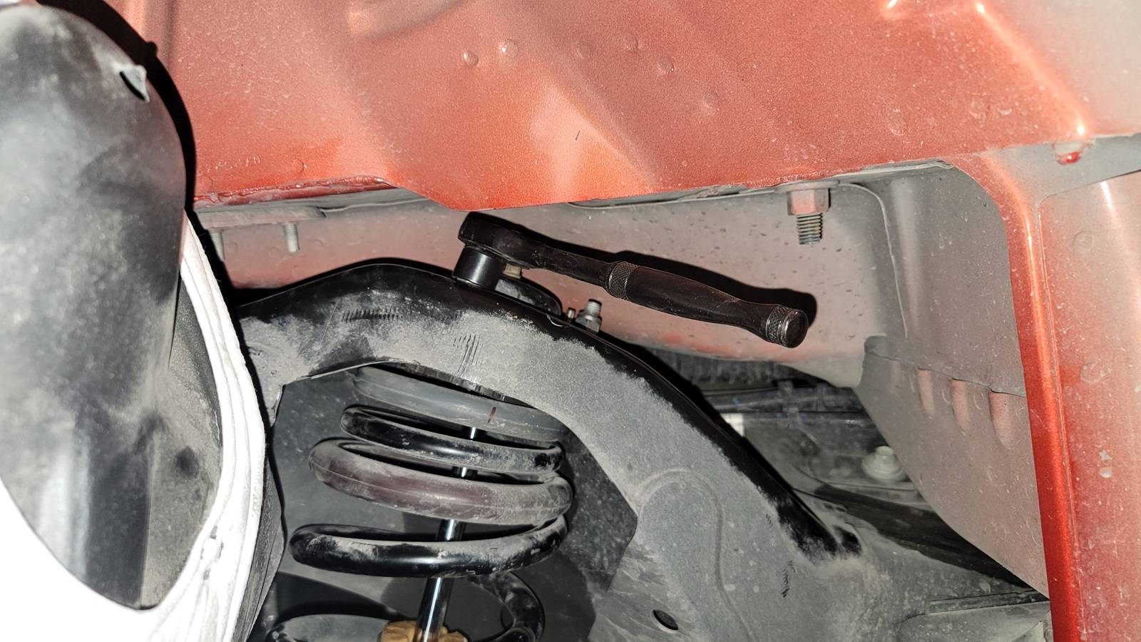

Pass-through ratchet is a big time saver, reaching the top nuts. You will need it for the strut top nut and swaybar links, if taking them apart. You don't have to remove the fender liner.
