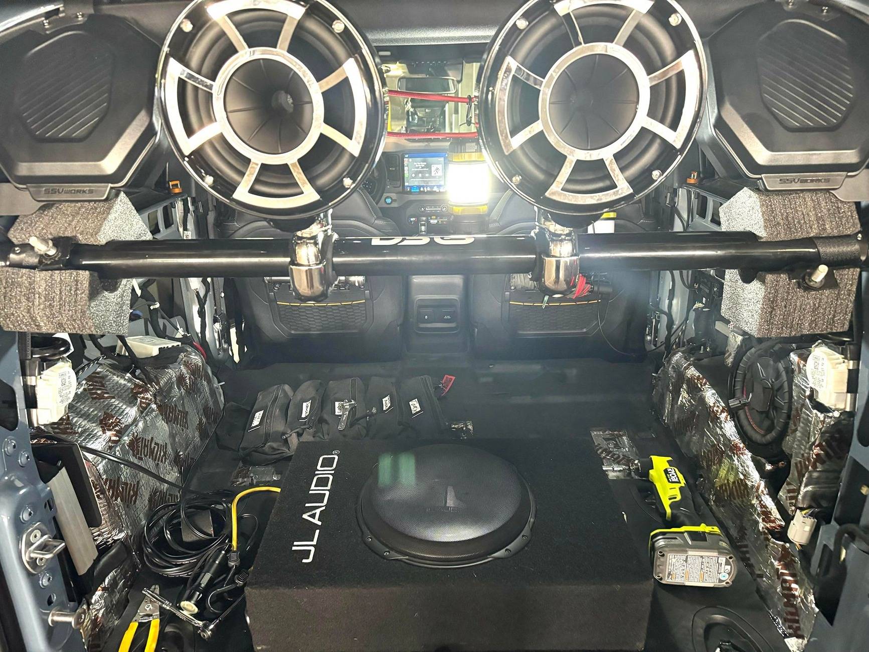

I did a rip / replace of my entire B&O system - this is what I used:
Bronco Speaker Setup:
DSP: Mobridge DSP Plug n Play kit - 2300watts/8.1 channels
JL 500.1 Monoblock Amp: 500 watts @ 2 Ohms for JL 12'' Sub.
FRONT:
2 x 4’’ Morel Tempo Ultra Integra 402 MKII - (60 watt rms 140peak)
2 x 6.5’’ Morel Tempo Ultra Integra 602 MKII - (120watt RMS, 220W peak)
Rear:
2 x SSV 2BR-65A pods (60 watts rms, 120watts peak)
2 x Wet Sounds Rev8 (200 watt RMS / 400 watt peak)
Subwoofer:
Kicker 8'' CompR (300watt RMS / 600 watt peak) (stock location)
JL Audio 12'' (external box) run by JL 500.1 Monoblock Amp - 500 watts @ 2ohms

I might swap out the JL box for ported 2x12'' setup, but I'd probably need to upgrade the amp to the JL 1000.1 to really make 'em sing.....plus the box would take up a ton of space.
