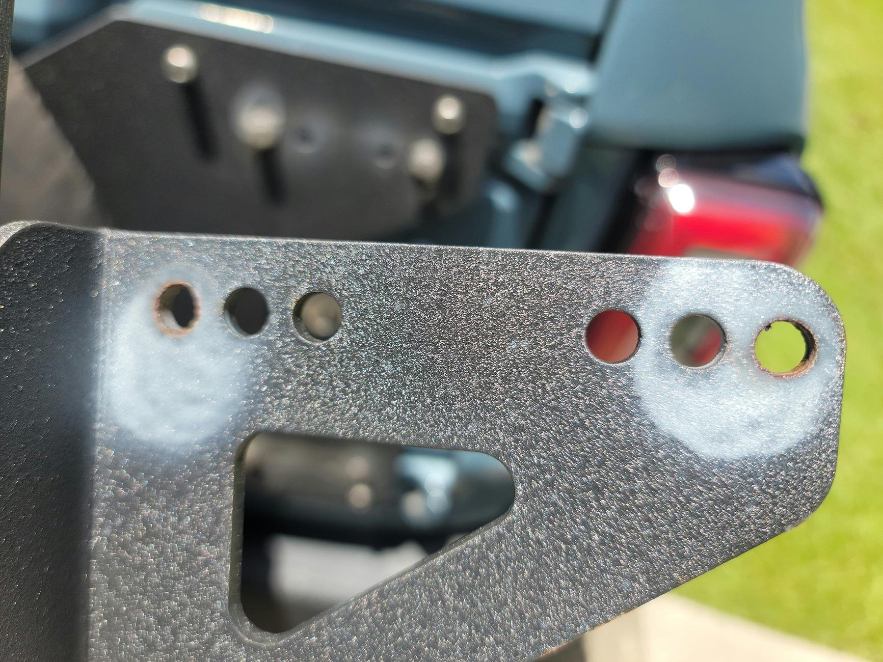

There's no rust, that's a light reflection likely from the Lithium WD40 I liberally spray on fittings used on the beach! When the bracket is off (as it is now) the bolts store nicely alone on the mounting plate (photo).
Glad to hear. I thought I saw it here.

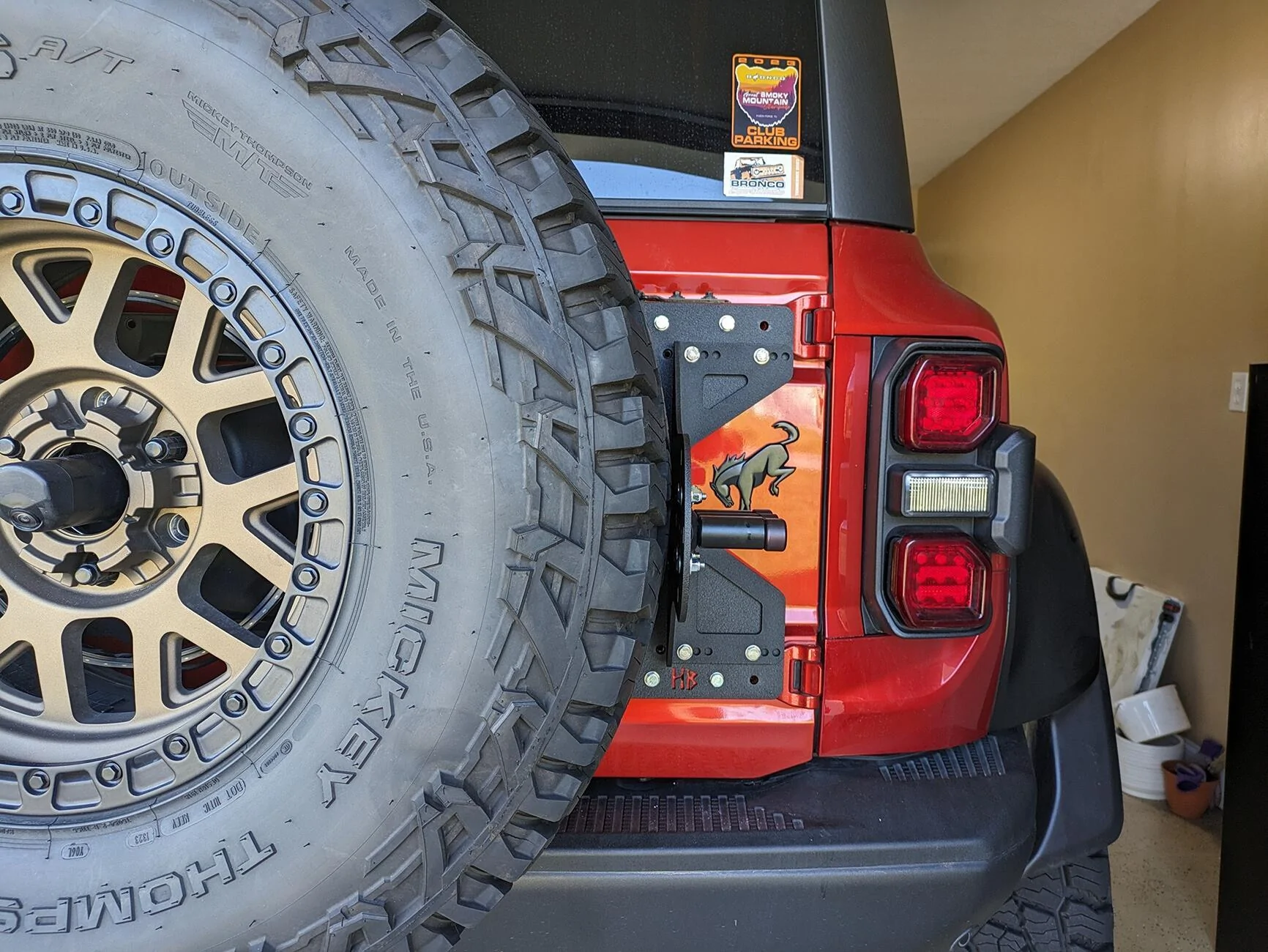

I run a HB now as the OEM one is worthless with minimal accessory mounts. I currently have a 3 gall rotopax. If I need more I have a tire strap with two more rotopax mounts which I have used to mount boards.

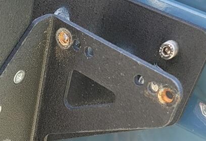

Yes, there's a bit of rust (today's photo below) showing on the inside of the bolt holes that attach the bracket to the plate. It's off the vehicle, awaiting my next beach trip. It's a steel bracket used on the beach, so I expect it. I suppose it could be made from stainless steel, but who'd pay? The powdercoat coating inside the hole rubbed off. I'll keep it lubed. Not something you'll see in the desert! There's also going to be some dissimilar metal electrolysis with a stainless bolt in a steel plate . . . Enhanced by the salt. I find lithium wd40 helps stave off rust in such settings. I've also seen Stainless and Alunimum corrode
