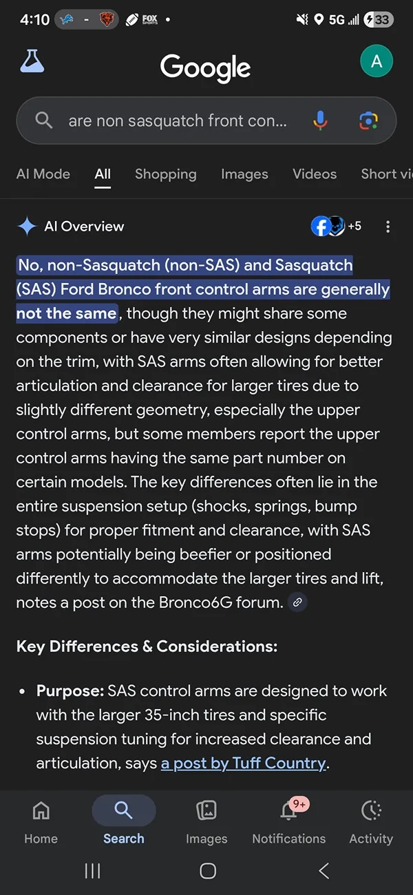

I was told if you level put your bronco and put bigger tires on you want to upgrade your control arms to get a proper alignment.
Your OEM control arms are identical to the SAS Broncos that come standard with 35's, and a 1.1" lift.

Plus people on here said it helps with alignment. This is all new to me never a vehicle like this, I drove trucks basically for the last 15 years.

You don't need the UCA's unless you go 3-5" above stock base non Sas. Maybe you can sell them to recoup some cost. You might be able to find some Sas takeoffs for a decent price on FB Marketplace or Craigslist and then sell your wheels/tires to offset that. You could also go with a 35x11.5x17 tire instead of the 315/70/17 (unless you go with the factory Goodyears which run a little small) and that might prevent any potential rub with your stock wheels. My truck is a base Sas and I swapped wheels the first month so I can't say what might rub.

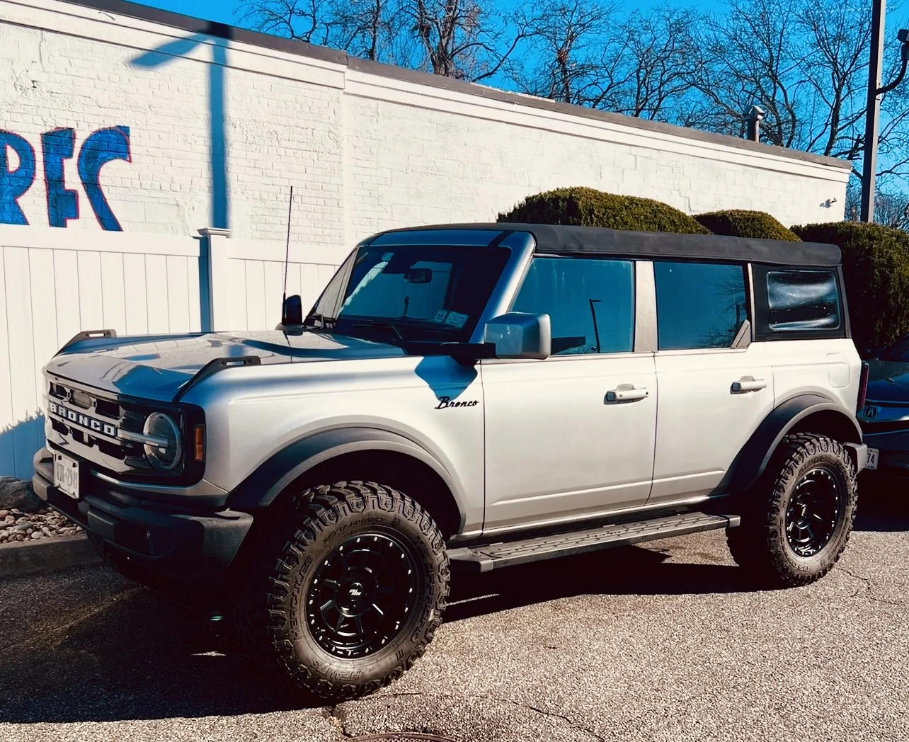

I have the 18 inch version of these. These are 17s. Wont break the bank. Check out the price. Just another option. Based in California. I called them with a question and they answered and spoke to me. In english. Pic of my truck below. Have 35x12.5x18. These are +12 offset. No rub at full lock and no lift.

Sasquatch and non-sas have the same UCA's. Since you are only leveling your Bronco, it's suspension will be right in the middle of sas and non-sas height, the stock OEM uca's are perfectly engineered for that height, as well as running 35's. .

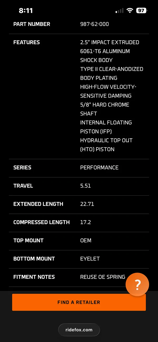

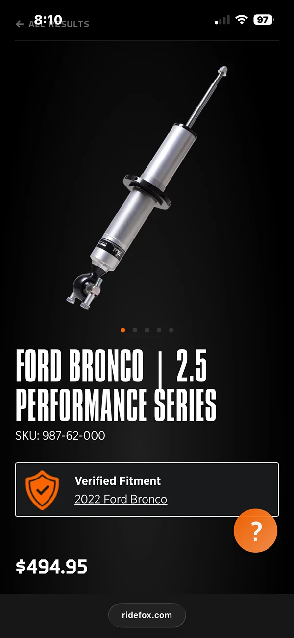

If these are the front struts you have then you won’t need the UCAs. Oem UCAs will most definitely be good for a 2” lift. That will give you just a little more than sas, about an inch. I would dial in the threaded collars for 1-2” above what you have now. Depending on preference.
Should look good with 35s. I would return the UCAs and get some sas takeoff wheels.
Should get you the look you want and still ride nice.

That is exactly what I have. I posted a Pic of them in my first post

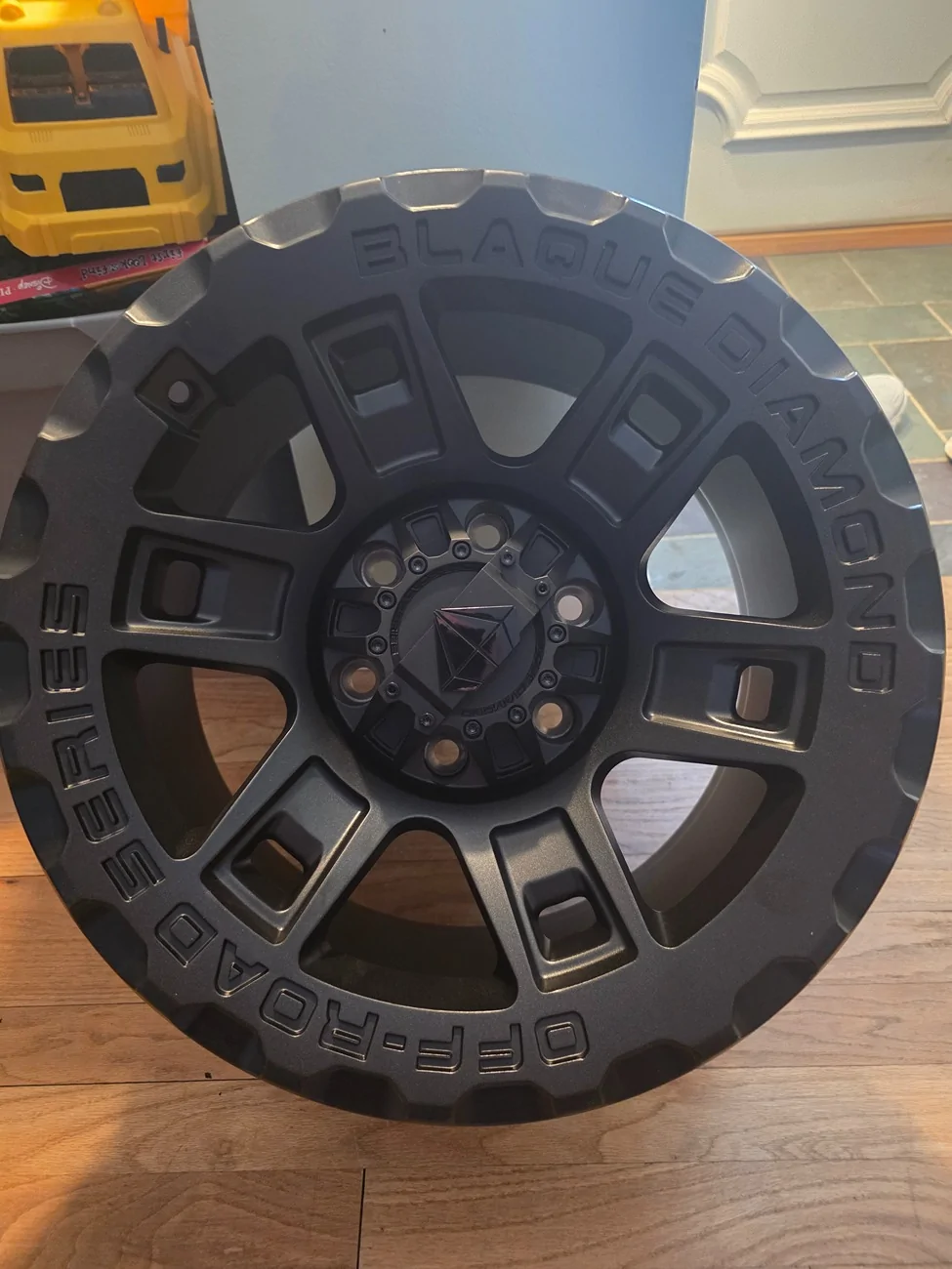

Just came in the other day. I want to say thank you to everyone that took the time out to drop some knowledge on me. I am brand new to this game and I am slowly learning. The rims I got, and yes I ordered 5, are blaque diamond, matte black, they are 17×9. Now if its ok I have one more question I've been looking at 2 different tires, my first look is the 35×12.5 toyo R/T pro and the Mickey Thompson baja lengend exp also 35×12.5. I know most will say i should go with the BFGs, but I really like the look of those 2 tires. Any real time info on these brands would be greatly appreciated
