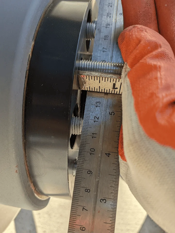

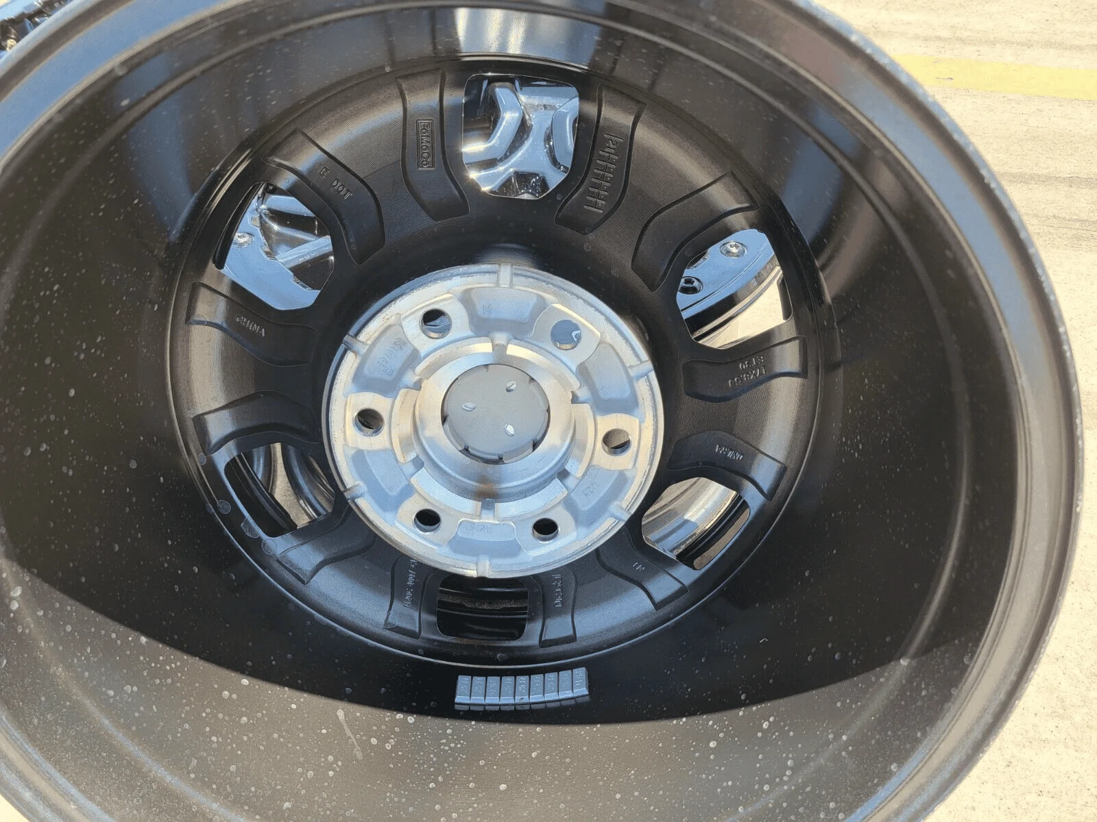

Squatch offset is 25mm 30mm so a 1" 1.2" spacer will get you a zero offset. The Squatch wheels have small "pockets" between the lug holes and are maybe a 1/4" to 3/8" deep. This will allow the stock lugs to protrude past the spacer without issue or trimming required.

Rear lug protrusion on a 1" spacer:

Squatch offset is 25mm so a 1" spacer will get you a zero offset. The Squatch wheels have small "pockets" between the lug holes and are maybe a 1/4" to 3/8" deep. This will allow the stock lugs to protrude past the spacer without issue or trimming required.

Thank you. I thought a SAS wheel was +30 so 1.18 or 1.2 got you the closest. Mishimoto just told me I need 1.4 not to trim studs and I don't want to trim. So hoping 1 or 1.2 spacers won't need trimming.
