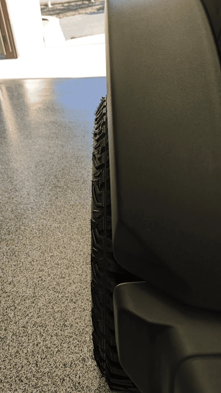

I have a BL Sas too. Went with 1.25"Boras and thought it was too much poke so I switched them our for 0.75" which I like. It's just a personal thing but I think 2" would be hanging way out there.

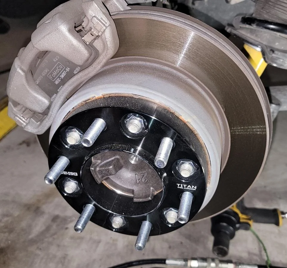

Why?…I have a brand new, still wrapped set of Titan 1ā€ spacers For sale…got a deal on 0 offset wheels when going to 37s instead of using spacers…
Barry, so you went from stock SAS wheels (offset +30) to new wheels (offset 0)? Seems something people commonly do, 30mm of new poke — you’ve had no issues? No worries? The (slightly more than) 1ā€ is fine?

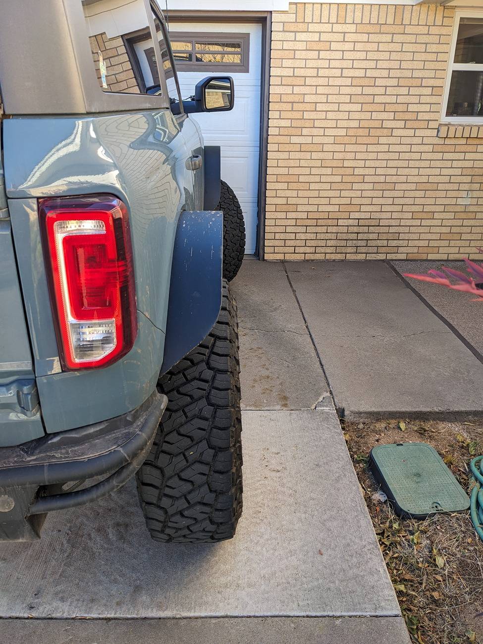

Yeah most need at least 3/4ā€ less offset to clear the UCAs with 37ā€s and since I went with 13.50s, zero seemed the ā€œsafestā€œ and I have had no problems with the choice nor have I heard of anyone having problems…

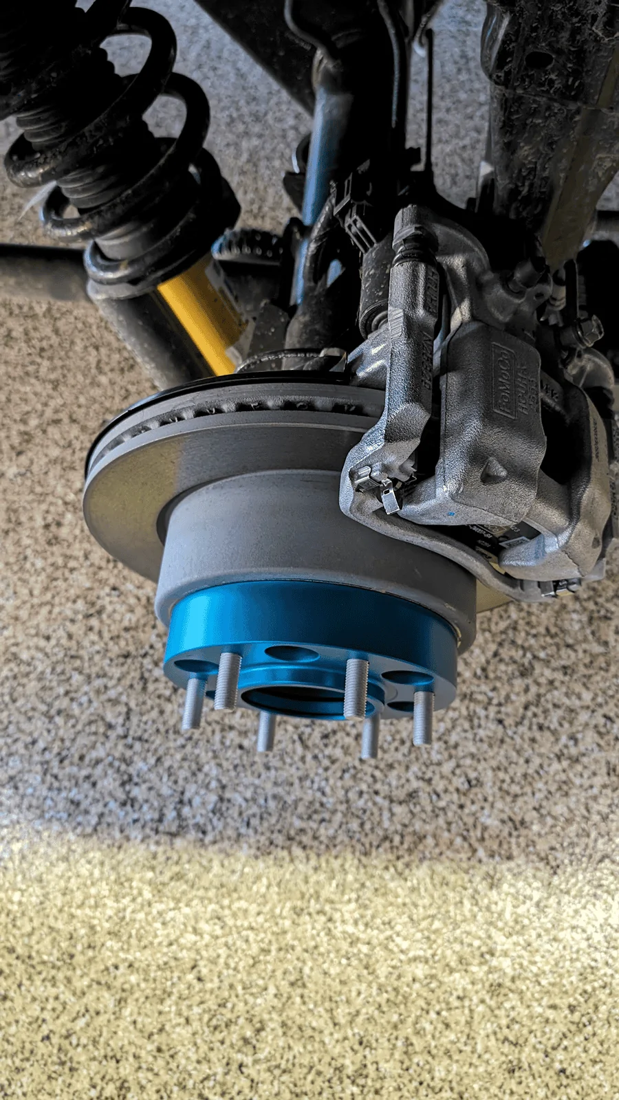

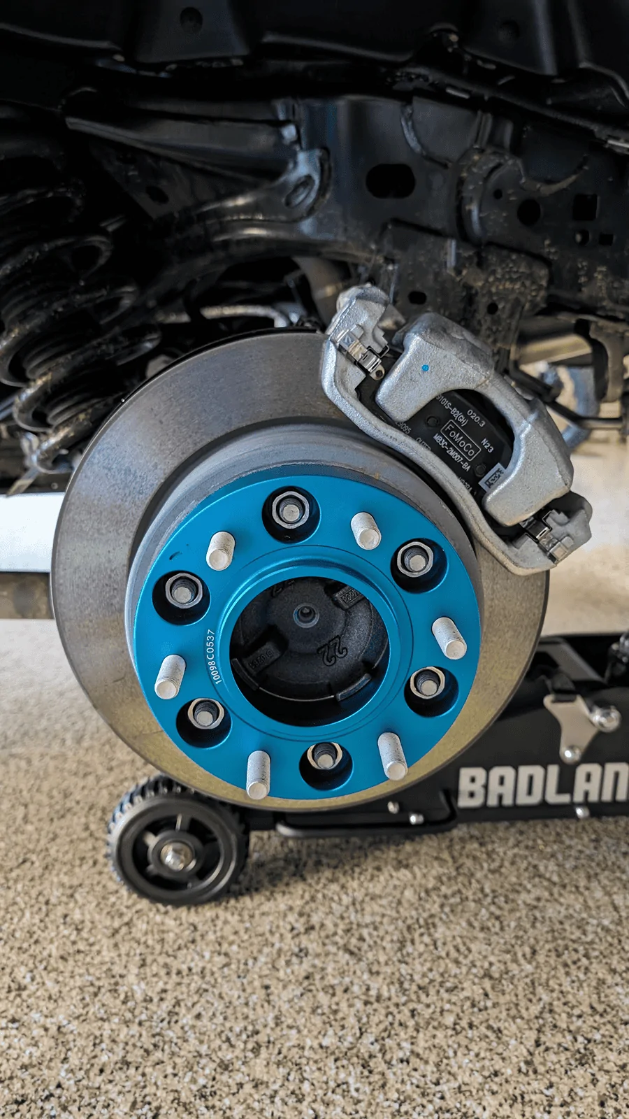

Hey guys, i am looking for some recommendations for wheel spacers. I have a 2 door badlands Sasquatch that is stock currently. Not sure if i should do 1 or 2 inch spacer and also which brand to buy. So it you have spacers and recommend them that would be great. Pictures would also be appreciated!
(Also, move this post if its not in the correct thread)
I always use the hub centric Bora wheel spacers. As far as 1ā€ vs 2ā€, be mindful of your scrub radius, especially if you think youll ever go with bigger tires. I’d say 1ā€ to be safe, but thatā€˜s me.
