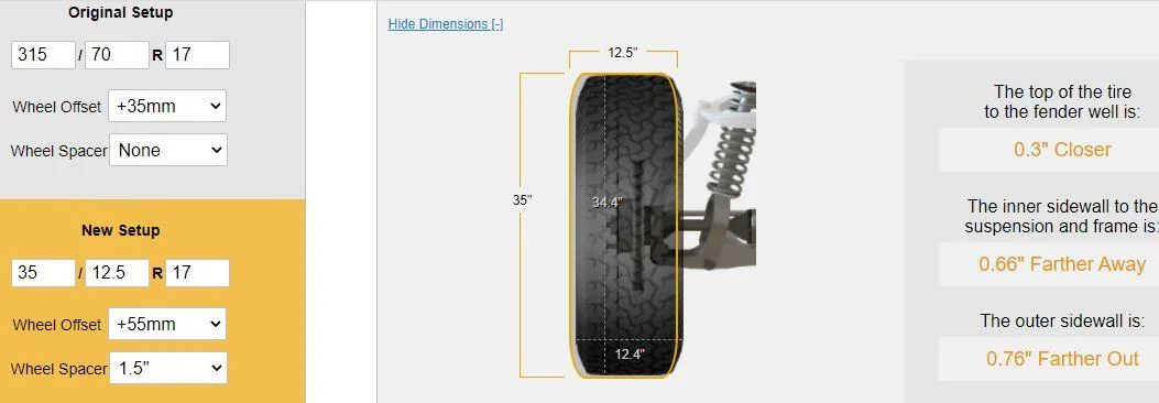

tSo My build is a 2 door Badlands with optional Rims. I have 35x12.5R17 Toyo M/T tires and a 1 inch level on standby for when my truck shows up.
Now, these rims are +55 offset compared to the +35mm of the sasquatch. Realistically if I wanted to match the stance of the sasquatch, I'd need .75" spacers.... but I'm not sure if the lugs would be long enough for that. Thoughts?
Ford Bronco Self Squatch Wheel Spacer Decisions toyomtrim

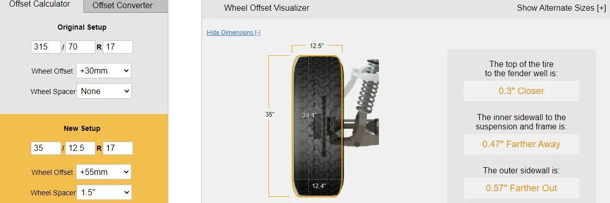

So any ways, what I ended up getting is 1.5" adapters from Coyote accessories. Hub centric, high quality.
This is how much it'll stick out compared to Sasquatch. I think it'll be a nice stance. Let me know what you guys think.

Squatch are actually +30 offset so a 1" (25mm) spacer would have gotten you the same offset. However, since you went 1.5" and Squatch wheels are 8.5" wide compared to 8" for the opt BL wheel, your stance should be about a 1/4" wider on each side when compared to Squatch.

Oh nice! so with 1.5" I'll be perfectly centered, but a little wider. That's perfect. Thanks!
I was sure the sqatch wheels were +35mm
