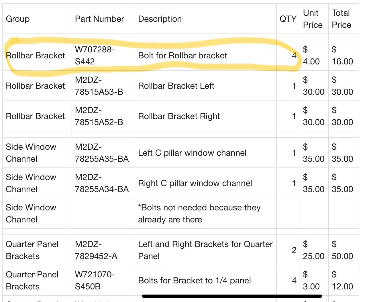

Are the bolts that attach these roll bar brackets the same size/length that secure the hard top to the body? I have extras from the latter as I replaced them with Rockworx fasteners.

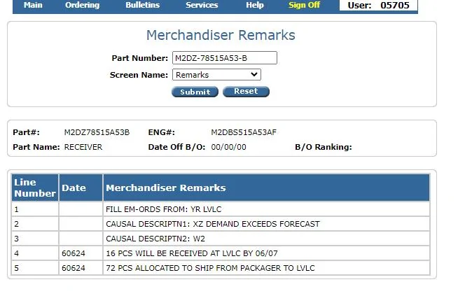

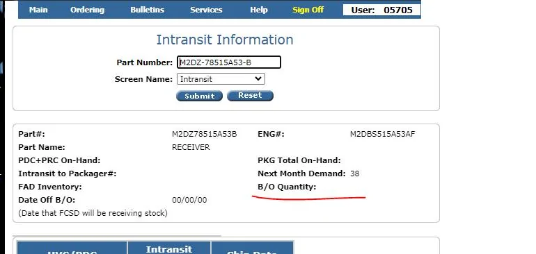

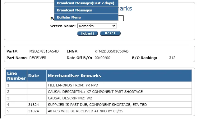

@flip Are these roll bar brackets still on back order?
Yup. Does not appear any back orders in the system currently on the right side (second snip), left is the same. My suggestion for anyone wanting these is to place an order so you are in line for the incoming batch before dealers (like us) place stock orders so we can keep a few in inventory for e-commerce or repair shop sales.:wink:

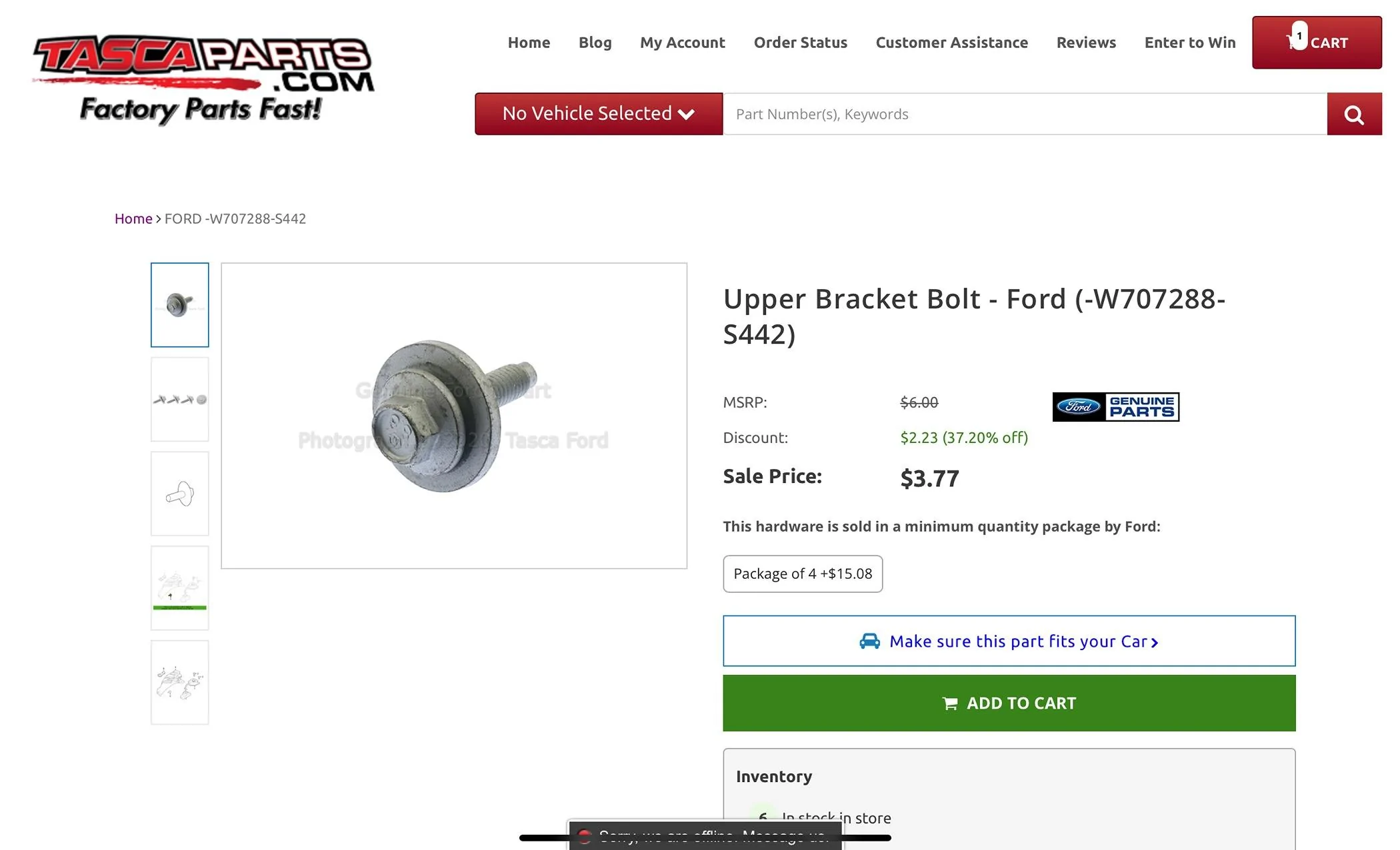

Hoping someone can clear up something for me. In the picture above, the bolts for the roll bar brackets are black and look similar to the bolts for the hard top roll bar brackets (right side of the image I referred to in my earlier post). But when I look at the part number (W707288-S442) that was listed in one of the earlier posts, the bolts look totally different (see below picture). They’re a dull grayish color and look more like the bolts for the quarter panel brackets.

The poster made a mistake. I purchased W707 based on that chart thinking I’d get the black bronco bolts and unfortunately learned the hard way when I got what you pictured below. W707 are used in the trunk area and are provided with the soft top “pallet” when purchased from the factory. They probably didn’t realize this if they needed ALL the hardware.
Yeah, I received the same grey bolts in the mail. Do you know which part number is right for the roll bar bracket bolts? Do the bolts that secure the hardtop to the body work?

You want W721070-S450B. Got mine from Flip at Ruxer.
