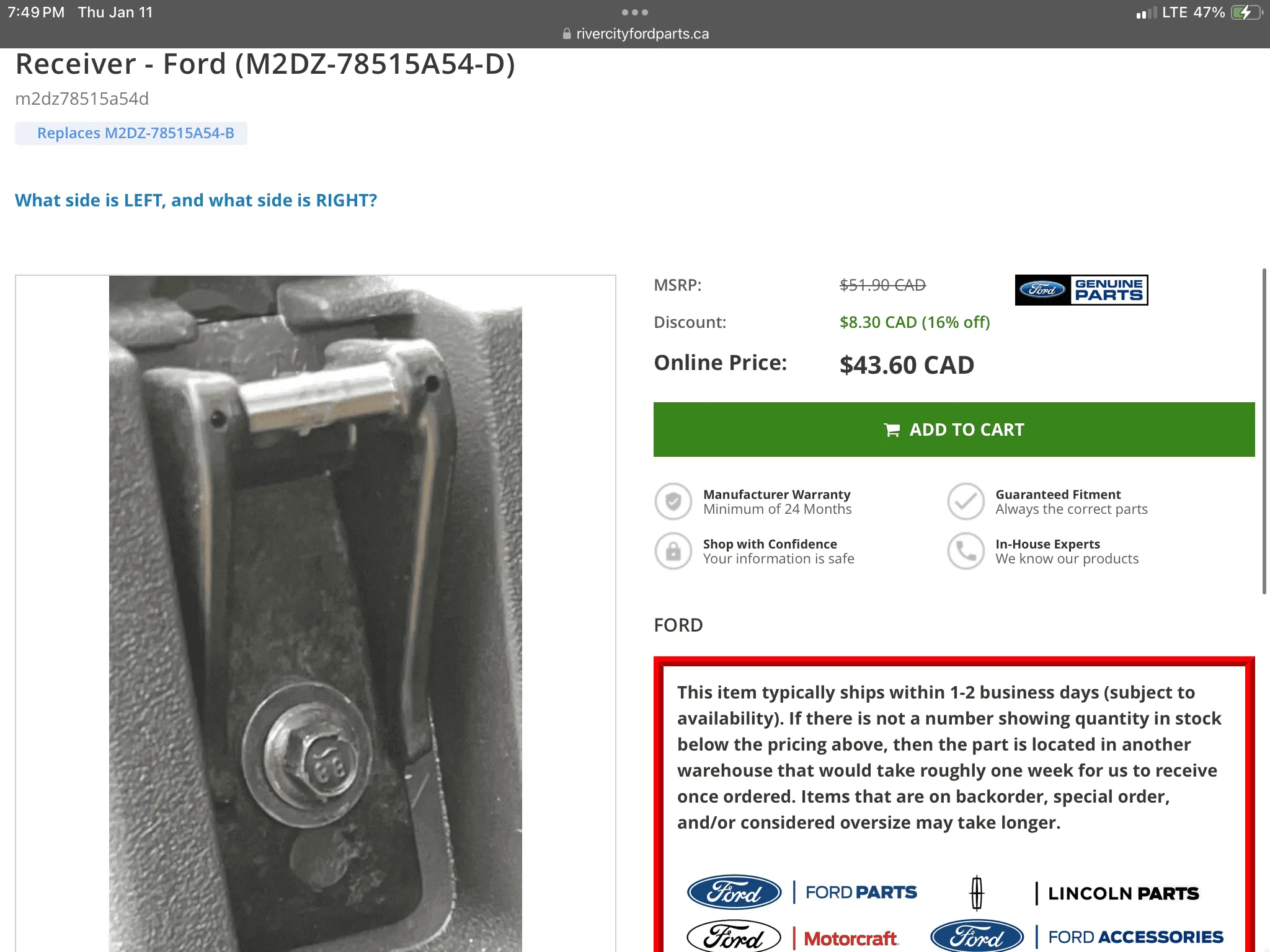

Rear Window BracketsM2DZ 78515A54CRear Window Brackets
2​
$ 35.00$ 70.00
Rear Window BracketsW721070-S450BBolts for Brackets
2​
$ 3.00$ 6.00

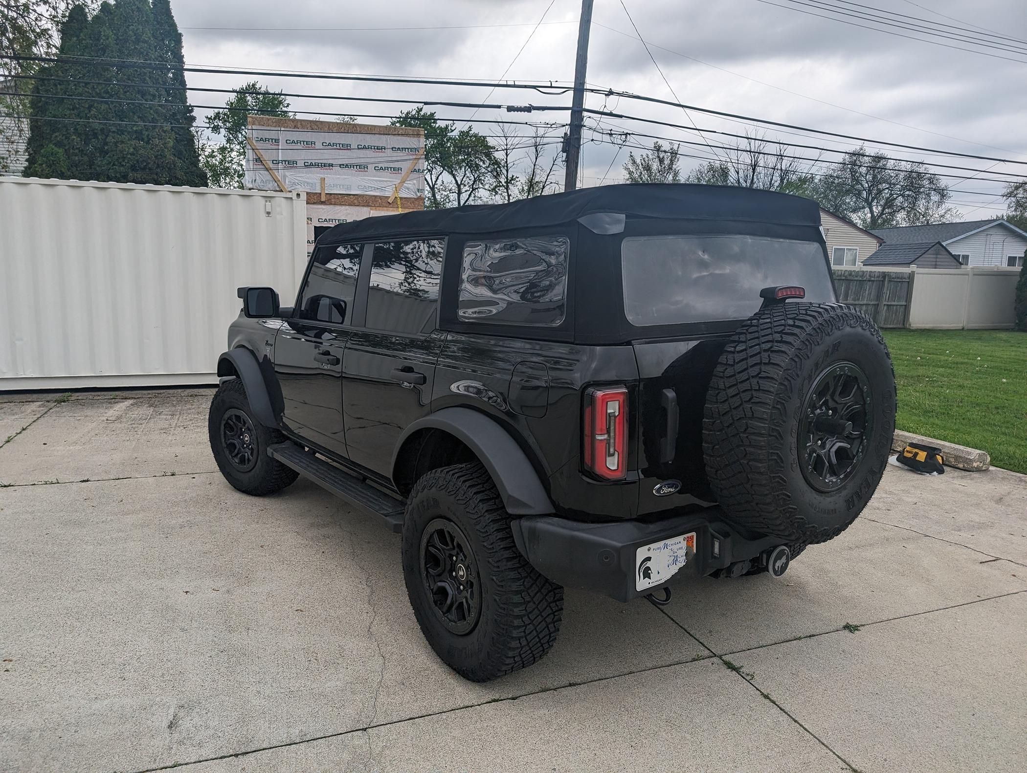

Thanks, this helped a lot. I was able to get it in no problem using this method and then once we had the hard top off it was very easy to go straight out the back with it.

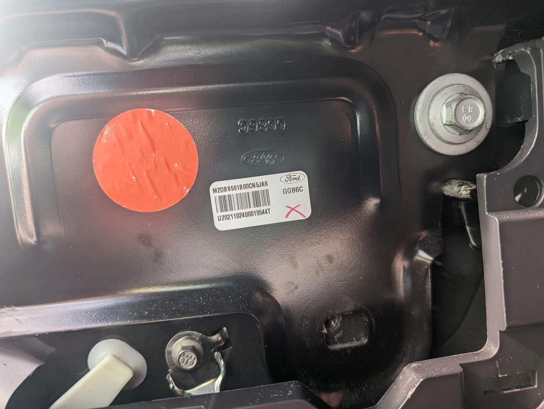

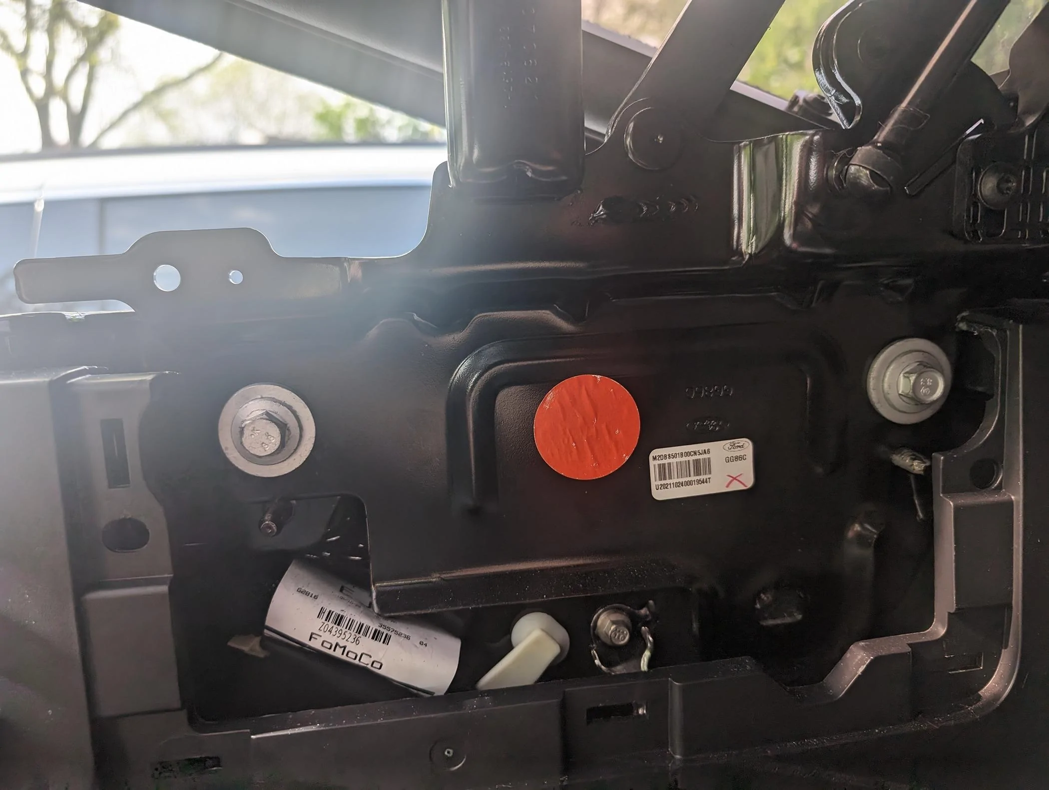

Putting the hard top on to me was about 20x easier than the soft top. I had a really hard time lining everything up properly. The first time we set the soft top down in place I realized that it wasn't going to sit flush with the bolts from the hard top back in place on the frame. I swore I read somewhere that the best thing to do with the bolts was put them back into place after removing the soft top just so you don't misplace them. That was attempt 1. Attempt 2 we couldn't get the brackets to line up with the bolt holes on one side. I got all 3 bolts in on the other side no problem but on the one side the bolts would only go about 1/4 of the way down and then major resistance to the point that I was going to strip them if I forced it. Nevertheless we carried on, and tried to fully close the soft top but the front passenger pin was about 1/4" back of the guiding hole and we couldn't get it to budge.. Figured it had something to do with the bracket not lining up so we took it off again and I readjusted the bracket. Of course by this point I had forgotten all of the warnings I carefully heeded the first time around and sure enough I lost a bolt down the quarter panel cavity. Luckily I had extras. The last attempt we still had a hard time lining up the brackets with the bolt holes on the same side but I was at least able to get two of the three fully tightened. I left the other one out because it wasn't going in without stripping it. Barely got that front passenger pin in by putting some major weight behind the folding arms by the rear quarter panel on that side and trying to force them forward. The last obstacle was that those stupid flaps on roof on either side of the rear window wanted to sit on the outside of the vehicle. I was able to force them in and under but something didn't seem right, they should have tucked in much more naturally it seemed. At any rate, the job is done and it took us about an hour 15. I don't look forward to doing that again but maybe it will get easier with practice. Good tips by everyone to protect the roll bars. At least that went ok.

Follow up. You can see the bracket on the driver's side. The bottom hole for the bolt is not aligned and I couldn't get the bolt in there. If anyone has any ideas what may be going on, I would love to hear them. Hopefully make this process a little easier in the future.
