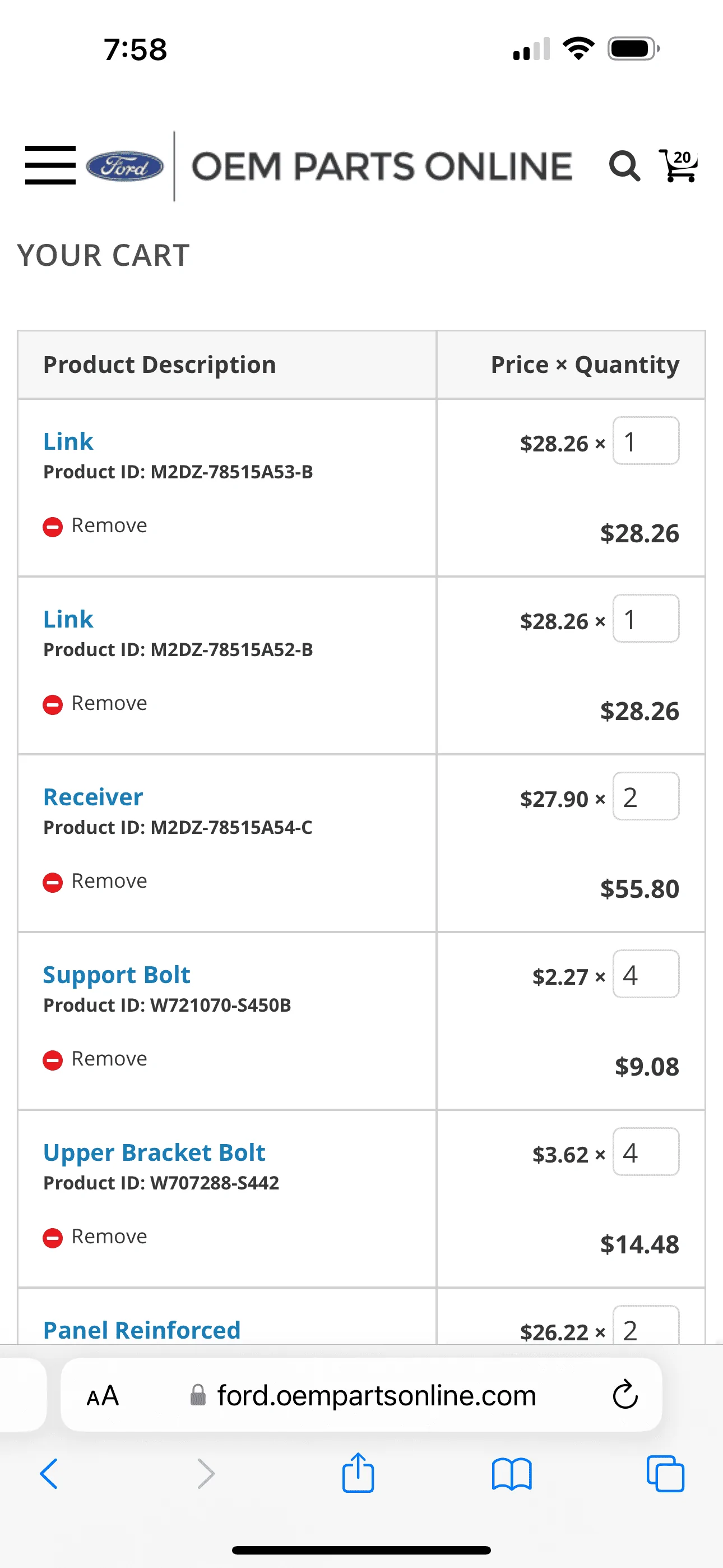

Thanks! Will double check. This is what I'm planning to order. Quantity 1 for bolts because they come in packs of 4. Some items seem to be on backorder online. So will have to go to the dealer to order. The dealer price also seem to be a little less.

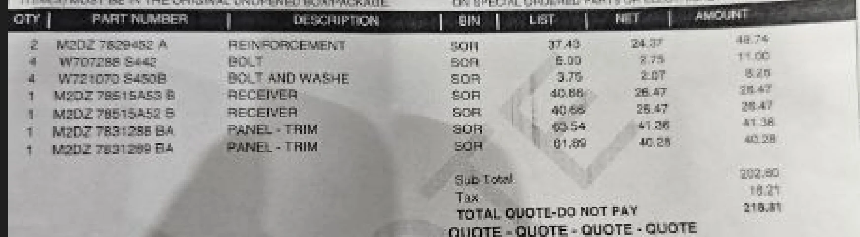

Here's my quote. Only thing missing (hopefully) are the rear latch brackets due to the part # change. I will forward that info to parts guy. thanks!
Rear latch brackets-
M2DZ-78515A54-B or M2DZ-78515A54-C as this is the new part number.

You are also missing the bolts for the rear latch brackets right? I didn't include the panel trims because I got them with the soft top. Thanks for sharing the quote.

I'm hoping what is listed as 'panel trims' are the covers for where the soft top bolts on in the cargo area. I also got those side panels that the windows slide into with the soft top.

I didn't realize there is a soft top version of the panel trim. I misunderstood that to be the panels the windows slide into, which is what I got already with the soft top. So I may have to get the panel trims as well. Thanks for clearing that up.

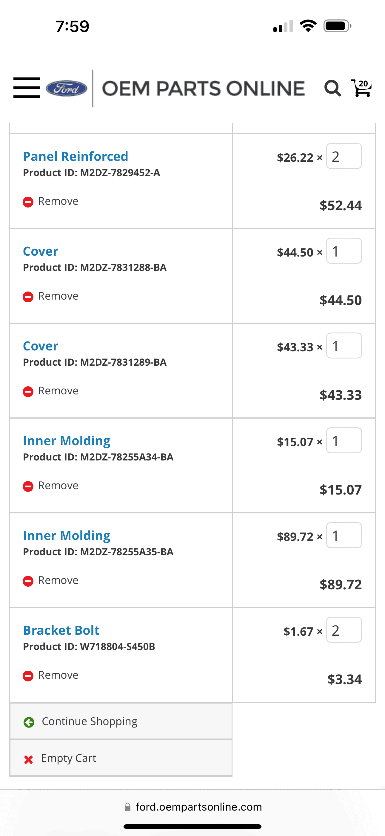

This is the list I put together for all the parts

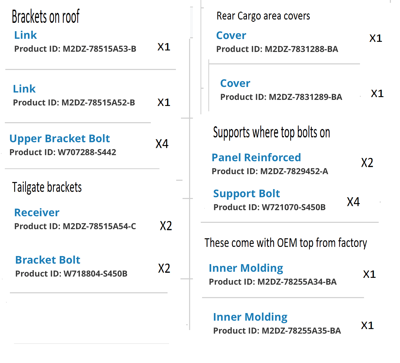

That was awesome! It's what I was originally looking for. I organized it so I could more easily compare with my list (and because I'm a nut). I am missing the bolts for the 'Reciever' brackets at tailgate (these are the ones with new part #).

amazing, thank you!

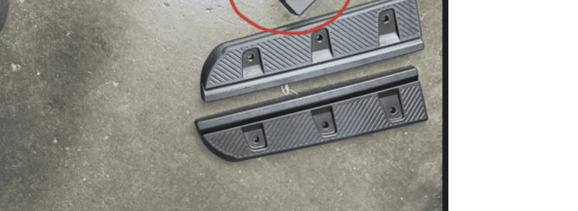

Are the parts shown in the screenshot below the "inner Molding" that is mentioned on your list?

Yes. Those of us who grabbed tops coming from dual top broncos have those included.
