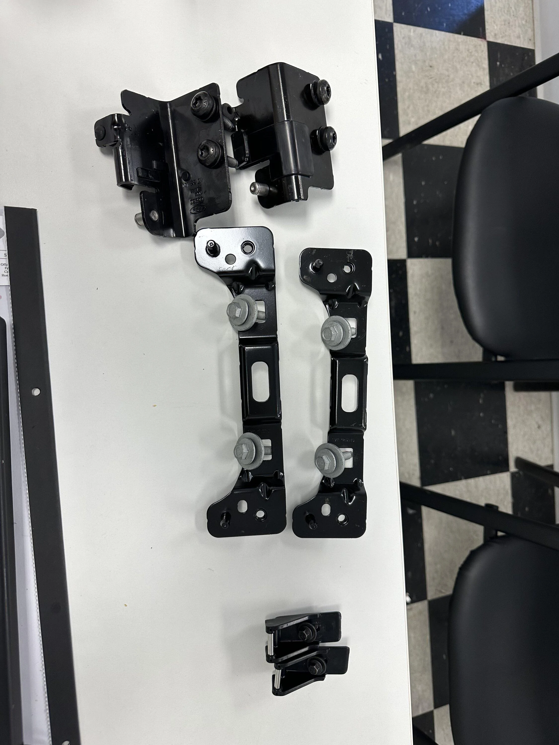

the below pieces were pre-installed on his hard top 4 door.
top bracket for release
Rear piece for back soft top release
Side bracket to accommodate for 6 bolts to mount to soft top to body
see pics

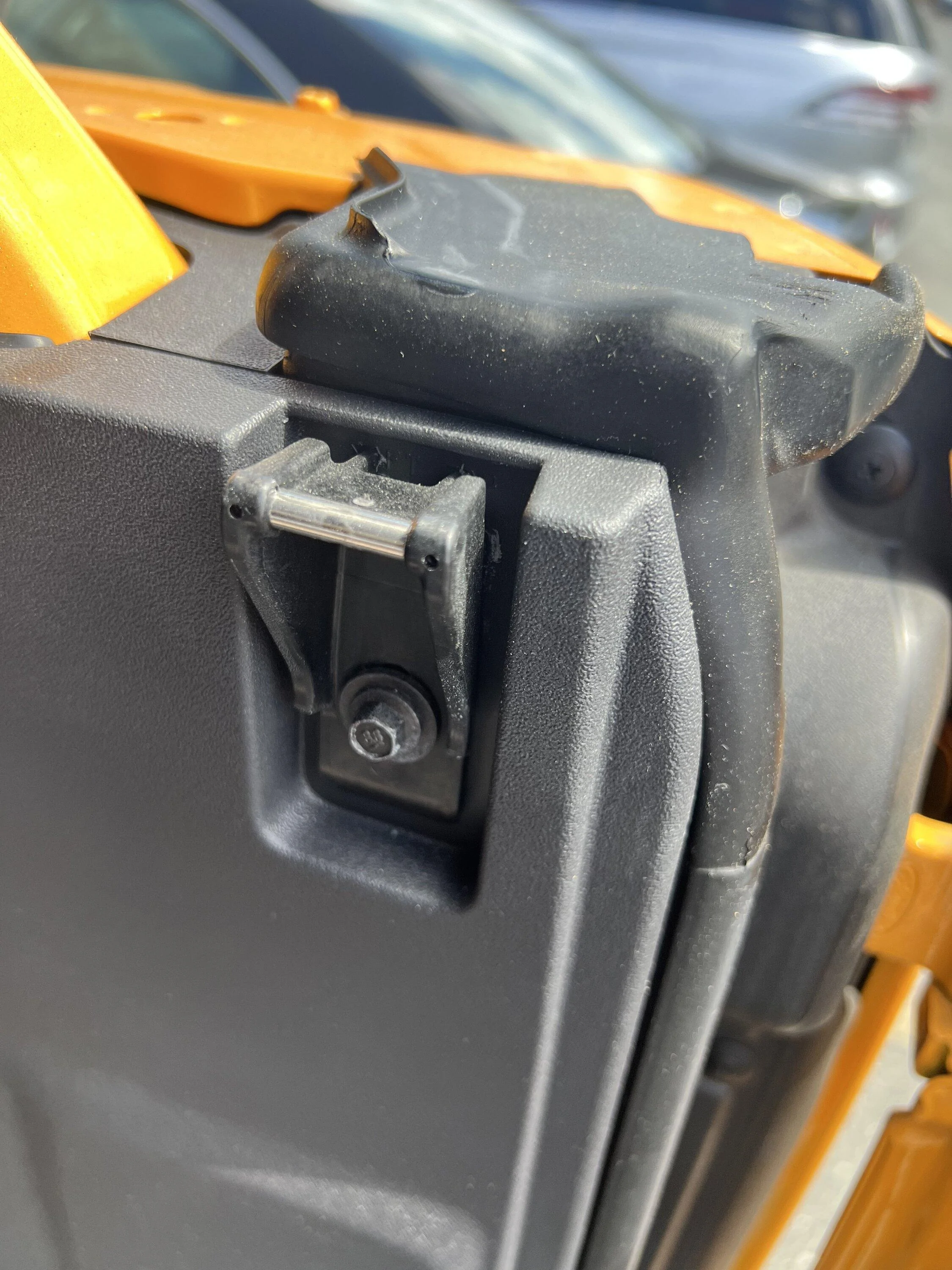

Can anyone confirm if the bolts used to mount the rear support brackets to the car, are different than the bolts used to mount the soft top to those brackets? I have a Factory MIC and I’m buying a used soft top that doesn’t come with any hardware.

Nice pic of most important parts
Ford Bronco Soft Top <--> Hard Top Swap : Tips & Lessons Learned - UPDATED 1690299794382

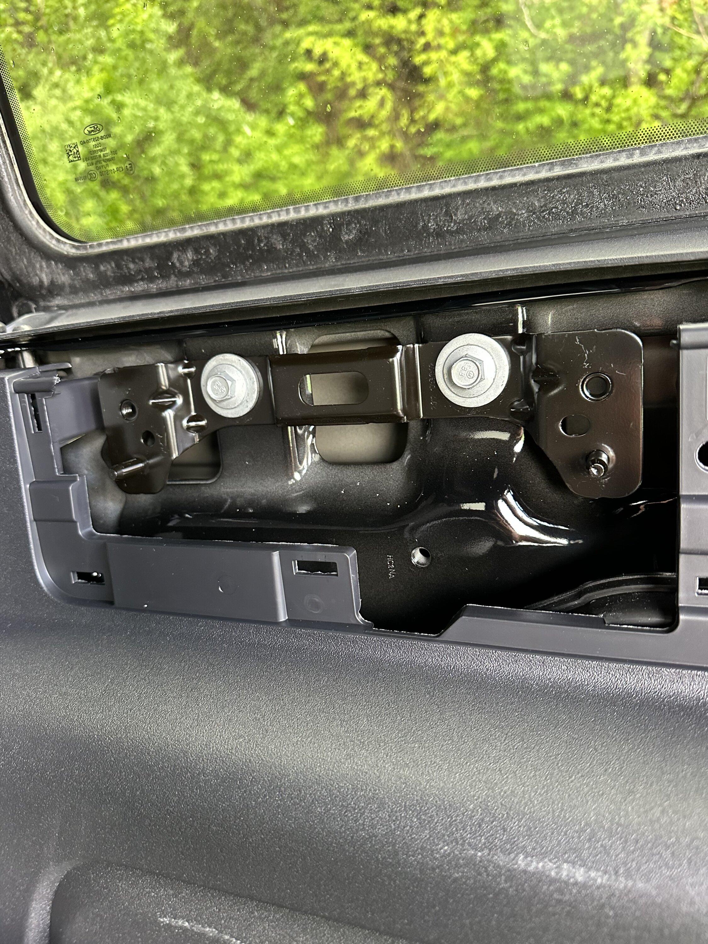

Support Bracket for behind rear cargo cover (long brackets above)
- looks like 2 identical parts
M2DZ-7829452-A x2
Bolts for support bracket
W707288-S442 (looks like comes as pack of 4 bolts)

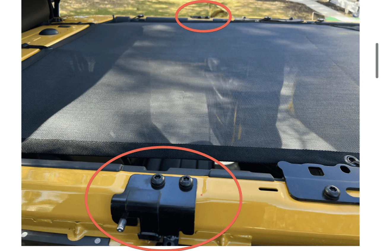

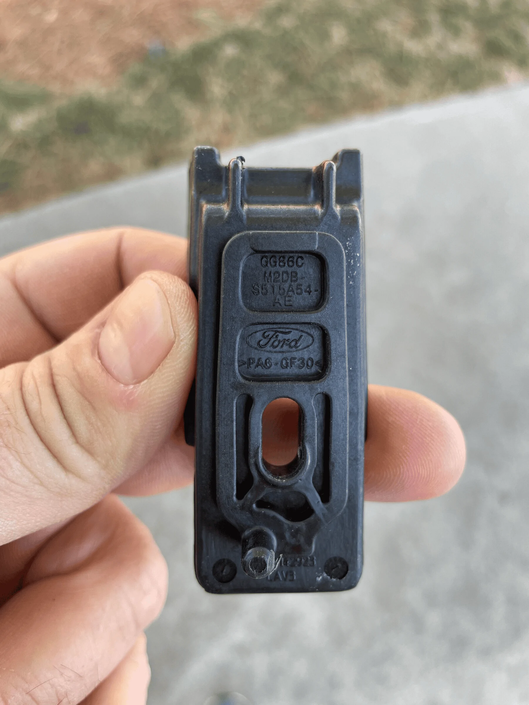

Brackets inside tailgate that back/bottom of top snap into
M2DB-S515A54-AE

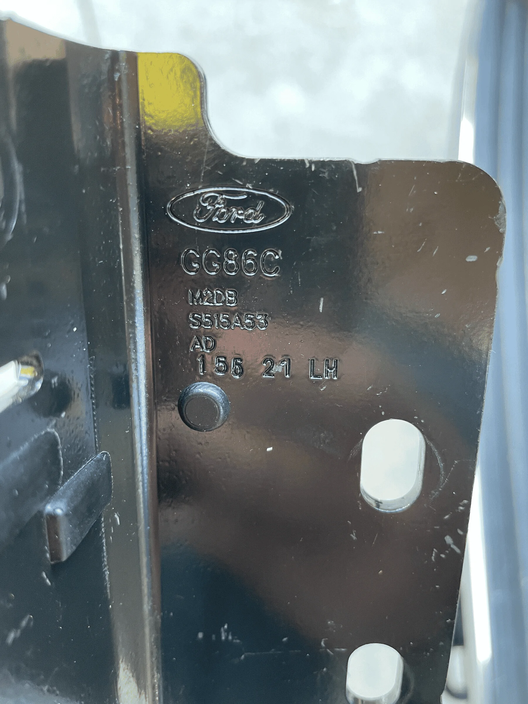

brackets above the back seats mounted to the roll bars
M2DB-S515A52-AD right
M2DB-S515A53-AD left
The bolts for the brackets above
W721070-S450B (total of 4 bolts, 2 each side)
Looks like GG86C is a group number for the parts

They are the same.
