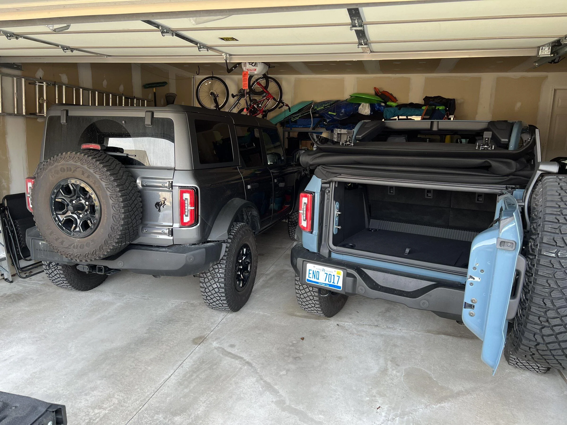

Just did a roof swap on these two today, thanks to your post it went smooth as butter. Appreciate the write up. Cheers 🍻

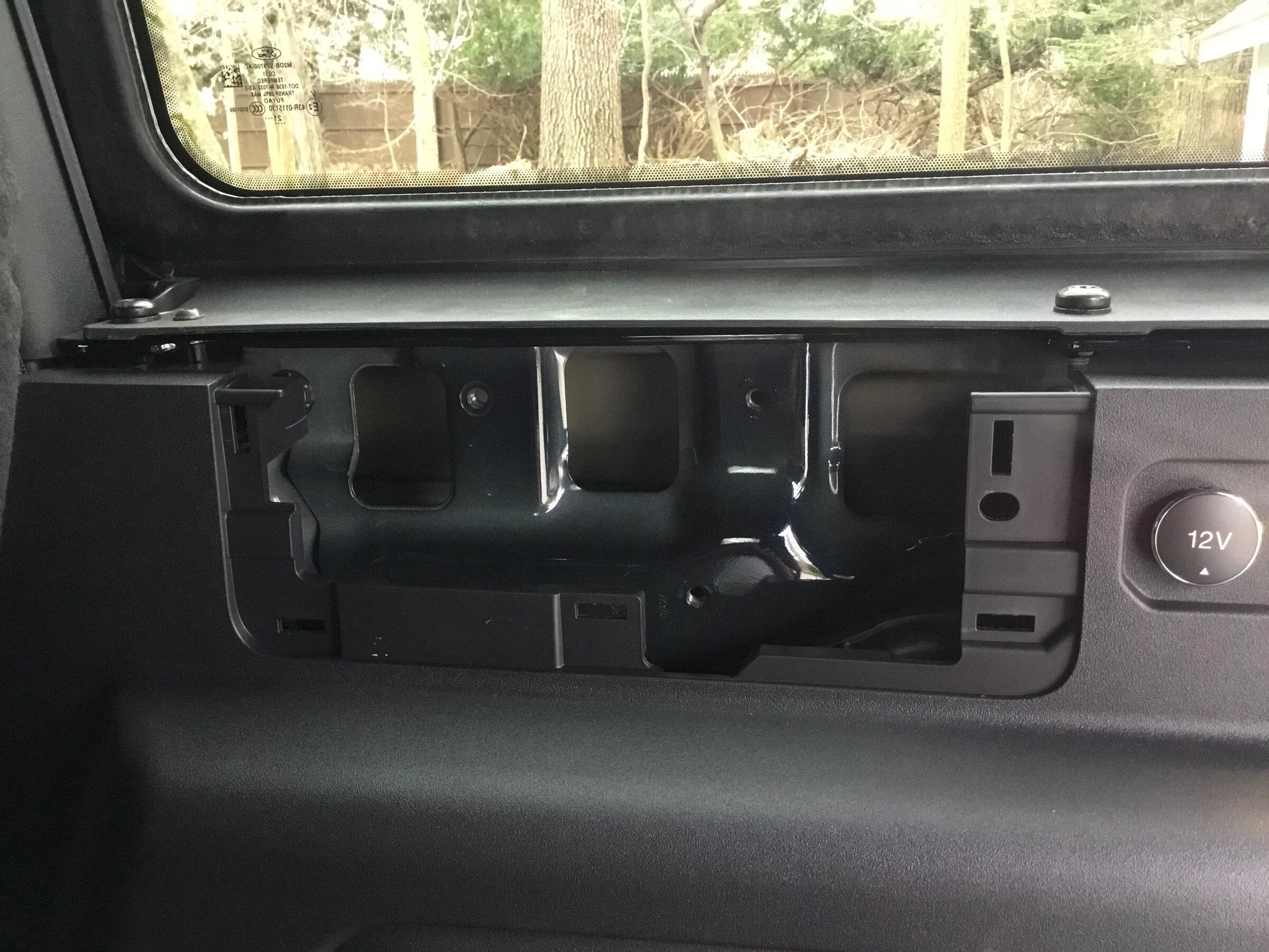

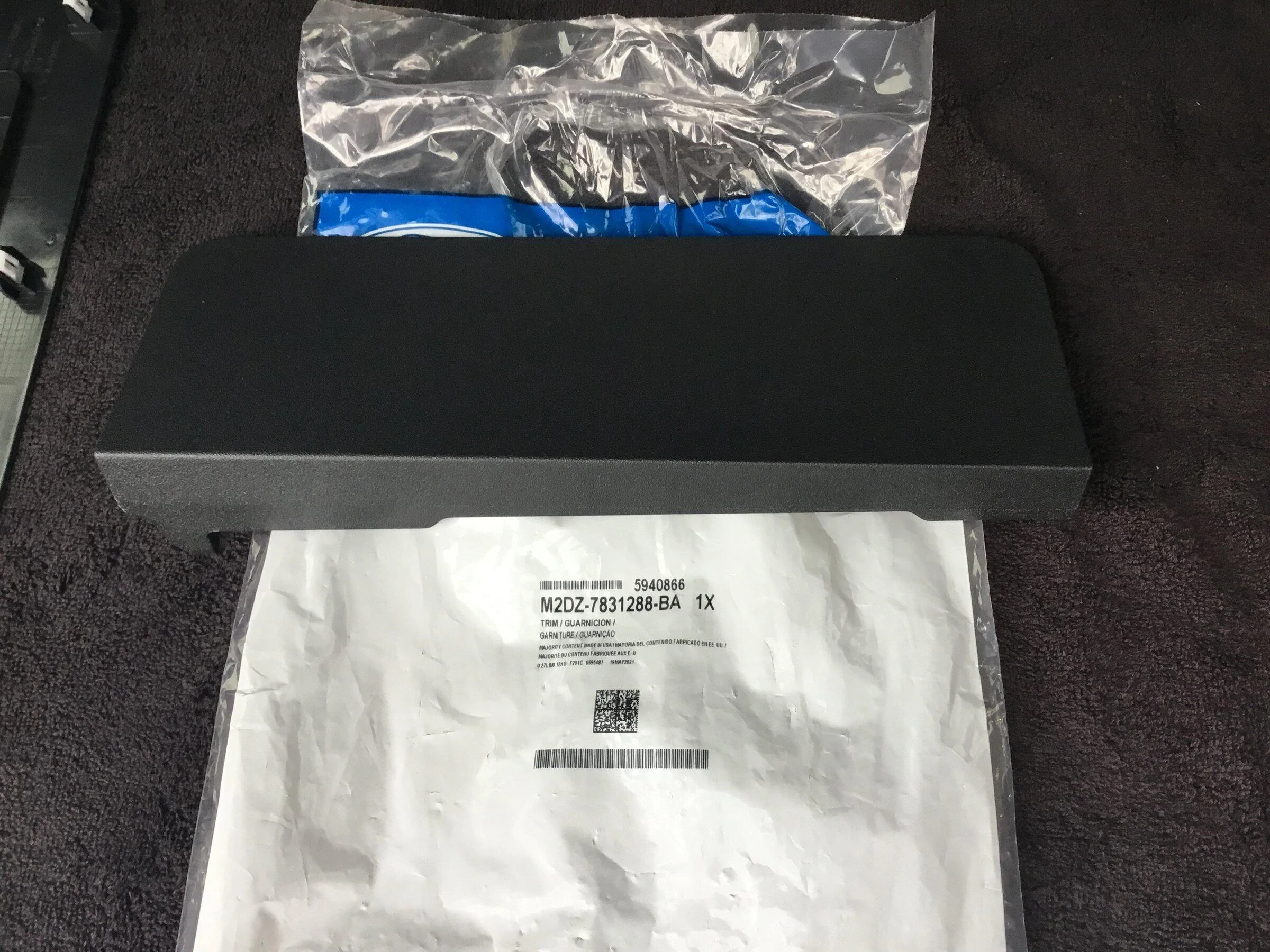

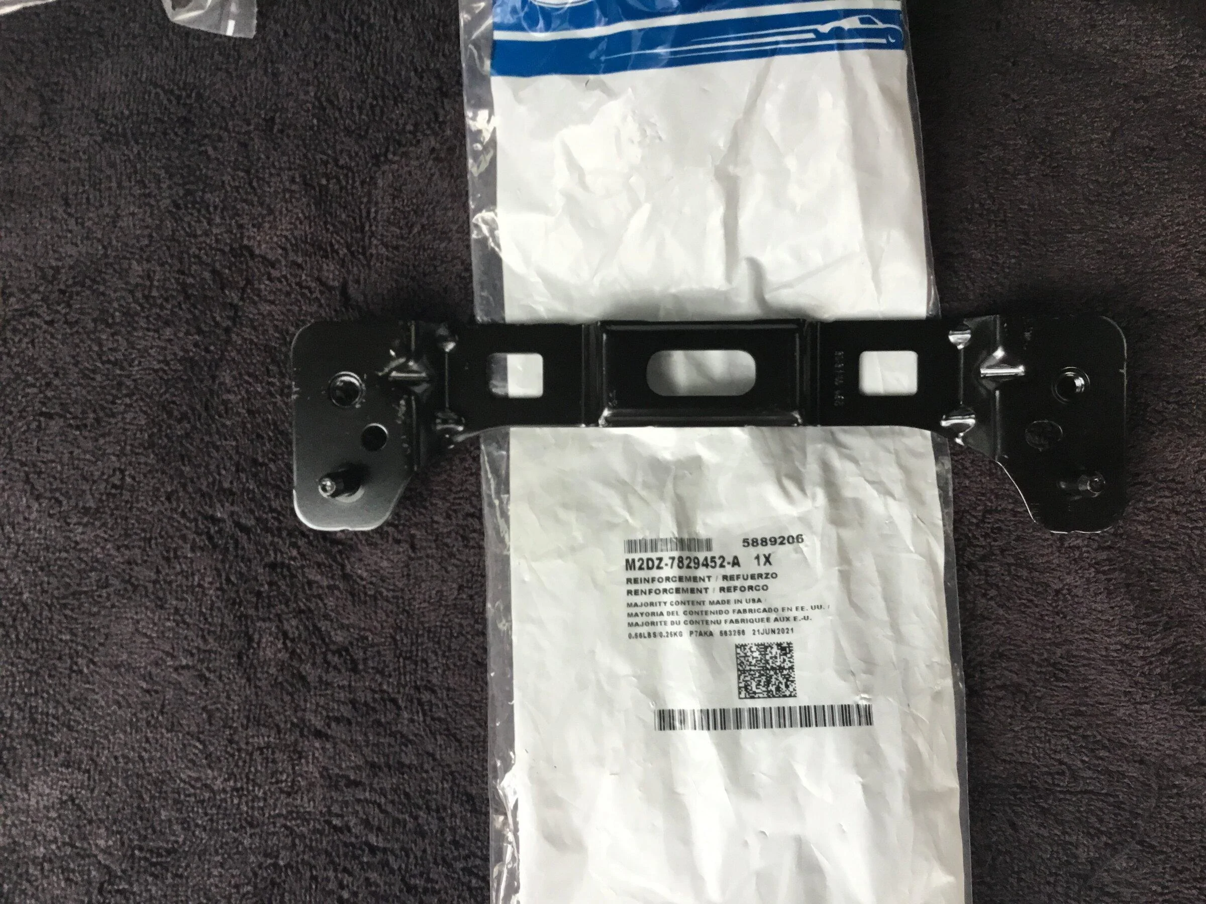

Rear cargo cover removed on hardtop

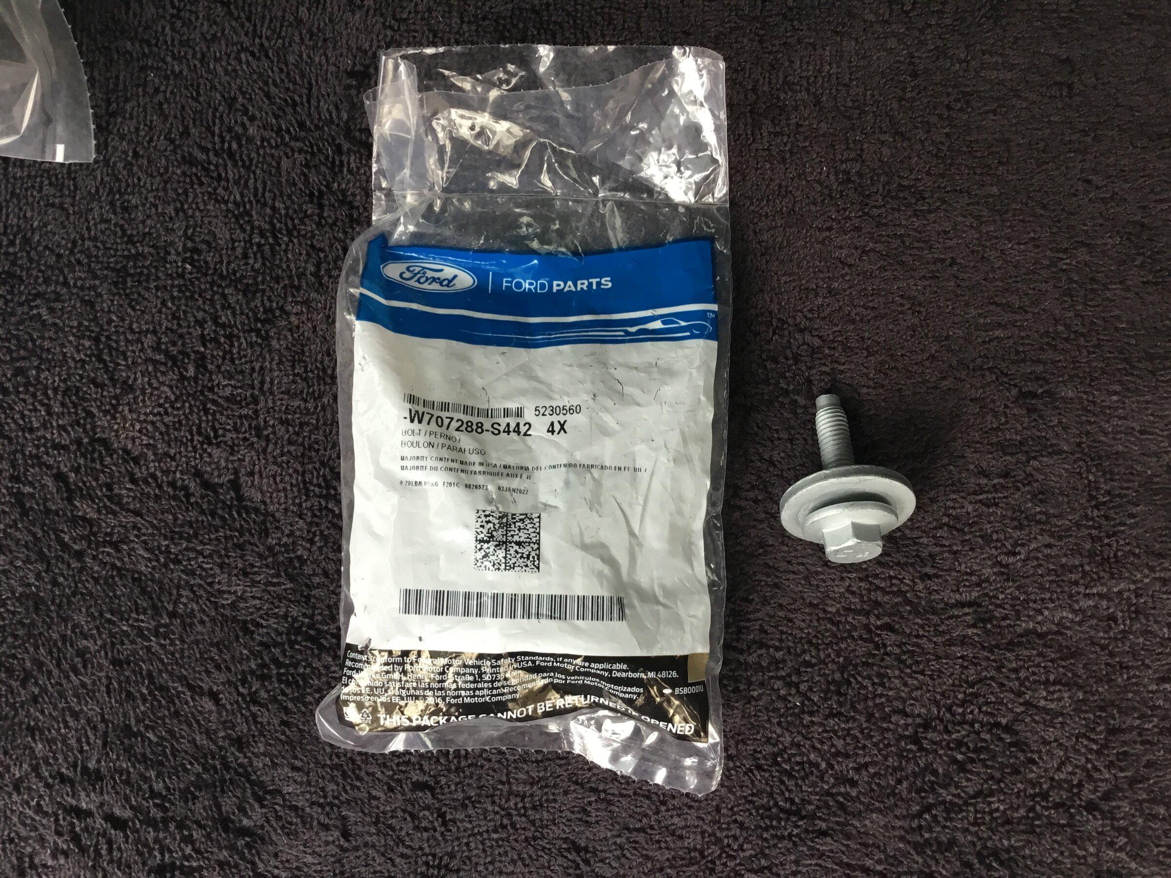

Bolts for bracket behind rear cargo cover
Bracket for behind rear cargo cover

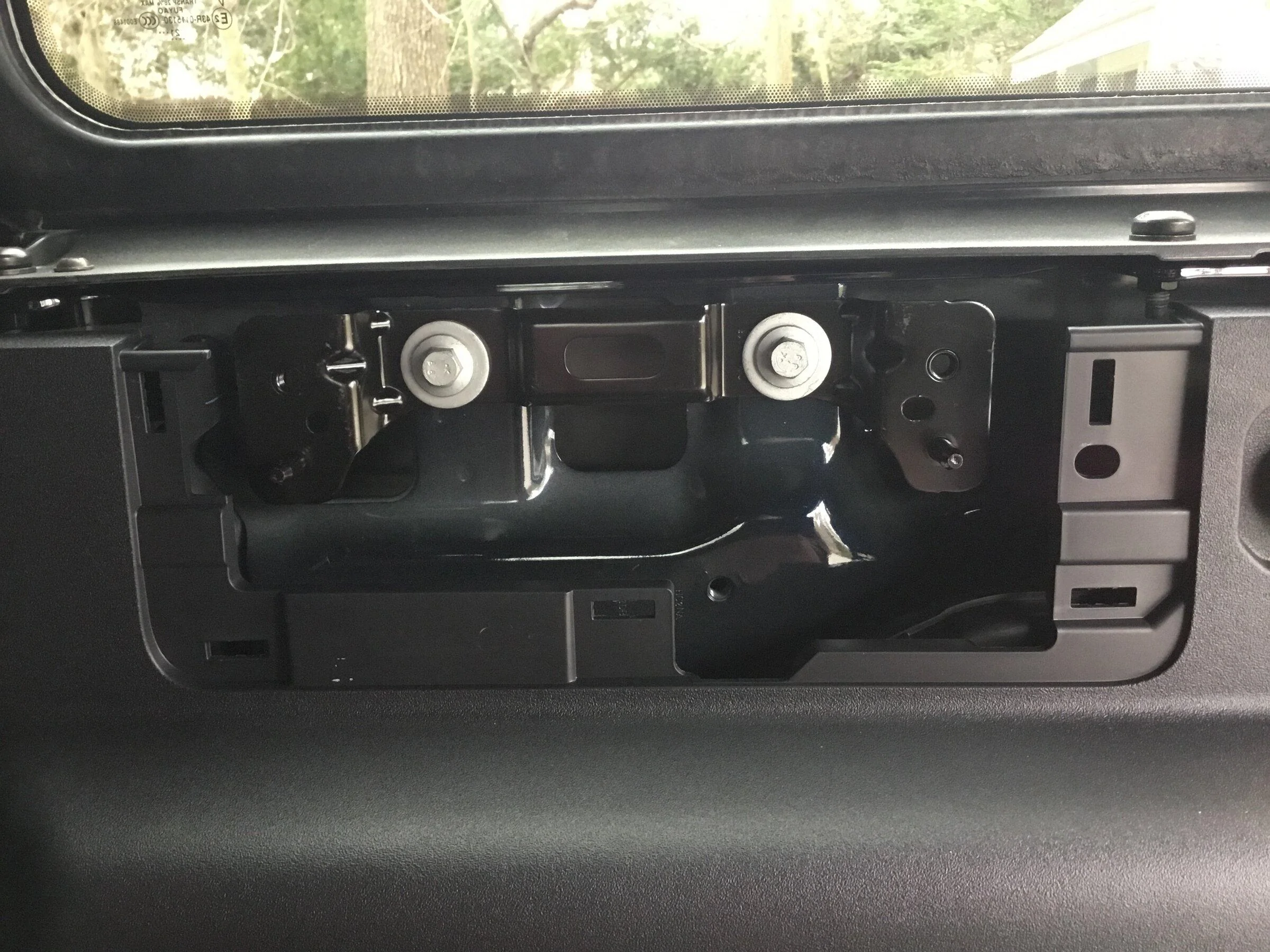

Bracket installed
Rear cargo panel with cutout for softtop, Right Side
Does anyone have the part number for the Rear cargo panel with cutout for softtop, on the left side ?
Also, the bracket & bolts in above post, are they the same for left & right sides? 4 total bolts needed?

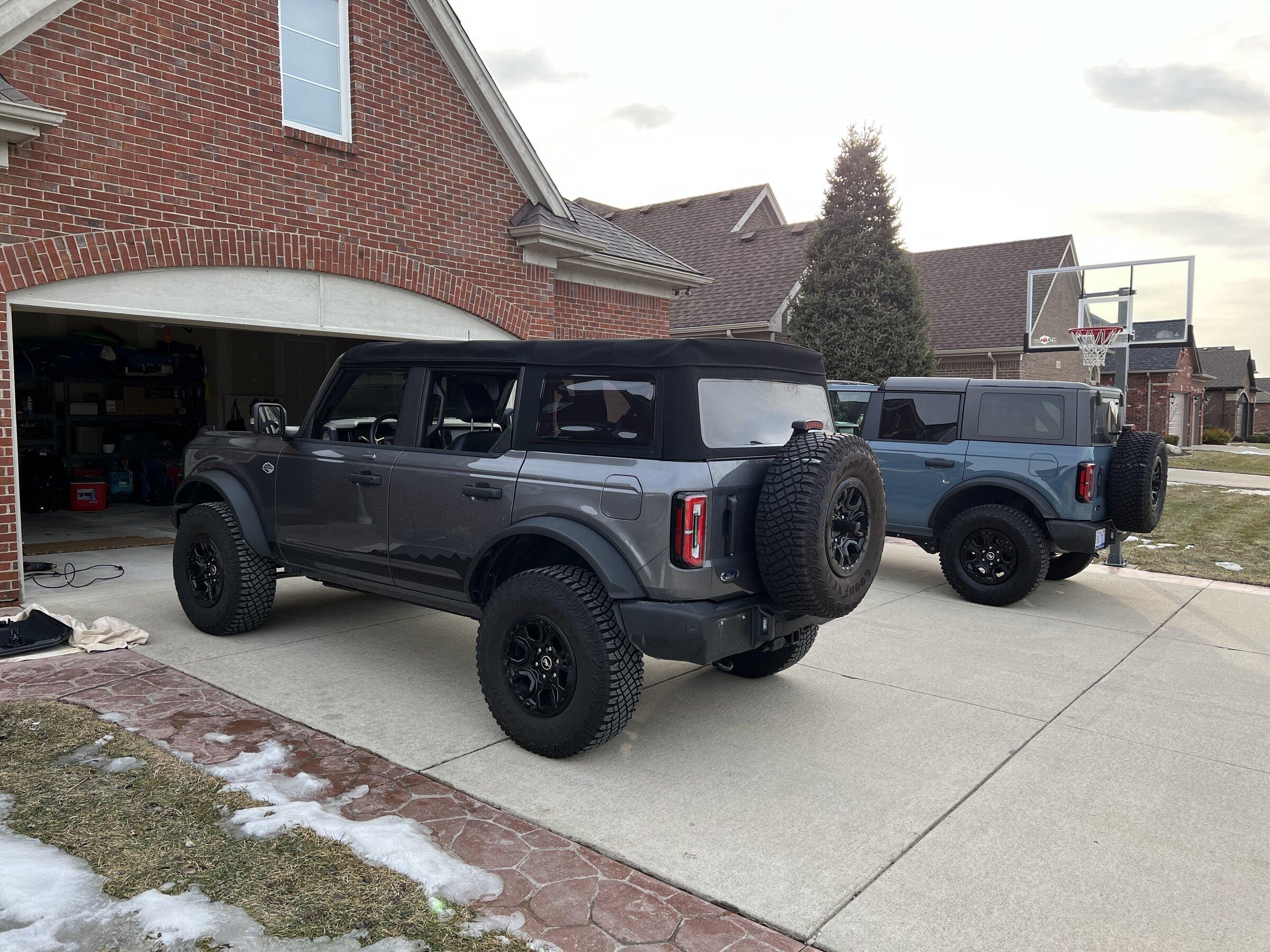

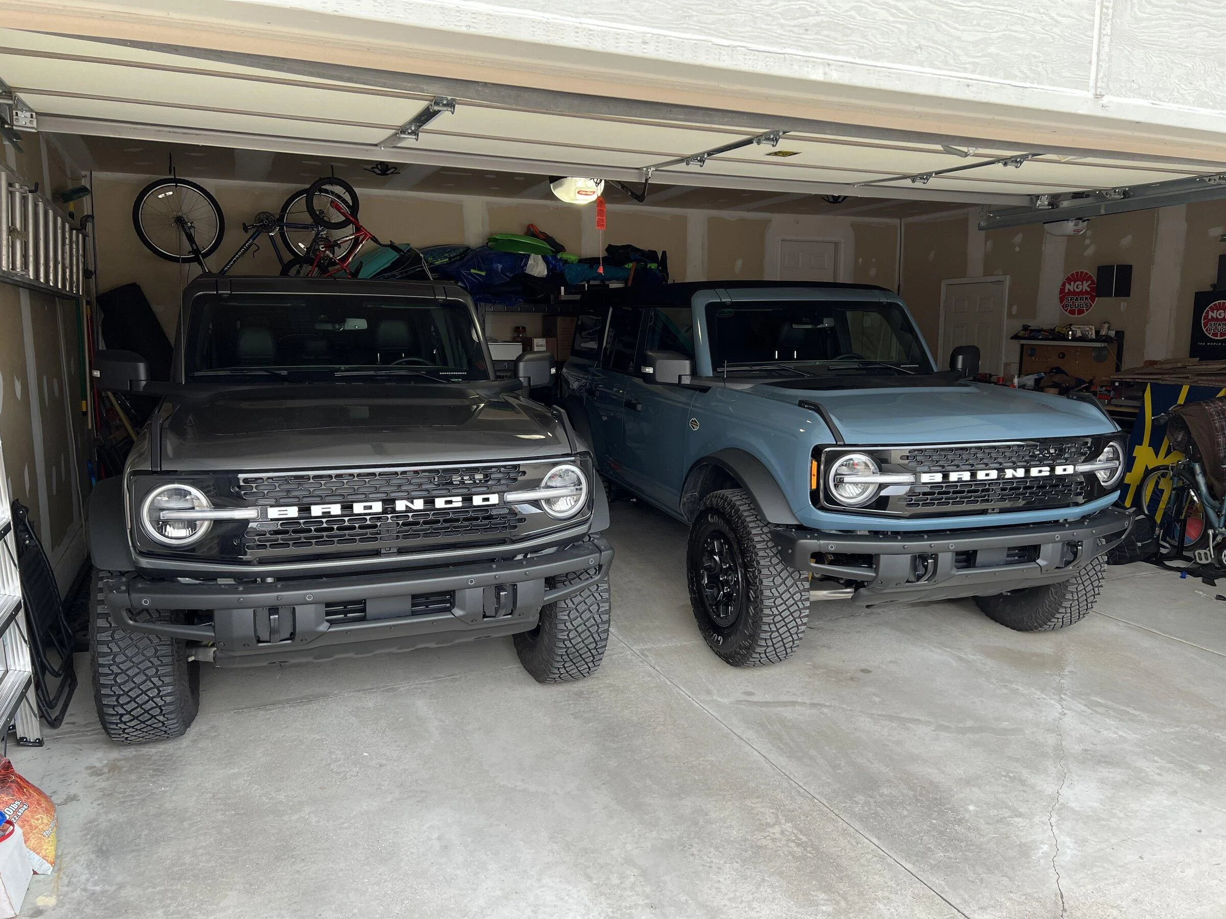

Great write up! I’ve got a 2-door coming with dual tops (accessory soft top). Picking it up on Friday so we’ll see what it comes with.

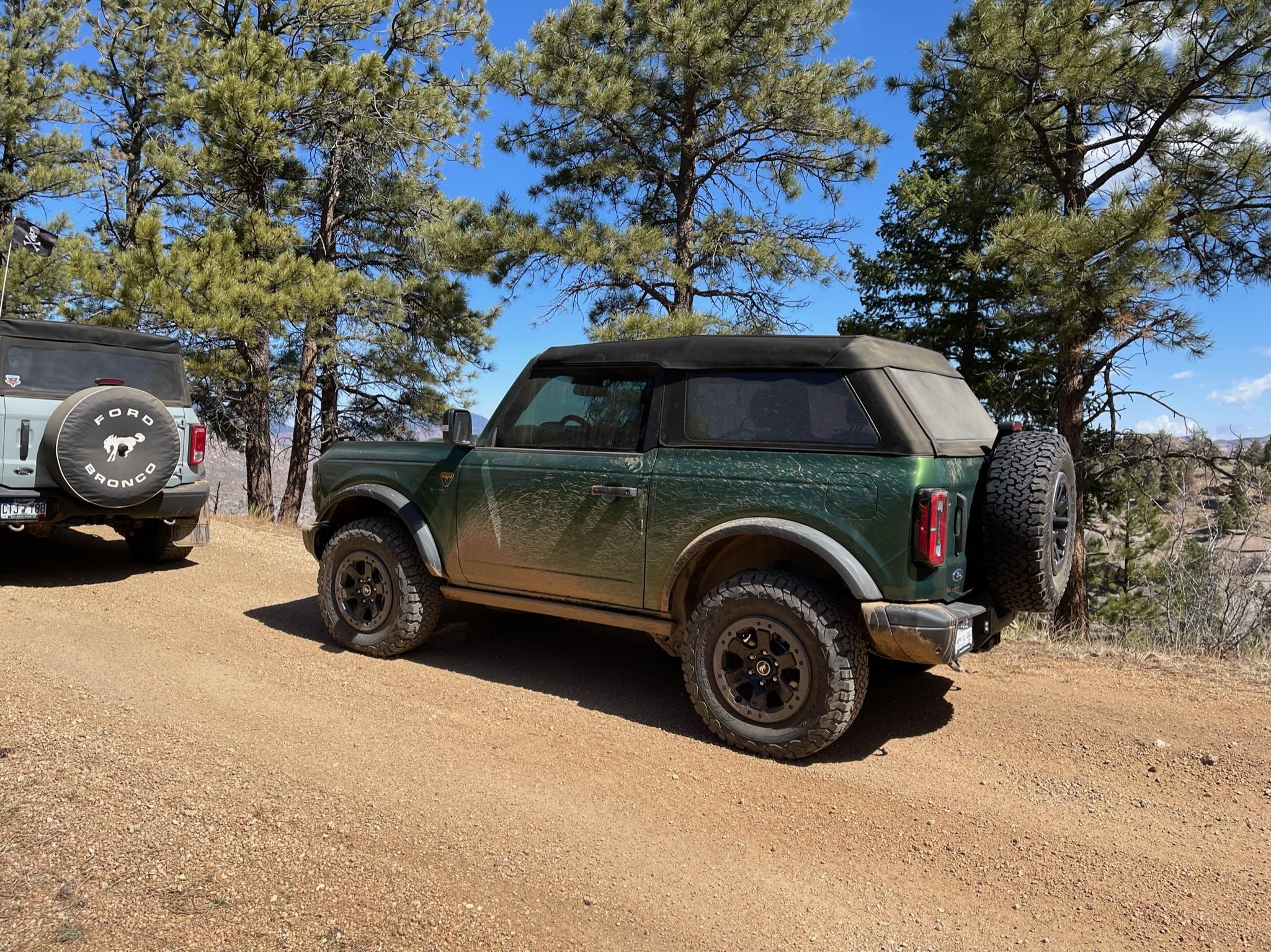

I am researching going from HT to ST to HT etc. I saw your ordered the same as me. I just got my Bronco last week. The HT was already on. The ST was in a million pieces stuffed behind the front seats😖 Right now the ST is stashed in the garage. So it’s been a year for you now. I’m curious to know what you ended up doing? After seeing all the ST parts it seems a bit overwhelming for me to assemble and install.
The top took about 3 hours to completely install. There are a bunch of brackets and I wanted to make absolutely sure everything was right.
We ran it all last summer and while we really liked it, we ultimately decided to sell the top. The Bronco is my wife’s daily driver. The soft top had a bit more wind noise and it did make the cabin a bit hotter when it was hot and a bit colder when it was cold. Also, my wife wants to be able to carry her kayak with ease. The hard top just fit what we wanted better. Also, if it wasn’t kayak season during the same time as soft top season, we would have kept the top.

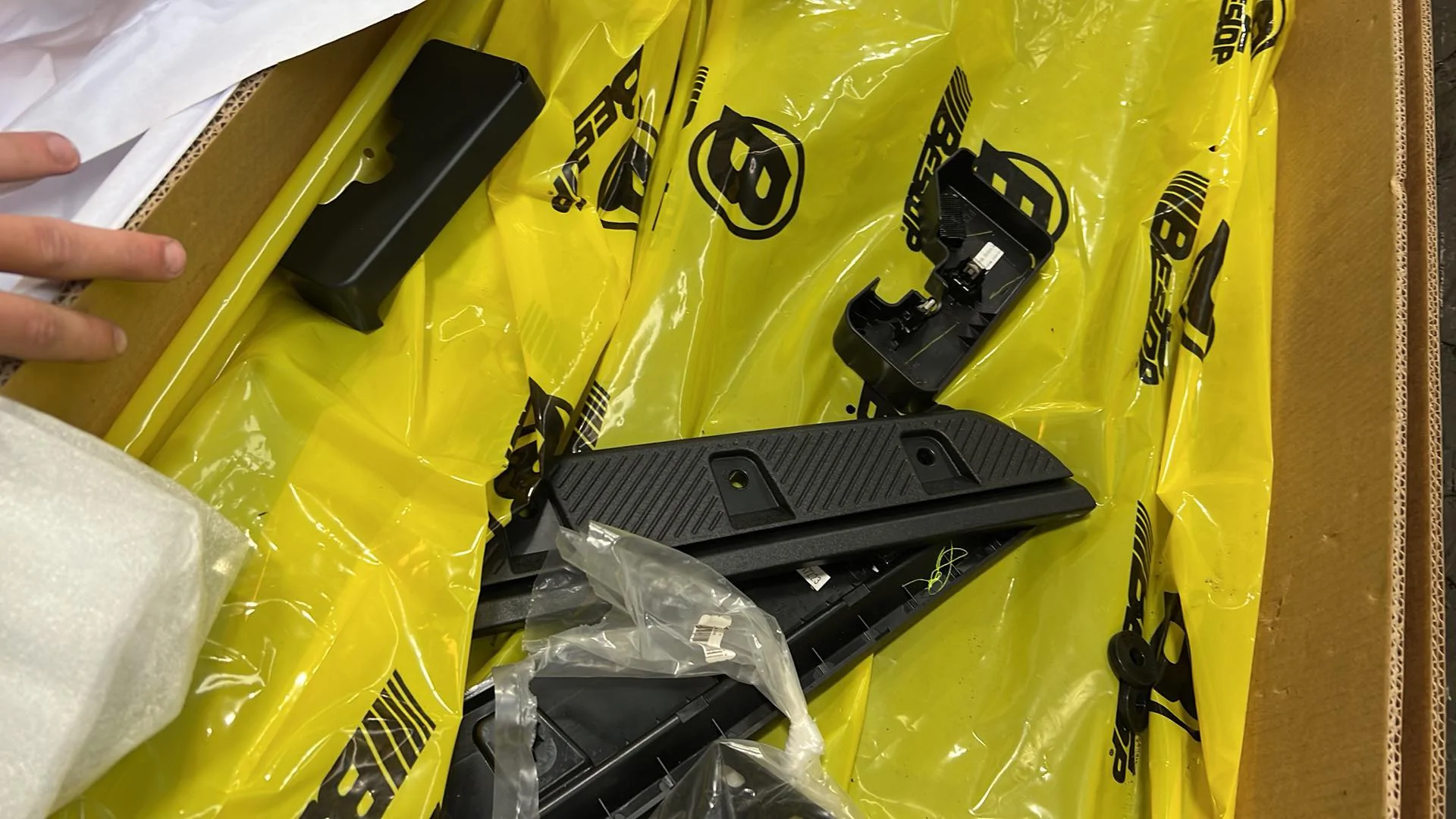

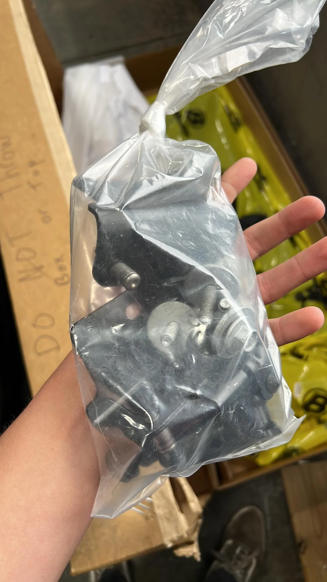

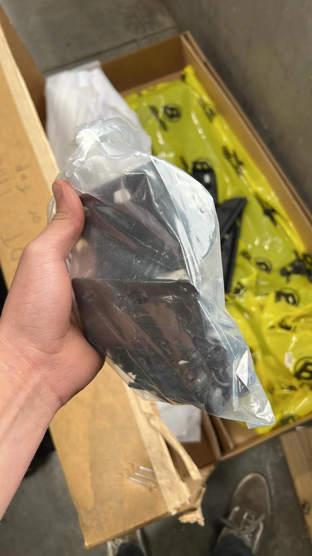

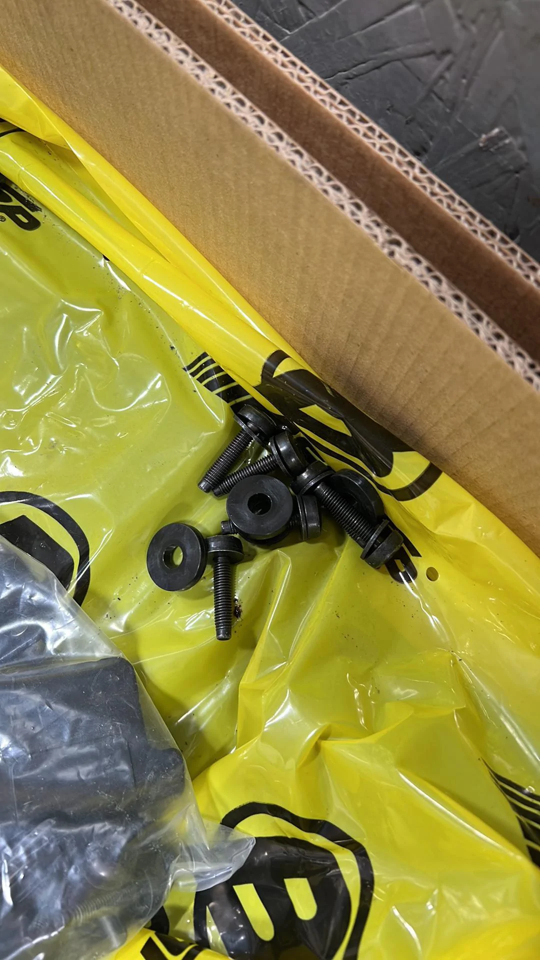

Do you know the part numbers for the Rear Cargo Access Panel Covers ?
I am planning on buying a soft top from a guy that swapped his OEM soft top for the Bestop one. Does the Bestop soft top use any of the Ford parts? He attached these pics, I am just trying to make sure I have all the parts.
