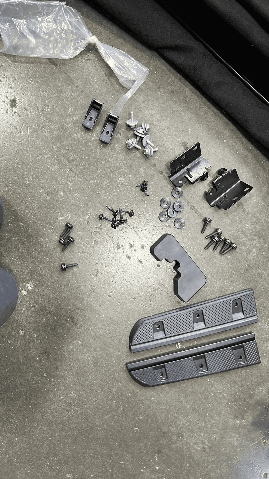

Update:
Here is a more detailed photo. I believe the only thing I am missing are those rear cargo support brackets that the soft top actually bolts on to, correct?

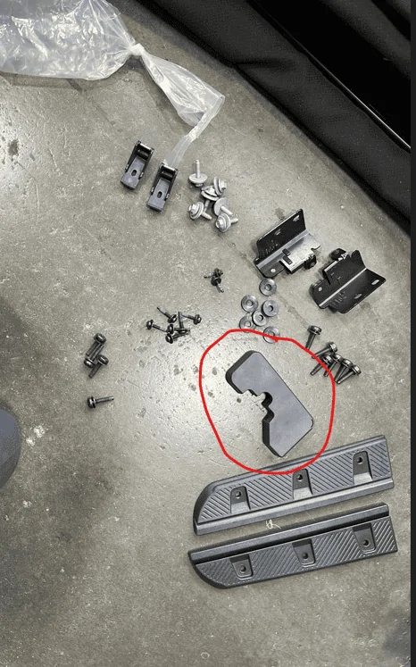

Also, he did say there is another one of the plastic pieces circled in red below. What exactly is this piece for? This plastic trim piece (I assume its the cargo cover piece?) looks different than the photos that you all uploaded.

It looks like everything is there but those black bars and bolts. The circled plastic piece looks like the trim for the fastener by the sun visors. I would think that you’d already have those installed.

Am I missing the read cargo panel covers as well though? Arent those different for the soft top?

If yours was strictly a hardtop, then yes. They are aesthetic only. Some have trimmed their hardtop versions. I ordered new softop for mine. Some even just leave them off. It’s up to you and your level of OCD.

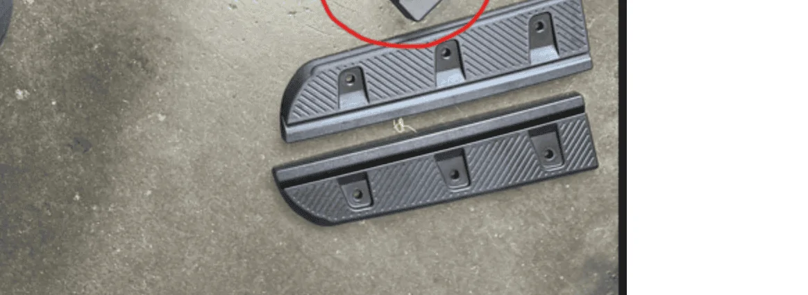

For these pillar trim pieces, could I use the existing screws that are there or do I need new ones? My trim pieces came with no screws.

Use existing.
