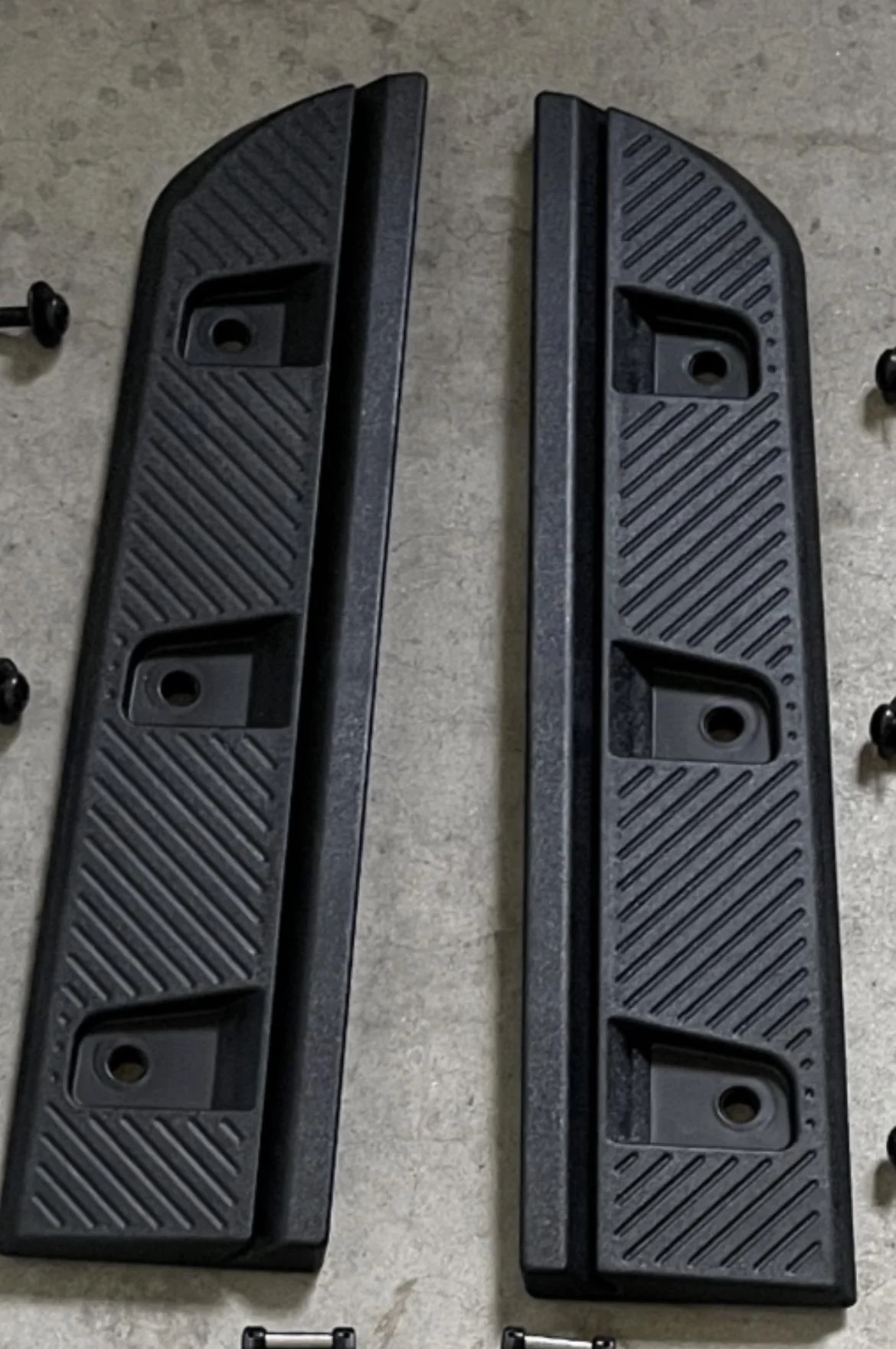

Rear Cargo Access Panel Covers:
The final step in the process was to reinstall the rear cargo access panels. When trying to reinstall the panels on the hard top donor, we could not get the panels to fit properly. That is when we noticed the panels are different between the models.
Notice the relief cuts on the bottom covers from the soft top:
The relief area is required for the soft top frame:
Top bracket location (sorry no pic if the bracket itself):
Any chance you have the part numbers for the rear cargo access panel covers with the cutout for the soft top? Also looking for the part number for the top bracket for bolting on the soft top. Thanks, great writeup.

But hard toppers don’t get a soft top prep kit — oof
If you bought a soft top it would be easy enough for the kit to include those pieces needed. The Bestop offering does this for example.

@Catmandu great write up.
Any chance you might have taken a note of the PNs for the soft top side panels?
